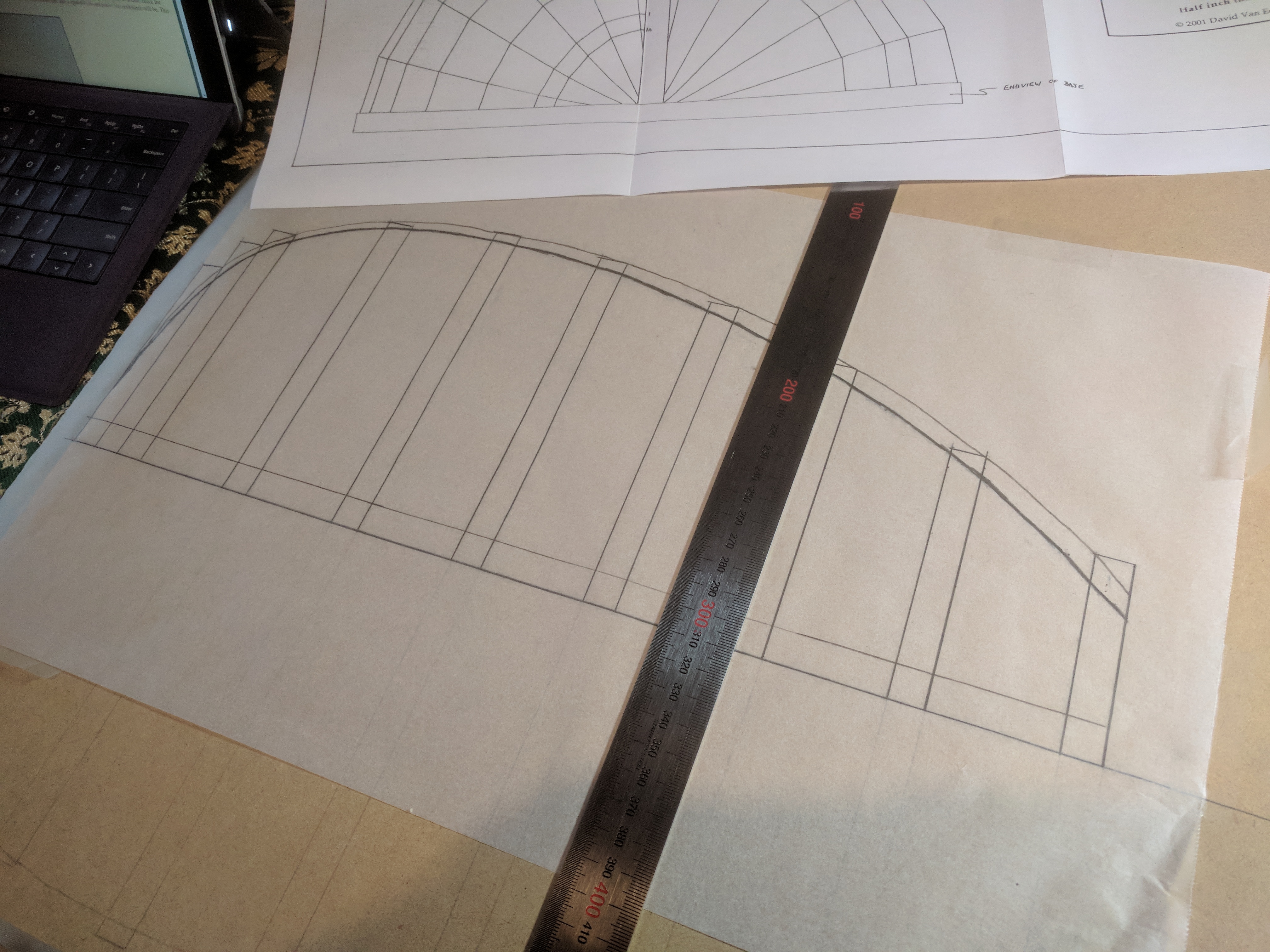

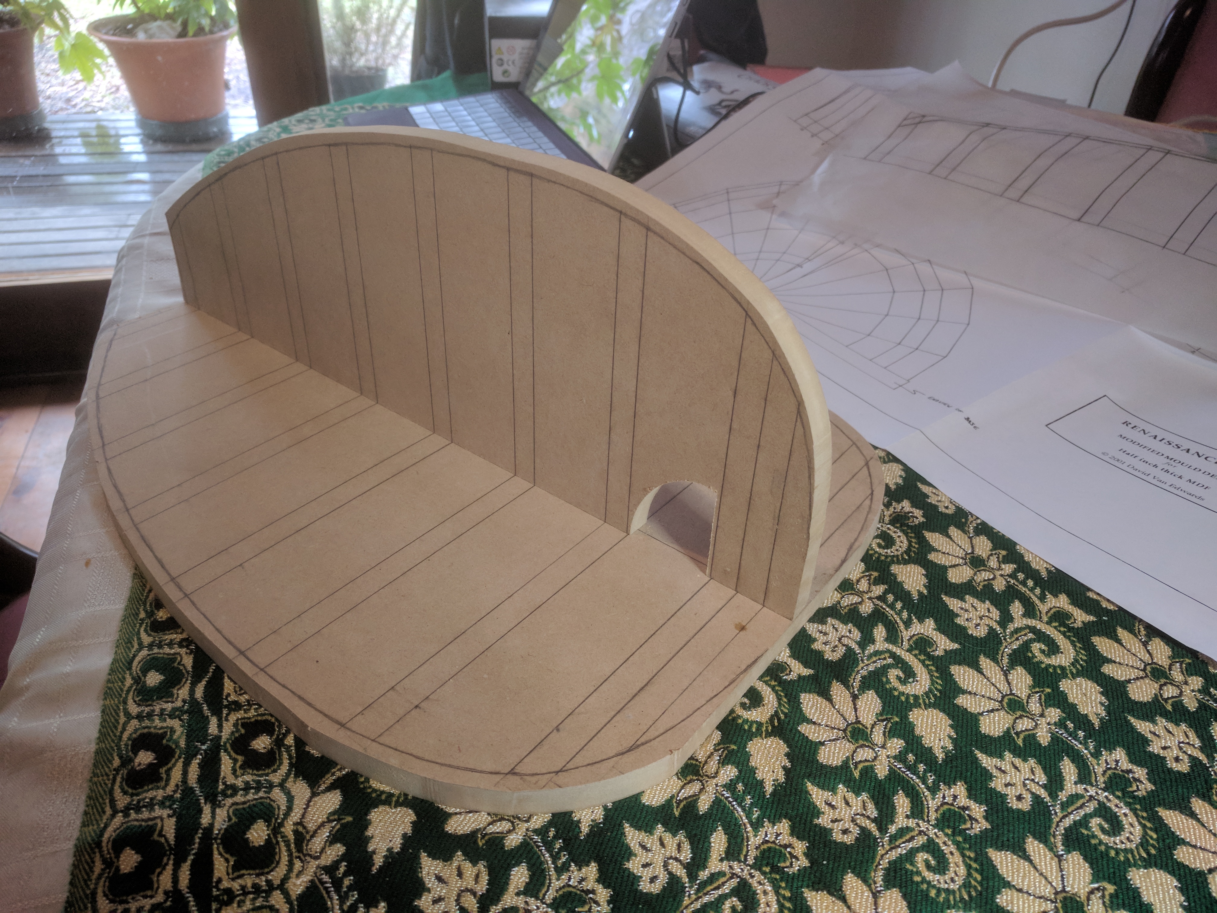

The lute I'm attempting is the six/seven course lute in David Van Edwards Rennaisance Lute course. Today, I started transferring the plans to MDF and building the mould.

1. While you're still at the mold building stage.....it's really important that you get the mold as accurate as possible, doing so will make laying up the ribs go a whole lot more smoothly.
I'm 100% with you on this. I even used a laser level on my kayak to get everything lined up right.
