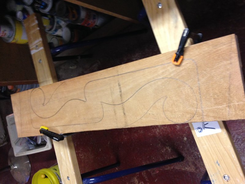

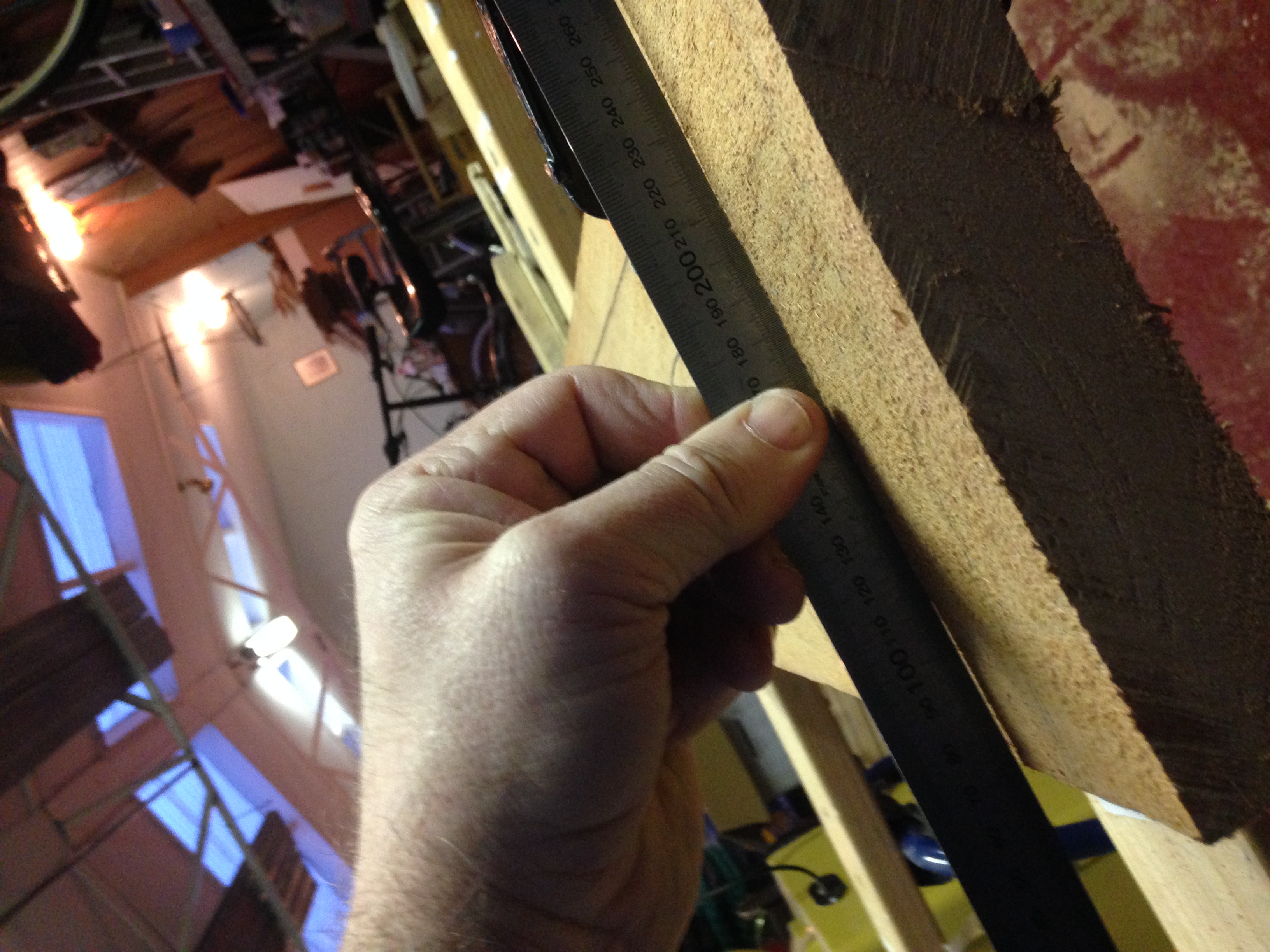

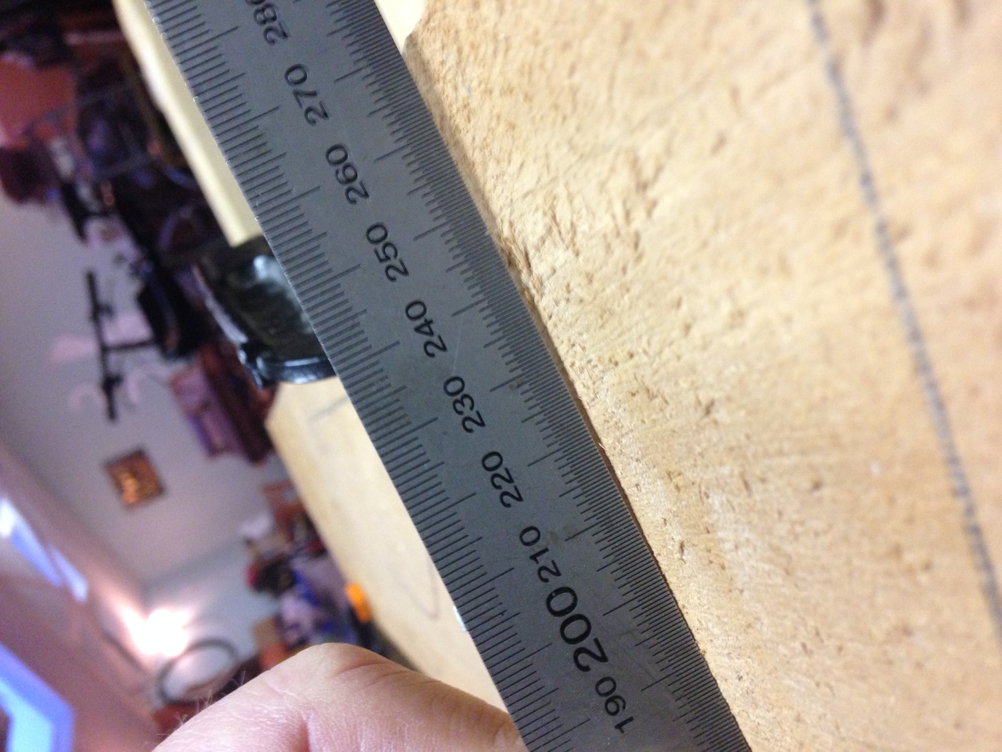

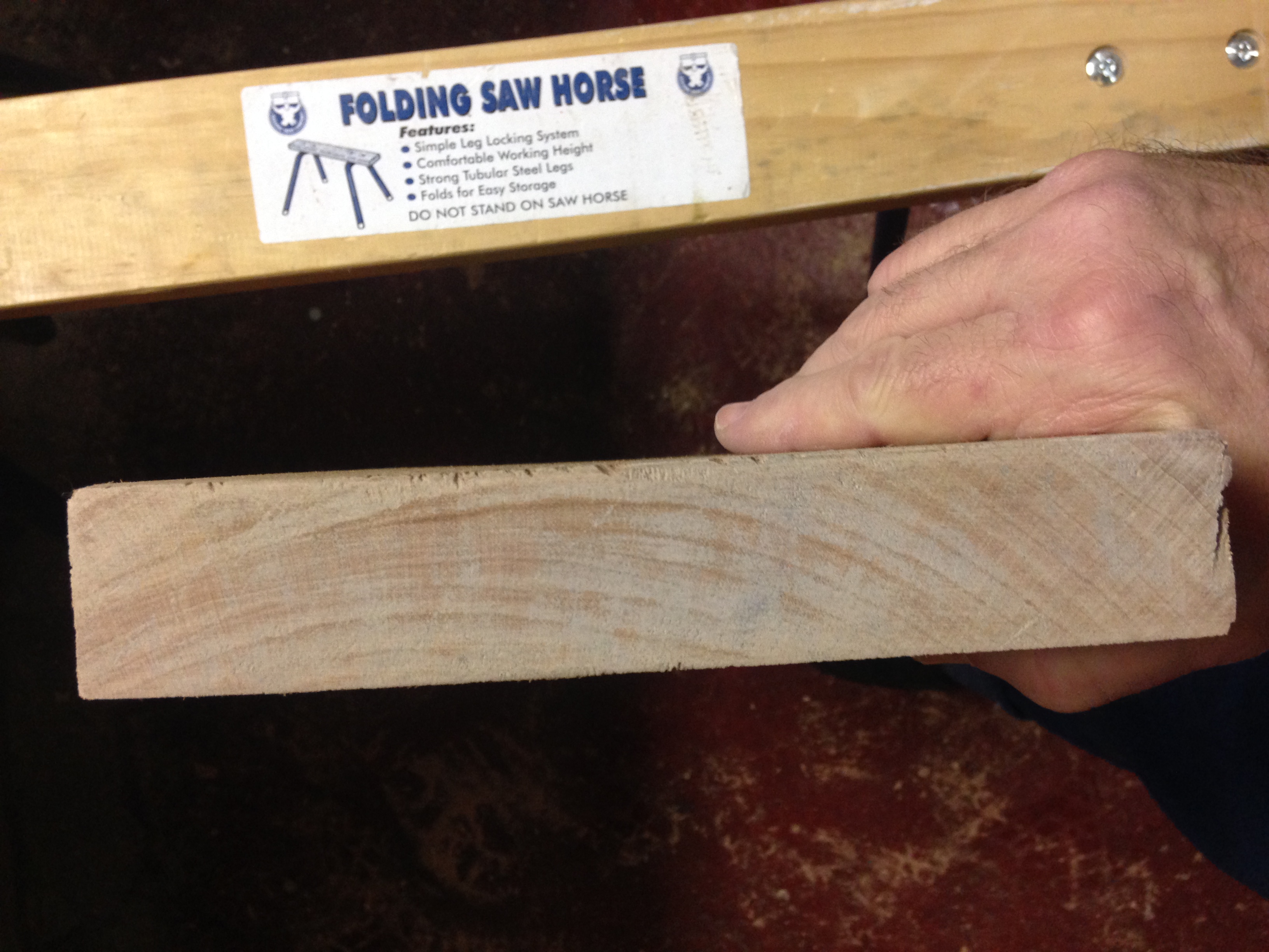

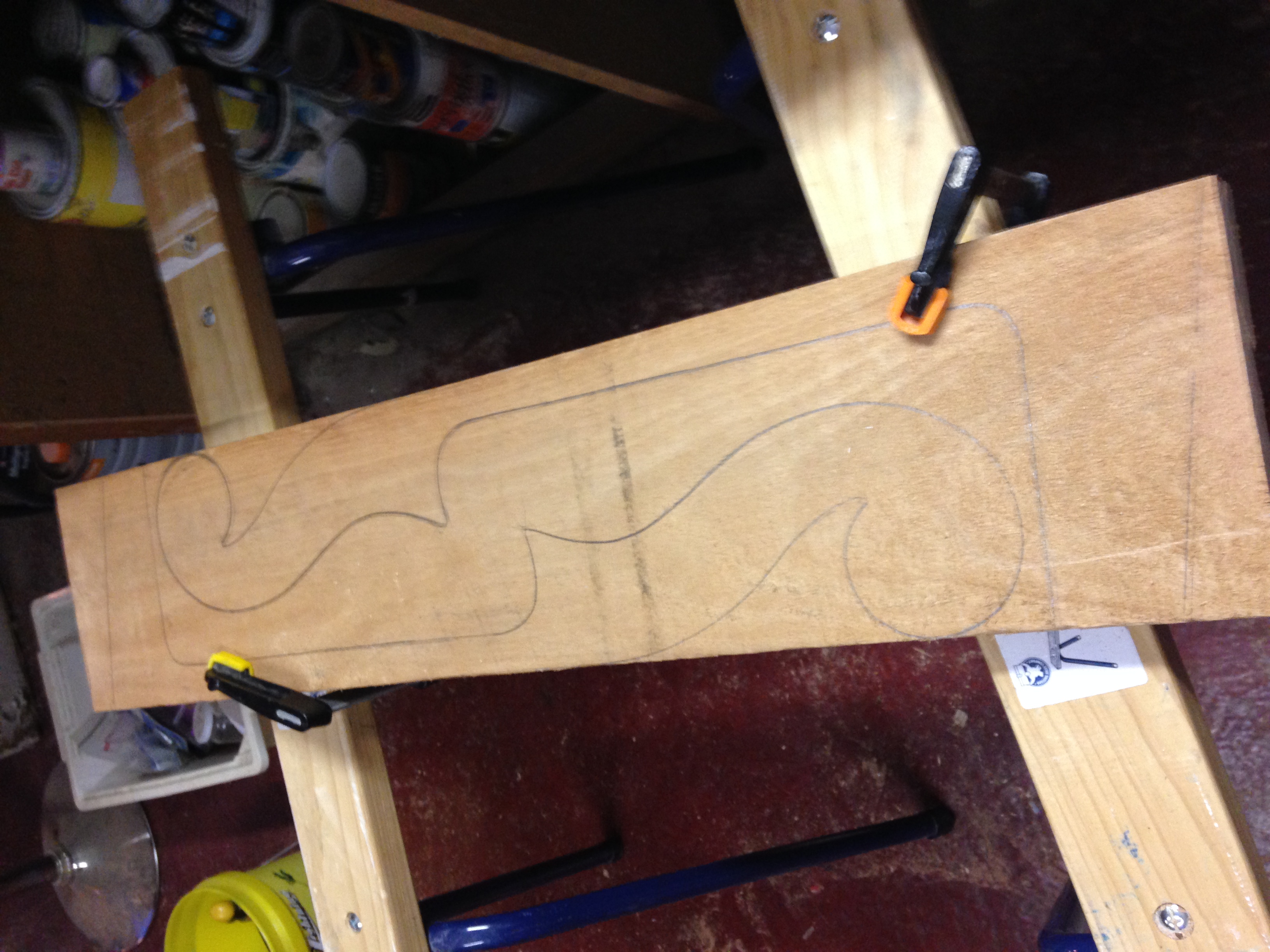

Amateur builder looking for advice. :D I've just discovered that the Queensland Maple board I was planning on laminating for a double bass neck has some cupping. Do I plane it flat and use it, or rack it up as part of the learning curve, put it aside and look for another piece of wood for the neck?

I've just made up a bunch of queensland maple steel string necks. None of the blanks were perfectly flat but a bit of work with a plane and they were soon good. Make up some winding sticks and get a bit of practise using same and then get busy with a plane and make some shavings :D

Hard to tell from the photos but it looks like it's flat sawn and a bit thicker than inch board. I assume you're ripping it and turning the pieces to make the grain closer to the quarter for the neck you mentioned.
I think you'll find that if you rip the pieces as the board is now, the cupping will be very little, then dress the individual pieces for lamination. I wouldn't thickness the piece as it is as it's just waste.

Thanks Allan, Yes the board is back sawn and 37mm thick. I wasn't planning on ripping, rather I was just going to cut two pieces from it and glue them together to get a thickness of around 65-70mm initially (I may have to glue extra to make up the ears of the scroll). So I'm aiming to get closer to 'quarter', but won't really get to full quartersawn.

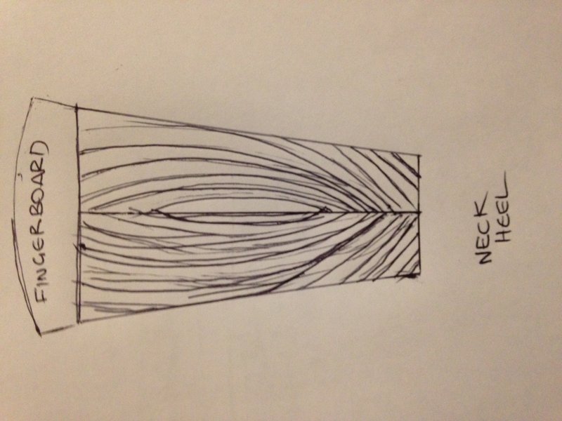

Can you dress the timber to get rid of any wind and cupping and still have the thickness you need? It appears that you need only dress and true one side of the board to get the join, then work the finished neck blank after that. Hand tools tell us more about the wood and the grain than power tools as we work...listening is an art... A centre strip will take care of thin material anyway...I would have the tendency for this job to put some nice contrasting veneers either side of the centre strip. You could ebonise some maple or other dense wood to make veneers. (vinegar and steel wool) Can you post a better image of the end grain please? (Dressed without saw marks)

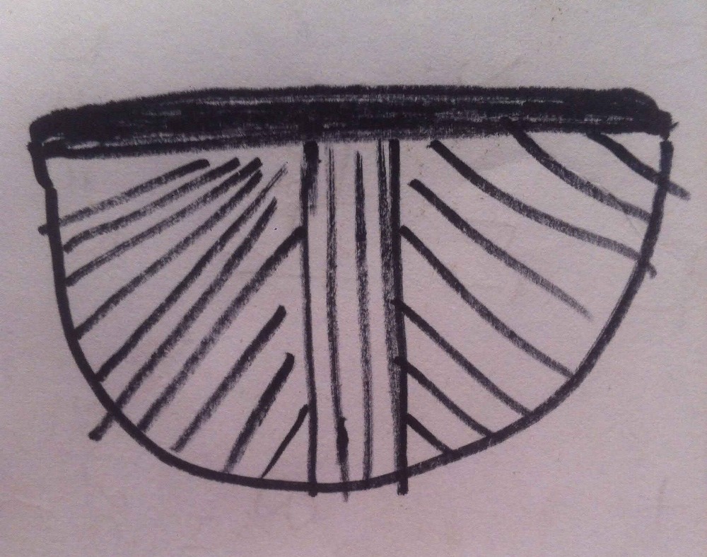

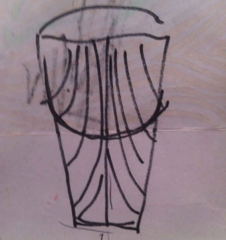

My rough sketch shows a way of getting neck stability with quarter the sawn on the outside of the finished neck, the pencil lines indicate wood grain. Are you monitoring/contolling the Relative Humidity for this build?
You probably know a lot of the things people will tell you on this site, but it just occurred to me to make the following point. Always work to a centre line when building, for both body and neck. cheers! Ross

Thanks Ross, I appreciate your feedback. I think I can dress one side of the timber flat to get rid of the cupping and retain enough thickness. The plan is indeed to only dress one side of the board, then cut and join. If I need to I'll add a centre veneer of blackwood or another wood. Thanks for the idea of contrasting veneers, that might be another possibility too. Epiphone used to do this on the necks of some of their plywood double basses.

Here is another offering...maybe surface the other face so that you get what I have tried to sketch..the heel will be as in the drawing, the neck profile will be closer to end grain all round after shaping.

Thanks for the info on Relative humidity, Ross, I'll get reading. Thanks also for the sketch. Good point about the endgrain and neck profile. Cheers.

Just had a look at my double bass here....the grain goes at roughly a 45 degree angle in the neck. Ii is European maple so a pretty stable timber. Just remember, I'm not a double bass builder....but from my experience, there are a lot of bull fiddles out there which have a repair where the neck has broken off at the top of the heel - always in the same place. I have repaired a couple myself over the years. A laminated two or three piece neck would help strength wise there in my opinion.

That would be a nice strong neck

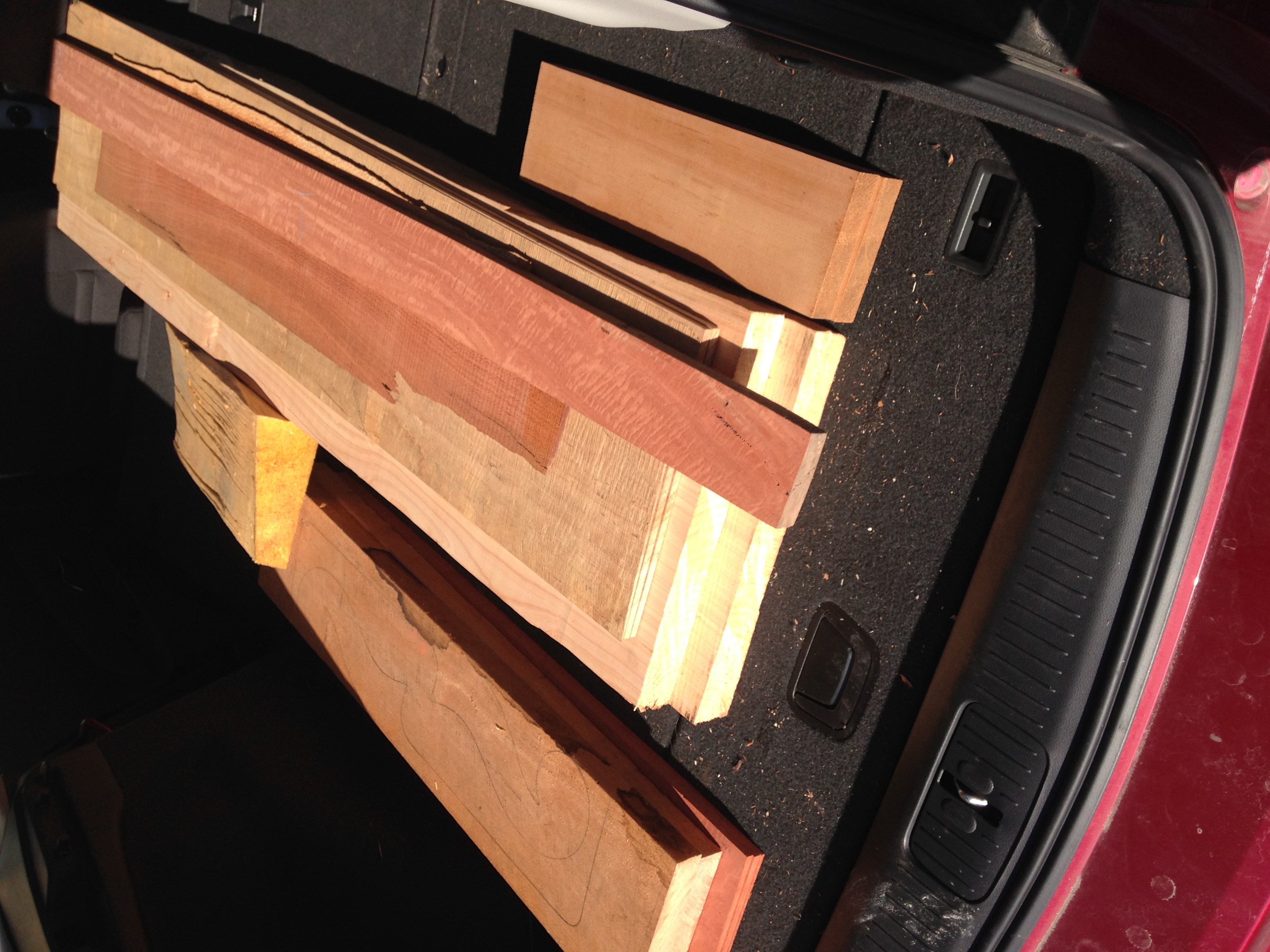

G'day Michael . Bring the board up when you come to get the other bits . I can buzz it flat no worries , no cost . It'll take about 20 seconds on the big barker buzzer !

Thanks Curly Pete for flattening that Queensland Maple board for me today. Also for supplying the rest of the timbers for my bass build.

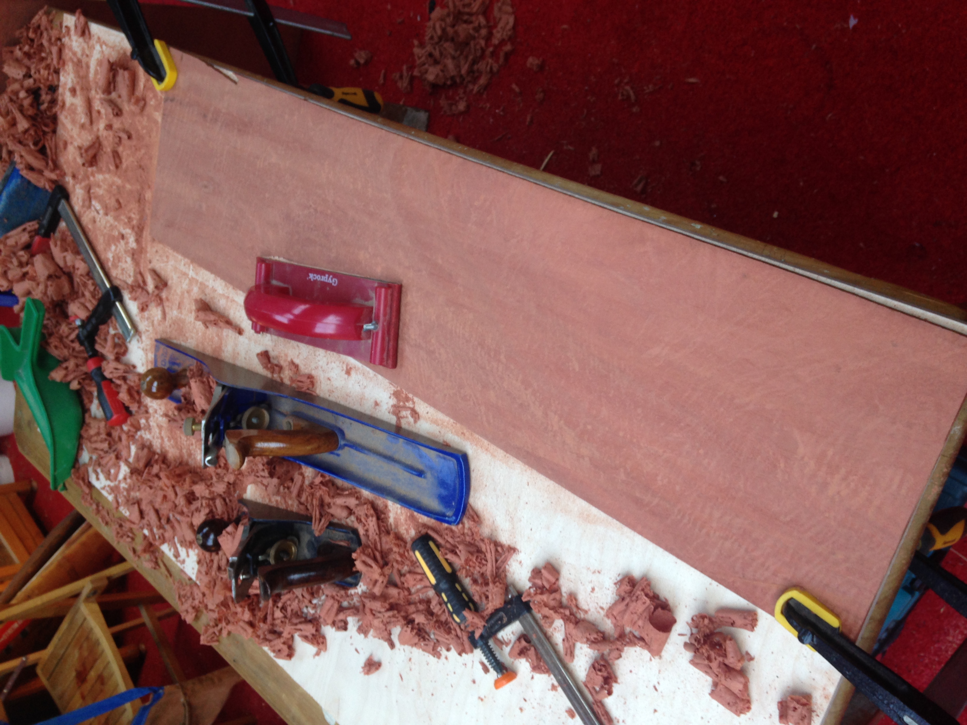

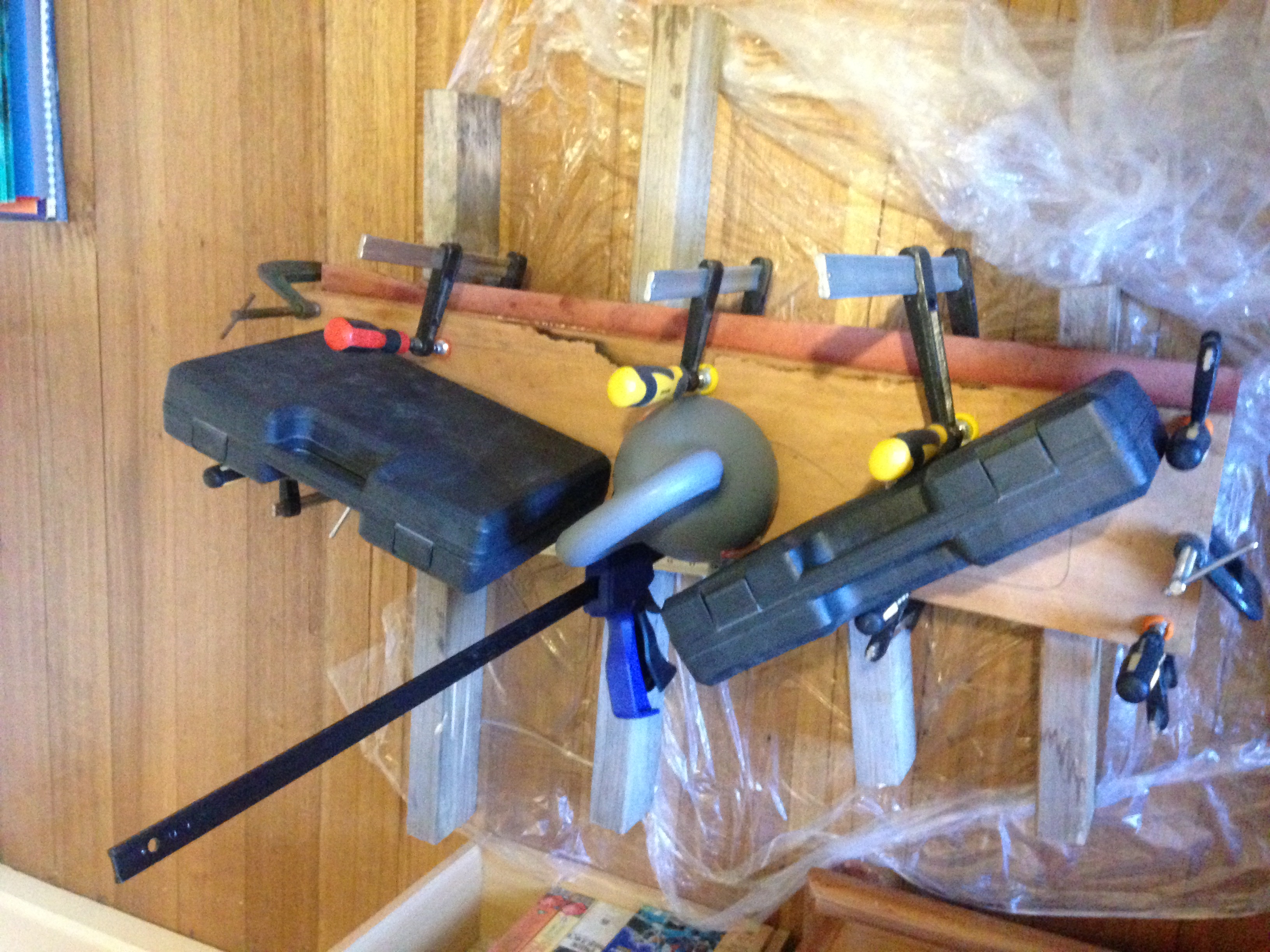

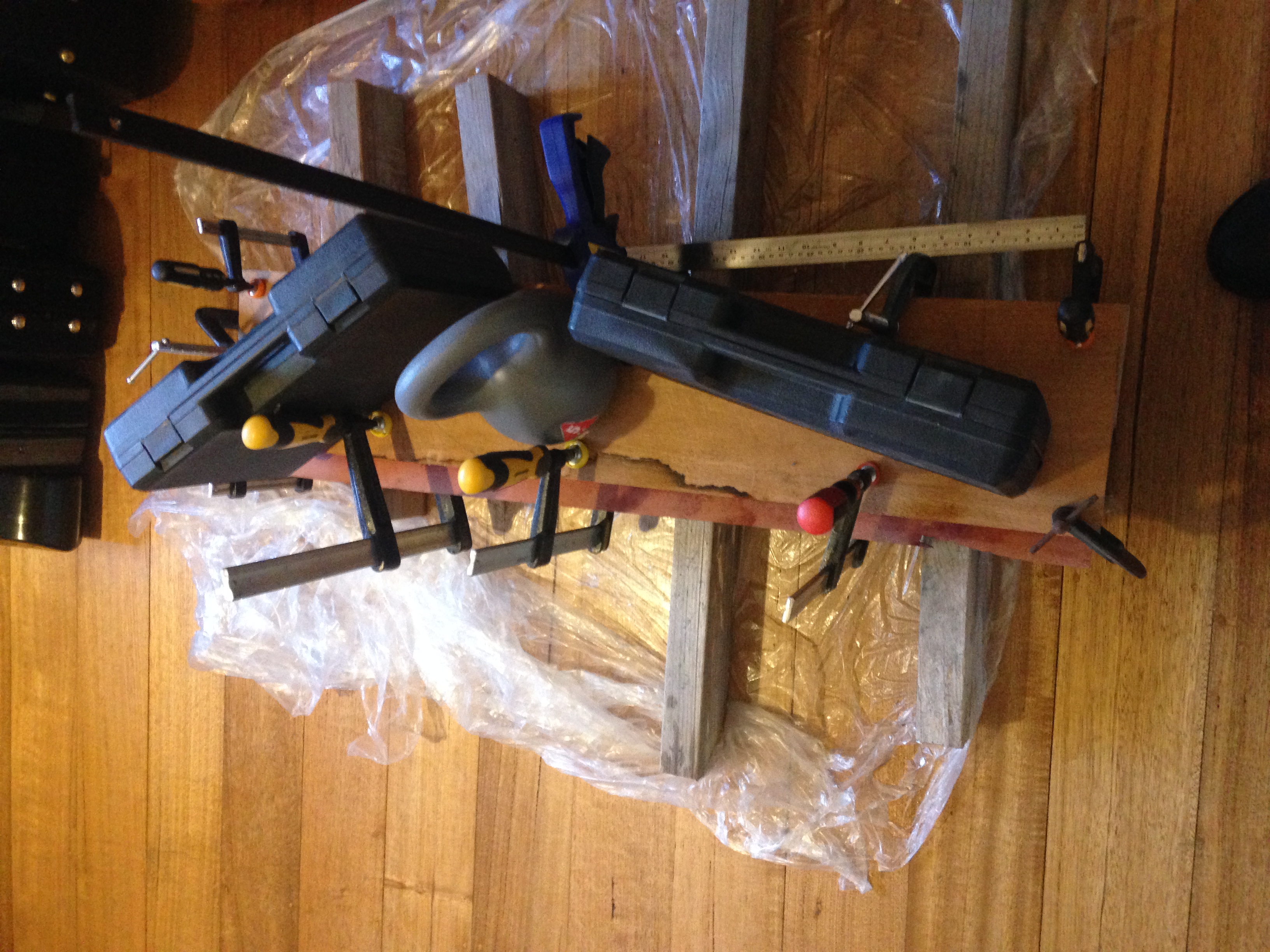

I went with redgum. Tricky to plane and dress, but not as bad as I thought it would be. Needed a fair bit of sanding though. Anyway the boards are glued. 😀
