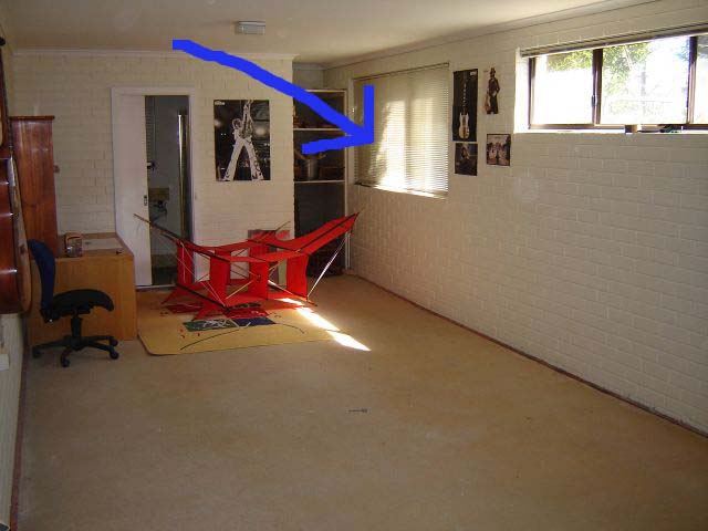

Well, I've been freezing half to death in my workshop this winter which is in one half of the underhouse garage. Gets hot in summer as well. My car has been freezing outside which means iced up windows every morning.
And all the time I have had this huge 10mx4m room plus a bathroom at the end which I hardly used. I was calling it my music room and had all my amps and stuff there but tended to play upstairs anyway.
Now here is my space. Its got much better natural light than the garage. I should have done this a couple of years ago.
So I have ripped out the crappy old carpet and am going to start making cabinets and benches and drawers and stuff and set it up well. I'll put doors on all the cupboards and try to minimise places where dust can settle and keep it tidy. Get it wired up properly and proper lighting and dust extraction etc. I've always wanted a proper woodworking shop so I can tackle anything. Should be good, I'll keep you informed of progress.

Ever tried finding a 1/8" drill bit youve just dropped on the carpet?
Others will probablly disagree but a hard floor is a better idea in a workshop..its a bit easier to keep clean as well. I left my concrete floor as is with a few small mats for standing on.
Looks like a nice big area youve got there....keep us updated with progress pics.

Great looking shop space Dom! You will not regret having a bathroom close at hand too........
Although I have had carpeted shops my next shop is going to have a concrete floor in the main work room by choice. It should be way easier to keep clean and I won't have to stress over dripping HHG on it like I did in my last shop.
Great looking space and the windows are cool too.

Nice blank canvas you've got there. :lol:
It's great to see the potential a space such as yours has.
Too many options really as far as set out goes as I see it, which is a great thing.
I've got to say that I look forward to seeing you fill that space with
space-saving storage and a steady supply of different things that inspire
you to be within this area to build.
Let's face it, if you can't make that room inspire you to build, then I'm happy to swap with ya . :D

I'll just put down some rubber mats along the benches to stand on. Easier on your feet/legs, easy to clean and better if you drop an edge tool.

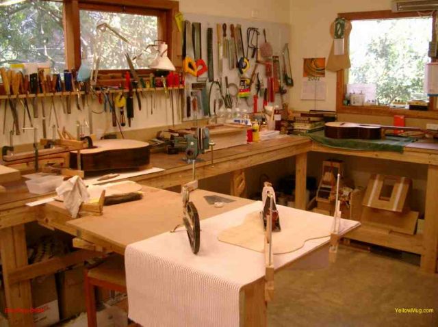

A pic of my humble shop in case you see any useful ideas. The island workbench is a Spanish idea. It can be detached form the main bench work to make more space. Benchtops have 3mm masonite nailed on. When the masonite gets chewed up or grubby I just replace it rather than having to replace the whole benchtop (MDF).
Cheers Martin

I agree with Martin , an island bench ,or a bench in the middle of the shop is very handy. I'll bet you've already thought of it , but keeping your dust making objects in a common area is good thinking also.

G'day Dom
That low window really took my eye.
A low bench in front of that window would be great for sanding, carving necks, checking finishes for gaps etc.
The natural light is perfect for this sort of stuff. We've got one in our shed and I don't know what I'd do without it.

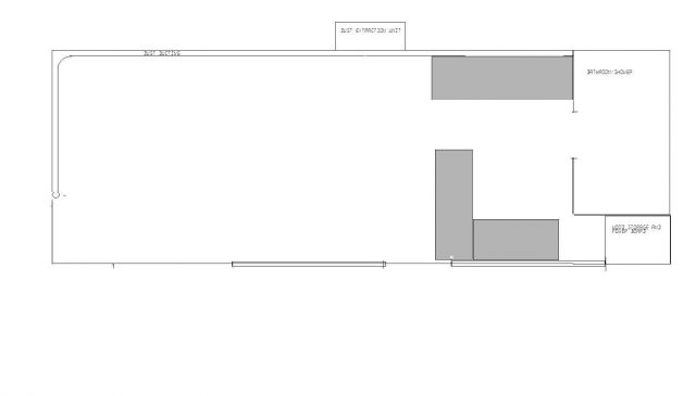

Bob, I've had a few days off work and been drawing all over the floor with chalk working out where to put things. My actual building benches will be at that end of the room under the window. The design of the room is bit silly because the window goes into the alcove there a bit (this is my wood stash, a bit hard to see in the pic). So a bench can't go all the way along the window because I need to be able to get past it to the cupboard. All the machines will be along the the wall opposite the window and down the other end. The table saw will be in the middle of the room.
or like this
Any thoughts on the merits of the two benches? A big central table vs the L shaped one against the window?
I am thinking I could have a couple of shower curtains or something to divide the space and try to keep the building end dust free when I am really making a mess.

I like the L shaped bench Dom.
I think shower curtains would be like a "fart in the wind" trying to keep dust out.
We really struggle with this even though most of our machinery is hooked up to a dust extractor. Next buy is going to be an ambient dust filter.
I'd really like two rooms. One assembly room - and one for the machinery that makes all the dust.

Yeh I'm inclined to go for the wrap around L bench. I want to put a cupboard attached to the ceiling all the way around above the bench so I can put stuff in it (no, really) but also use the underside to support go-bars. So anywhere on the bench can be a go bar deck.
You could be right Bob about dividing the room with curtains (although I'm not at all certain why based on your fart test; farts in the wind can be some of the most effective if the snipper/ripper wishes to avoid detection). I have thought about getting some sliding glass doors from the salvage yard to make two rooms. If I could get the right set for the right price.
But I'll also get a room air filter for sure. The CarbaTec one for my sized room and smaller is about 420 bucks. I also think I'll make a down draft sanding table that's connected to my dust extraction system.
And I am in no rush so i have time to think it through. So I will keep bouncing ideas around.
