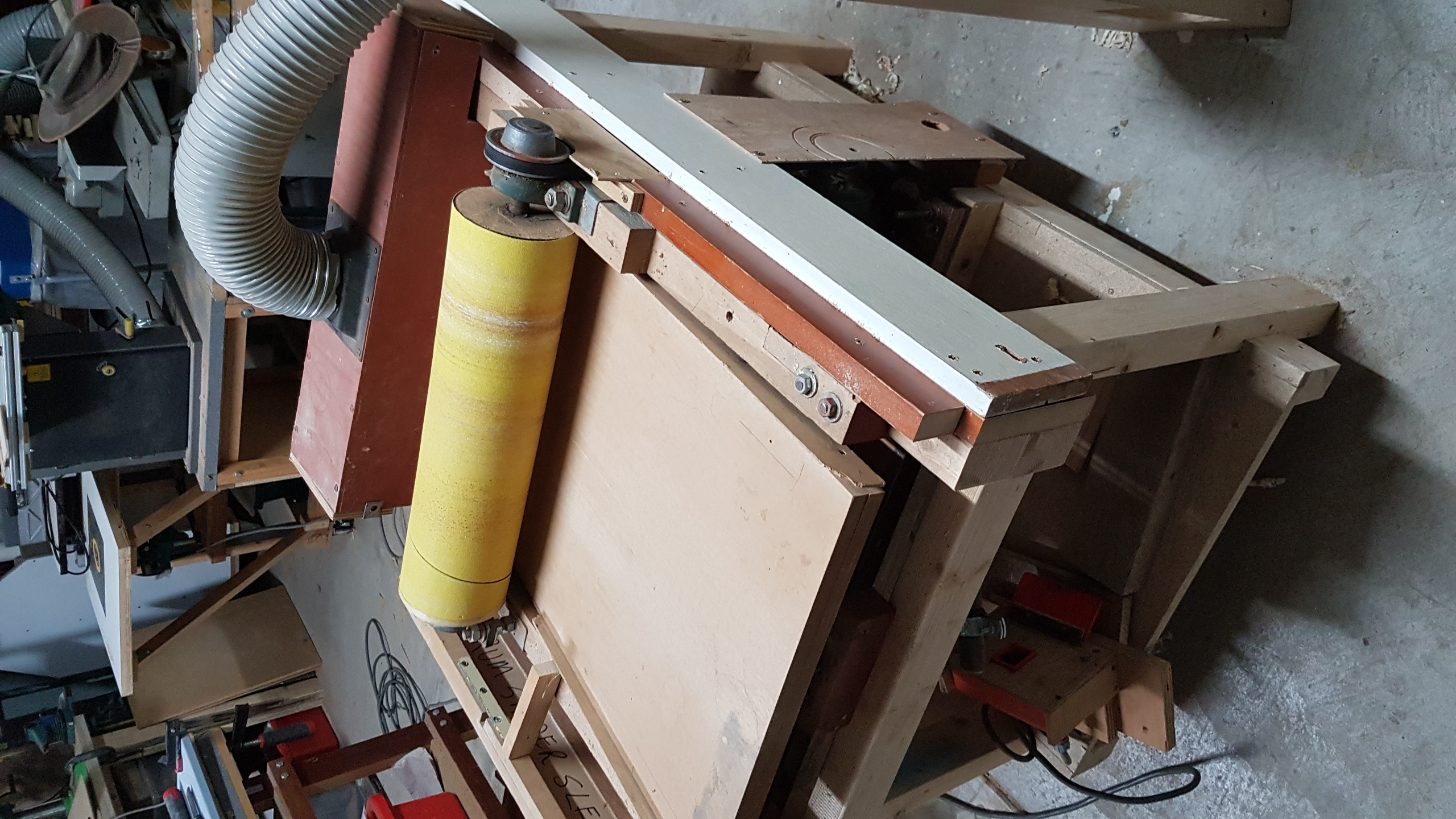

My homebuilt works well. I used this web page as a guide: http://www.krtwood.com/ww/sander2/index.html The only substantial change I made is to use spiral velcro and velcro sand paper instead of the slot and wedge concept in the article. It was pretty easy to build, certainly easier than coming up with the $1000+ for a decent commercial unit, most of which I keep reading disappointing things about. Mine is manual feed and for guitar size pieces I use a backing board with a handle and a plate backstop. By paying attention to a steady feed rate and not taking too big a bite at once, I get very acceptable results.
