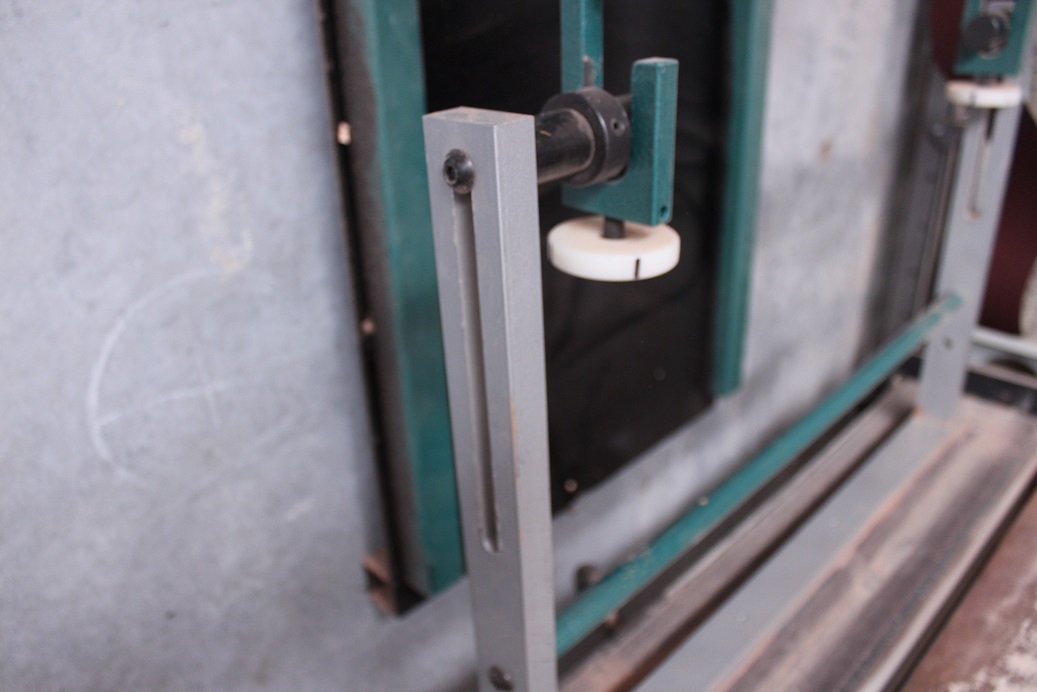

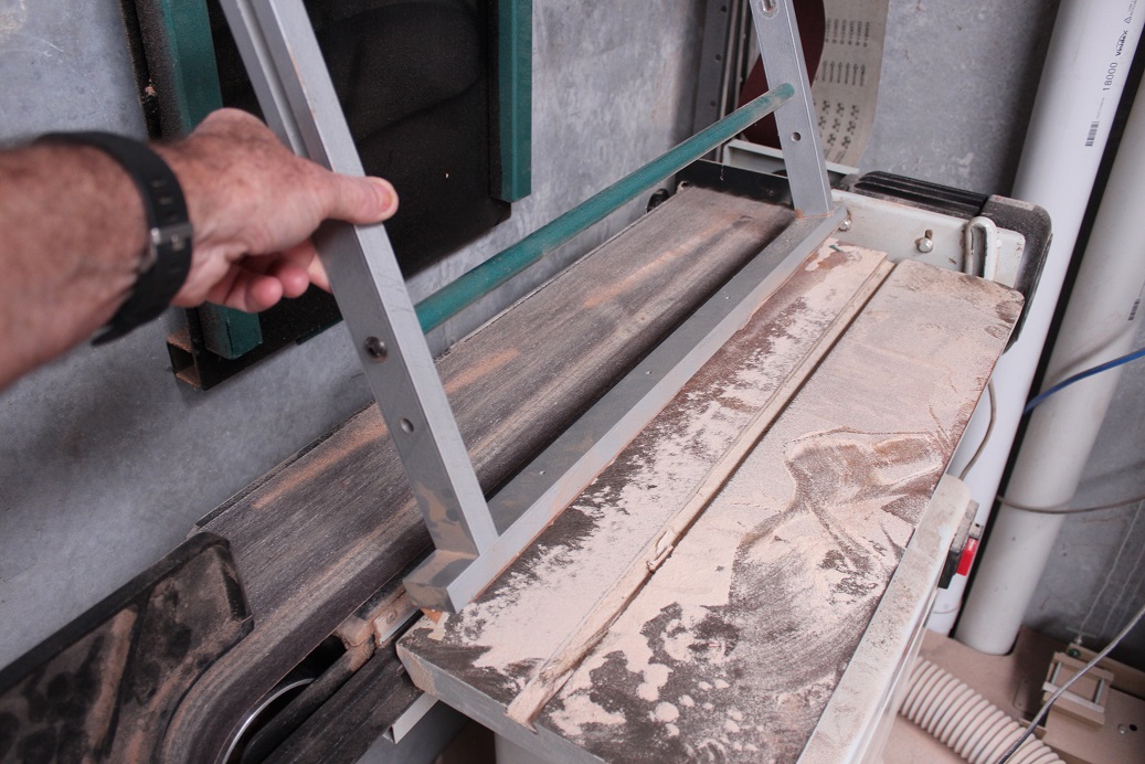

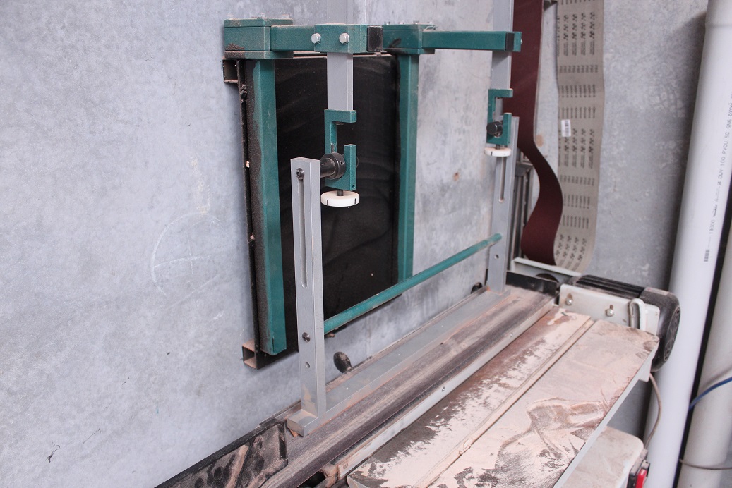

I have a swing arm over my belt sander that allows each end of. Afretboard to be sanded to a different radii or the same, can take photos if you want
Re: Compound radius/conical fretboard advice
Post by lamanoditrento » Fri Apr 28, 2017 7:55 am
simso wrote:I have a swing arm over my belt sander that allows each end of. Afretboard to be sanded to a different radii or the same, can take photos if you want
That would be great thanks Steve

Post by simso » Fri Apr 28, 2017 12:20 pm
Over top of belt sander
Pivots
Adjustable arcs

Thanks Steve, well put together jig! Unfortunately I will have to wait until I have long enough linisher before I could have a go at that.

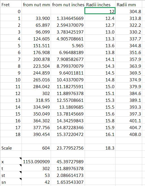

This vid https://www.youtube.com/watch?v=I2QAWZ-5uL0 gave me the idea that I need a map of the graduation, so using the the stewmac fret calculator and radius formulas http://www.stewmac.com/How-To/Online_Re ... ained.html , I made a spreadsheet to map the radii on this fretboard for any given radius at the nut so I know when to transition to another radius block.
Compound Radii.JPG (91.68 KiB) Viewed 12963 times
Of course now I have got that straight in my head, I'm thinking how on earth am I going to bend and increasing radius in the fretwire...

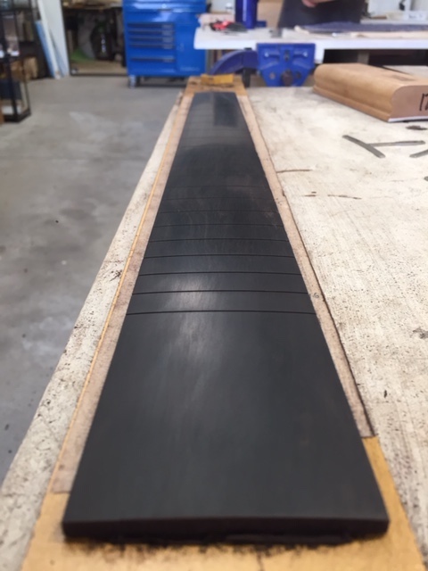

Post by lamanoditrento » Mon May 01, 2017 8:26 pm
Hmmm so I might have been over thinking this is bit. It turned out to no where near as difficult as I thought it was going to be
Post by simso » Mon May 01, 2017 10:31 pm
Always the way isn't it, we dilly dally and think and think and sometimes it's just a case of do it.
Looks good
