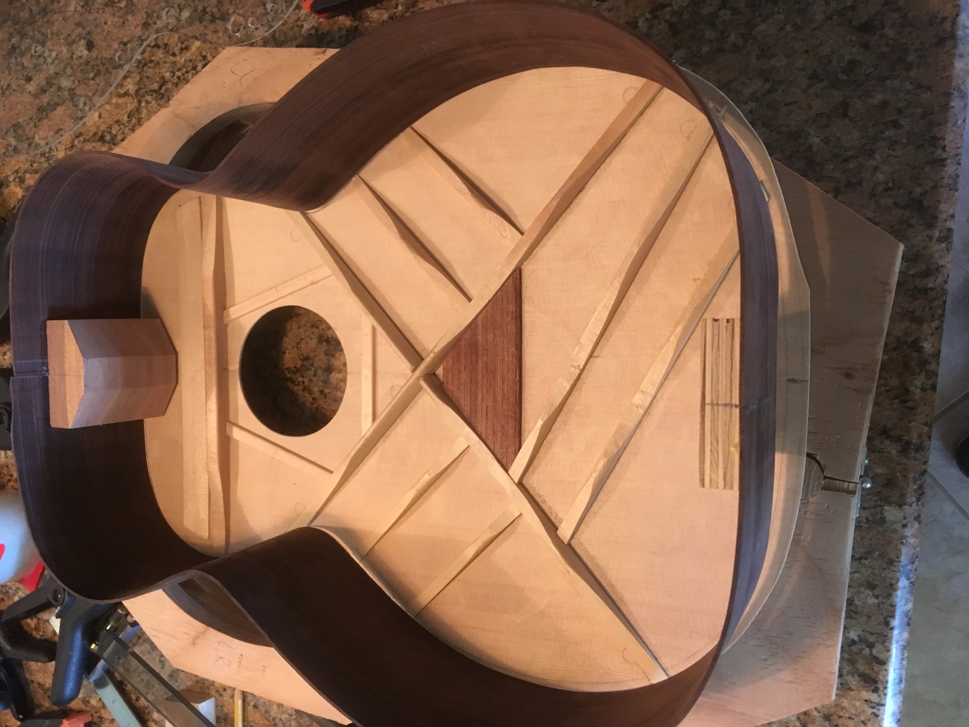

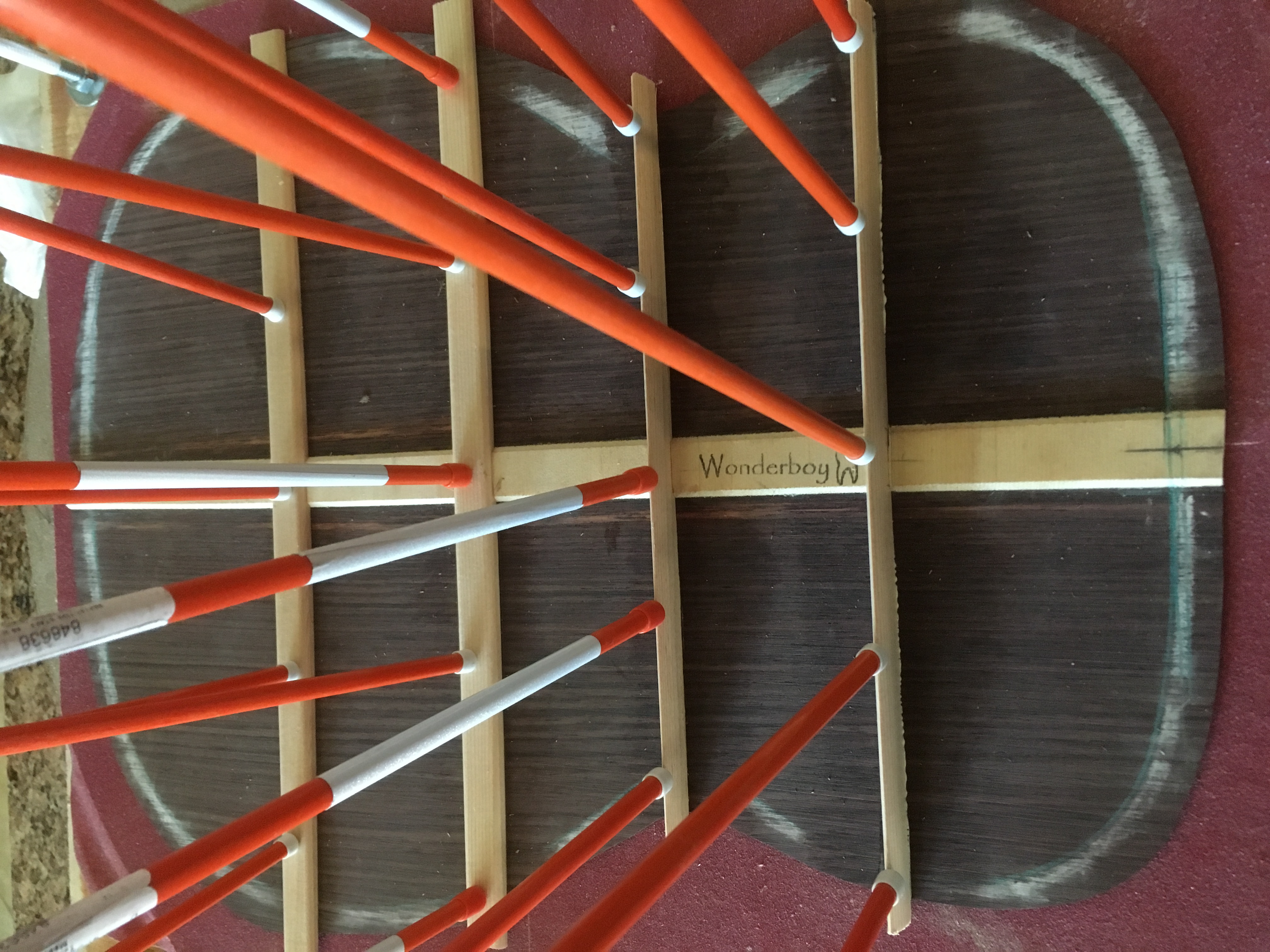

It’s been a while. Thought I’d post update photos for anyone interested.
Sides bent with neck and tail block glued.
Top and back are braced with baces rough shaped. Waiting for the Humidity to drop more before closing up the box.
Thanks to all of you for your support and knowledge.

Looks good mate! My tips...calibrate the RH metre at the RH you want it to be the most accurate at. If you need to raise RH quickly in your wotrkshop, I suggest a second hand portable evaporative air conditioner.
A leather apron is a wise investment for a bending iron operator. Try the iron both vertically and horizontally and see which way works best for you. The leather apron will prevent the problem I had..I was wearing a jacket with a nylon zipper on it. Bending away, I was getting warm, but when I went to remove the jacket the heat iron had welded the zipper closed...
The thickness of the sides relative to the species and figure in the wood all affect bending. The bending iron temperature is also something to experiment with. Some woods need to be boiled first, some soaked..I'd guess in a dry climate, there would be minimum natural moisture in the timbers, so soaking doesn't hurt at all.
One last thing comes to mind. Make sure you get the area being bent thoroughly warmed through on the flat part of the iron, then move along to execute the bend on the curved section.

Hi Matt, it's a little hard to tell from the photo but it looks like the lower bout and finger braces are going to be under the linings, I might be wrong. They're usually left short of the linings. It's looking good for a first guitar. Wayne

I actually have the evaporative cooler, but rarely use it for some reason. I learned the hard way about the bending iron when I noticed some threads on my shorts had melted after using it one time.
You are right about the braces being too long. I cut them all long and rough shaped them with the guitar outline drawn on, but knowing my guitar body wasn't likely to be the exact shape of the outline, I decided to leave everything long so I could shave them all back to the proper length right before closing up the box.
Thanks again for all your support and input! Hoping to close the box soon (in the next week or two). Summer humidity has finally gone away and we're getting close to the sweet spot for me to close this up.
