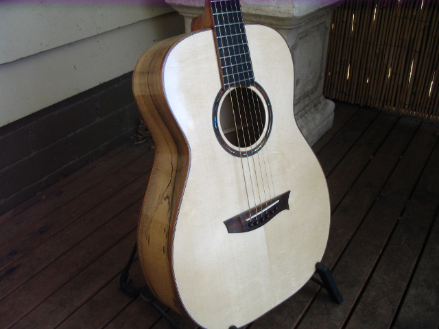

I built this Sassafras and Engelmann 0-18 14 fret about 5 years ago.
Sounded nice and balanced with none of the symptoms previously described.
I'd be looking elsewhere for reasons other than wood combinations.

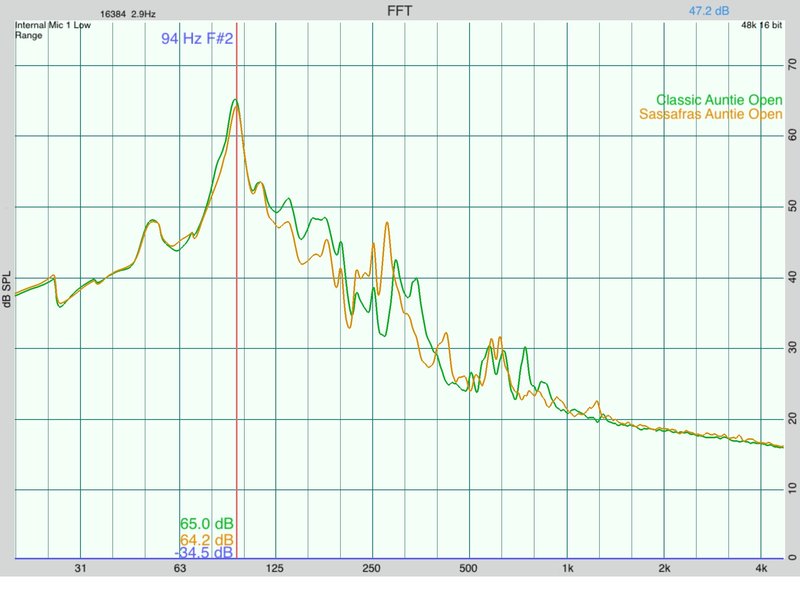

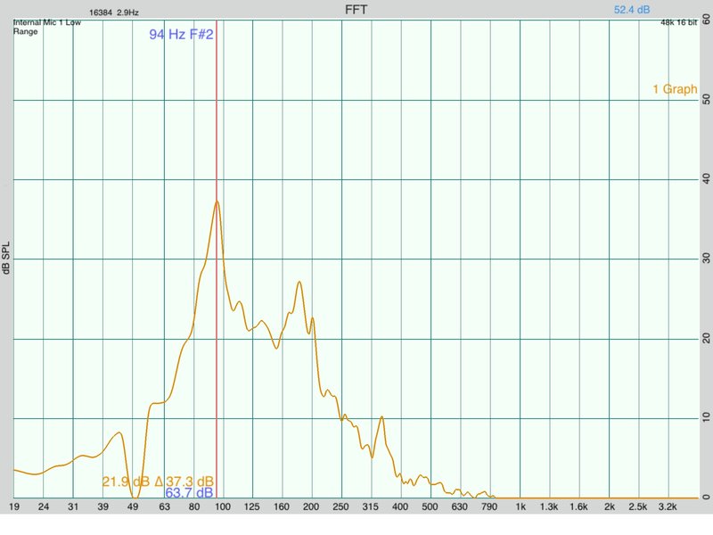

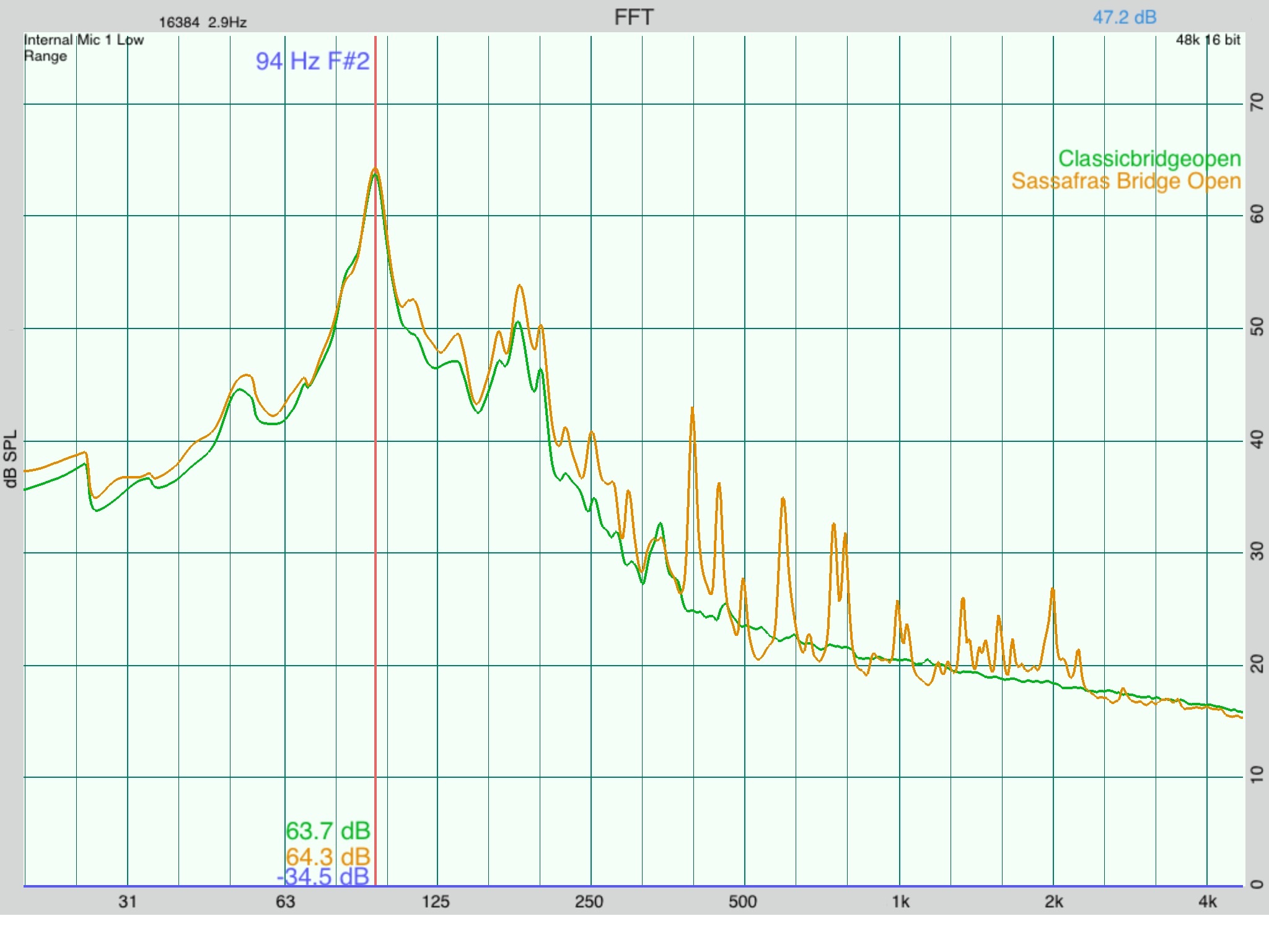

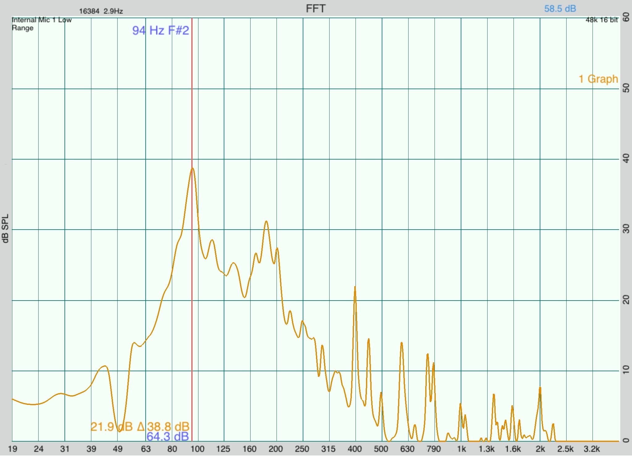

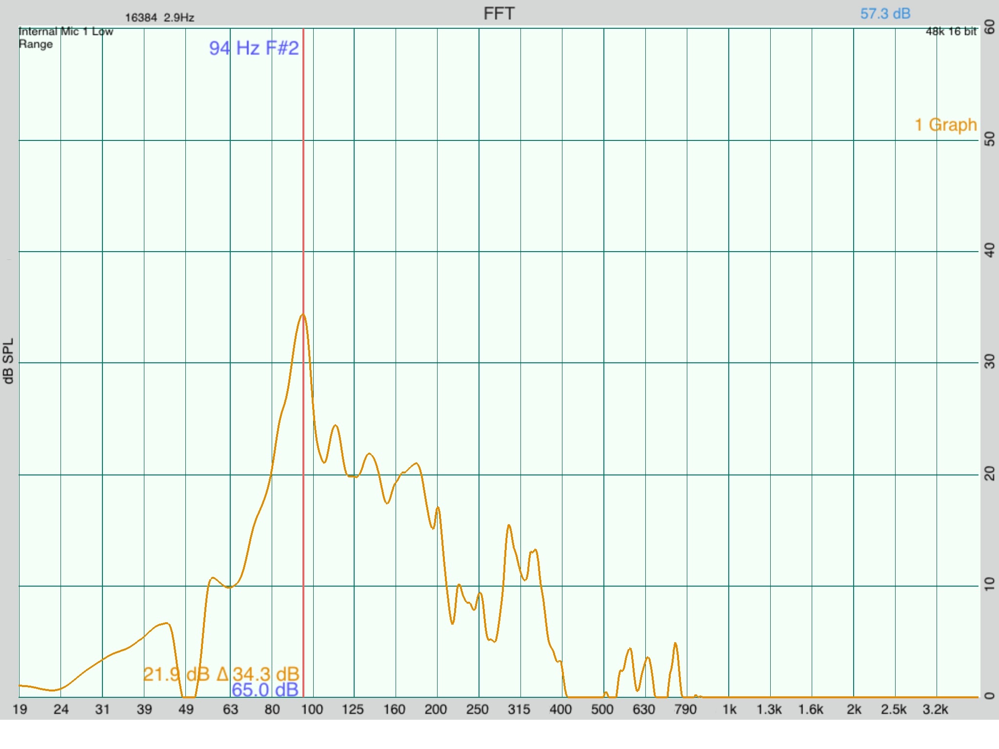

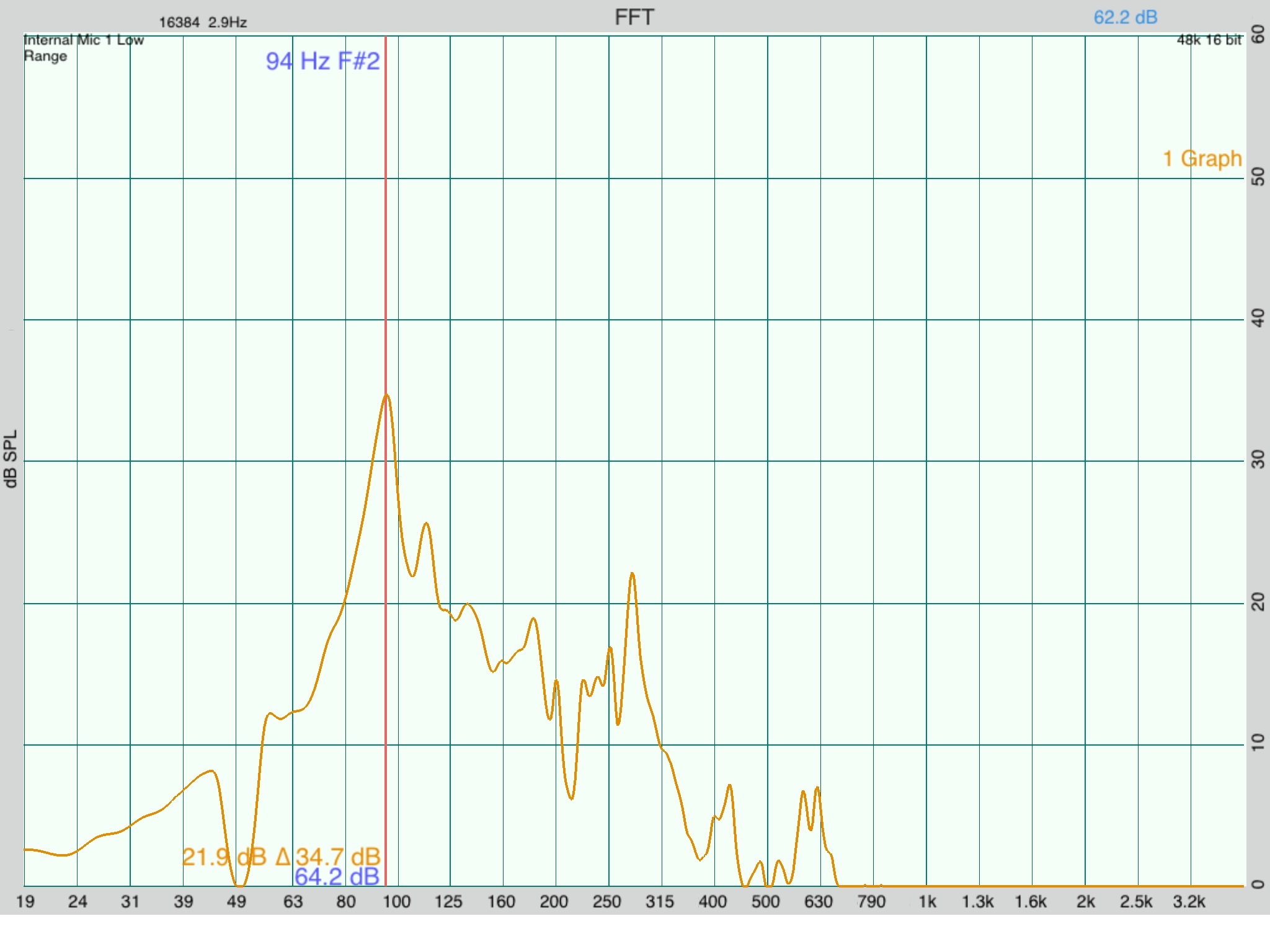

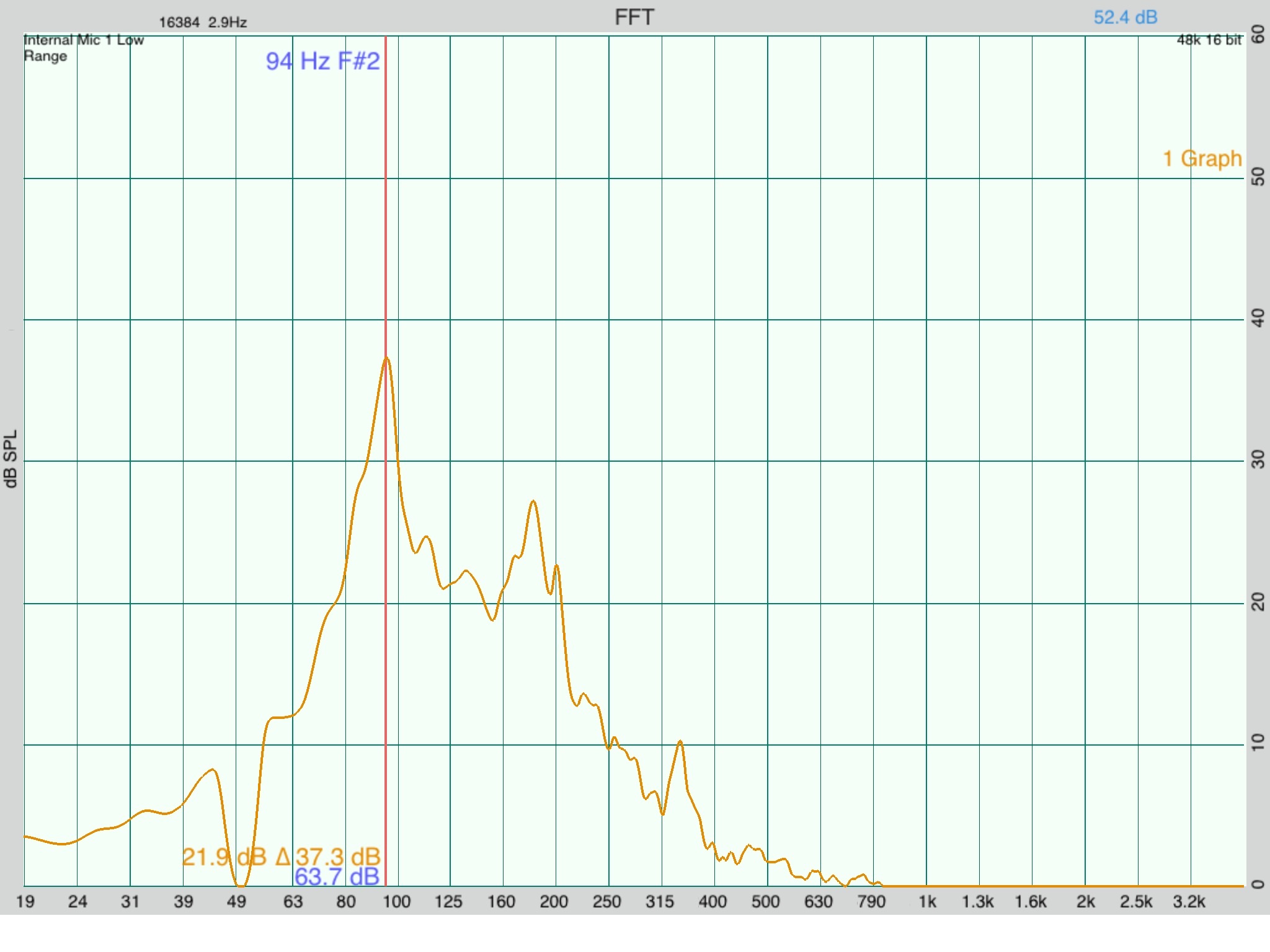

Here is my first attempt at collecting FFT samples John Parchem.
Craig I used your advice and downloaded Andrew Smith's iPad app, it was quick to learn and seemed to record something useful.
I used Trevor Gore's guide to collecting stats, tapping 10 times near the bridge and near an antinode. Furthermore the App allowed background noise to be sampled and then subtracted from the recorded noise. The graphs are all results of average inputs.

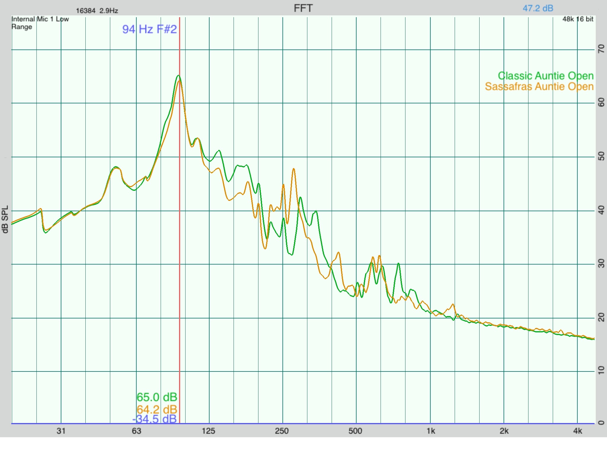

The following two images show the results on two guitars side by side. The two guitars are made from the same mould, one labelled classic has a sound I am very satisfied with. The second 'sassafras' has a treble which seems to distort, almost like a wire on a snare drum, but much more subtle. Both guitars were fully tuned to EADGBE and strings were left open to resonate with the tapping. The taps were made by a fret hammer with layers of felt taped around the plastic hammer head.
If you do have five minutes to look at the graphs and suggest a root cause that would be very appreciated.
Strike on bridge
The sassafras (orange) guitar seems to be exciting a lot more partials than the classic (green). This, I guess, is due to stiff areas of the soundboard being excited that perhaps need bringing under control! Strike at Anti Node, about 70mm in from bottom edge directly over the X Brace
Same fundamental tone with a markedly stronger overtone at 270Hz
RAW DATA
Sassafras Bridge Strike Sassafras Anti Strike
Classic Bridge Strike
Classic Anti Strike
Strike on bridge

Re: Adjusting sound
Comments from me:
1. Dampen the strings when tap testing. I slip a large piece of foam rubber between the strings and upper fretboard....if the strings vibrate then your going to get peaks all over the place.
2. My hammer is an eraser stuck on the end of a piece of dowel. I do my tap tests sitting with the guitar in a playing position.

I'm not real good at looking at other builders Frequency Response Curves (FRC) because there is a fair amount of information picked in recording the curves that helps interpret. A couple things though. The big peak at 94hz seems too low to be T(1,1)2. More likely T(1,1)1, the air resonance. Are you pointing the sound hole right at the mic? Typically the air resonance is pitched below the main monopole and lower in amplitude. The other thing would be that I typically dampen the strings with my hand or some folded cloth under the strings. I tap with my index finger, give it a good wack. If the peaks are muddy looking (wide or split), I'll switch to a pencil tapping with an eraser end, but you have to careful not to bounce it on the top or you will get double peaks.
When you say the treble distorts, is it one string only? Or all the notes above a certain frequency no matter where they are played? Is it one note, a couple or many? What is the range? I'm thinking distortion is not a top tuning issue that will show up in an FRC, it is more likely a mechanical issue of some sort. Could the string(s) be buzzing on frets?
Re: Adjusting sound
Brilliant
Will redo tests with damped strings.
Craig, it's a buzz that sounds like a fret problem that is heard on top two strings whether open or fretted, there is no fret issue as I have already looked into this replacing both saddle and nut with plenty of clearance.
The graphs had mic turned away from source.

Thought I found a smoking gun there for a moment, your comments suggests all is not so straightforward. Saying that, the good guitars I have built all have strong fundamentals that are followed by quieter overtones.
I'm no expert on what makes for great notes but this guitars E4 string has very loud and clear E6 and E7 partials ringing out.
The bracing is already very light I'm thinking that sanding down the soundboard on the treble side might quite down the partials.
