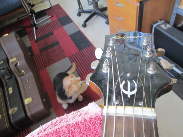

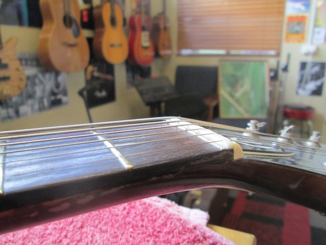

I made a nut to fit in between the zero fret and the nut.
The intonation is not perfect but close enough for old style blues.
Thanks for all your discussion.

- Posts: 1169
Re: Bottle slide setup
That'll work. Good fix
