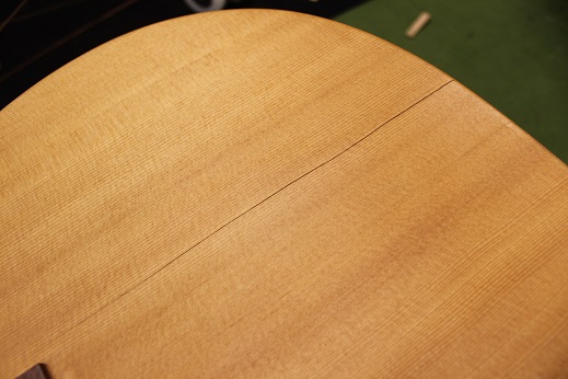

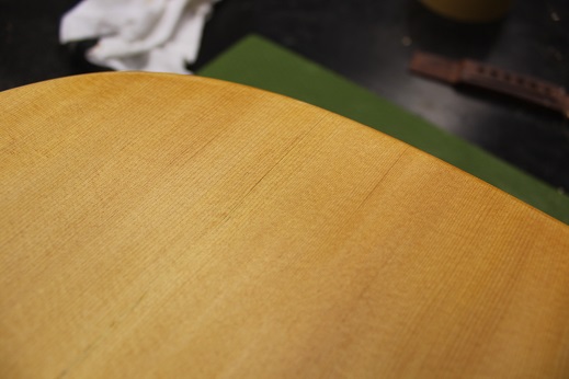

How I do a splint repair.
http://www.mirwa.com.au/HTS_Splint_repair.html
Badly split top, won't glue back together, it's had multiple side repairs, so I'm guessing over the years it's not been aligned the best.
After splinting, give it some time to age and hopefully it will eventually dis-appear
