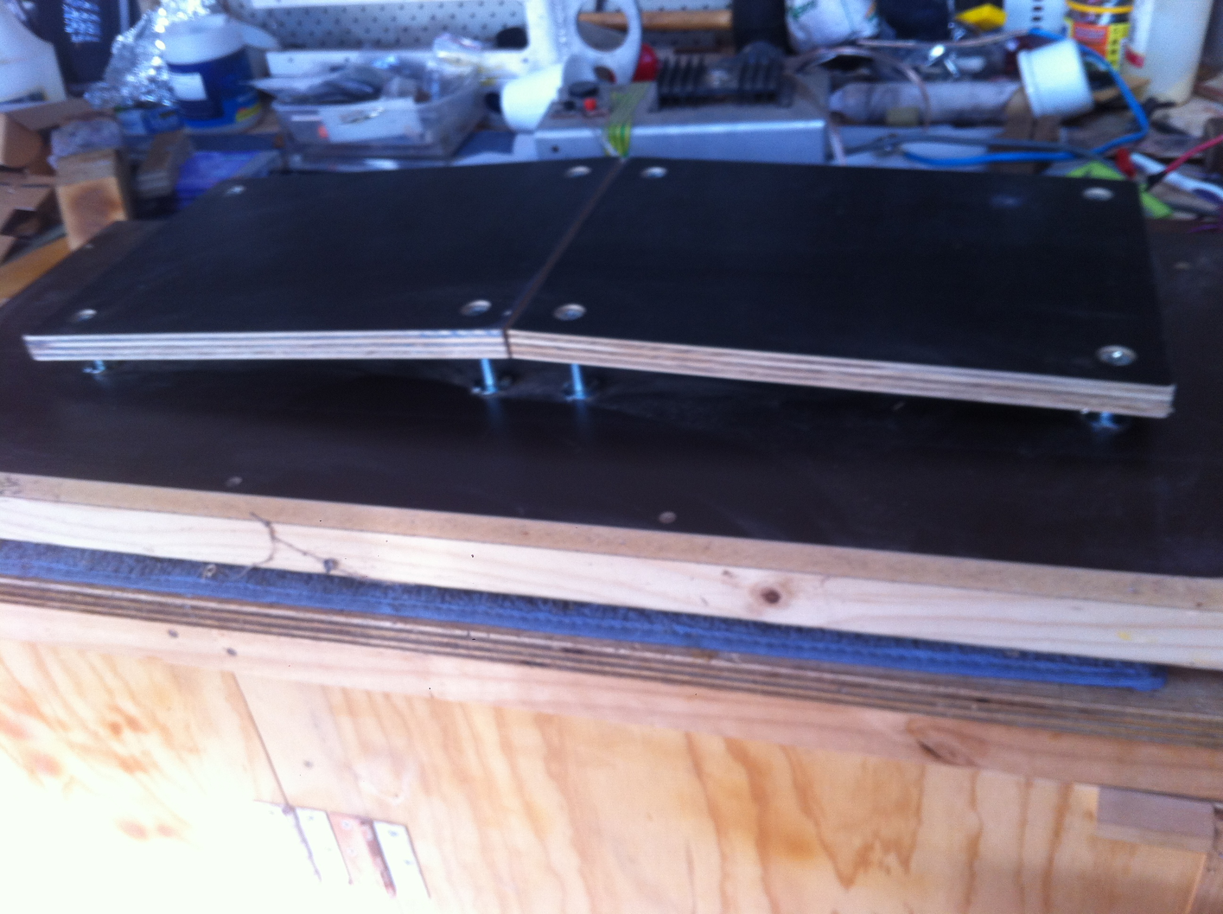

Yep, there is no substitute to getting your hands on good examples of the style you want to build. I've been very fortunate to been given access to several large collections of vintage guitars over the last 6-7 years and this has been immensely helpful. If you can develop the repair side of lutherie, people will send you their vintage guitars and you not only get to study them as you fix them up, you make money too! Win-win! Easily half the vintage guitars I have studied came to me this way. You also get to see what works and what does not.
I understand about the ripple in the top at the tail end. Do you put a dart so to speak in the center line? I've heard of doing that, but not really tried it. I usually work it out with the caul in this area.

I put the dart in when I shoot the top halves, with this shooting board. It can be adjusted in a few planes with the screws, ie for pliage angle and the lengthwise angle of the soundboard join. For some reason, probably to see if I could get the angles a bit better, I changed it then ended up getting quite a crease at the tail when I made a thin top, four braced, which was only apparent after the tension was applied around the soundboard edges after gluing the completed top to the body. It was also the first one I tried without a fingerboard wedge, adding some stress at the other end of the top as well. So have to make a few tops and glue them to sides to get it just right. If you read my fb pm, you'll understand that I may not have a lot of time to get where I'm hoping to end up with my builds...
