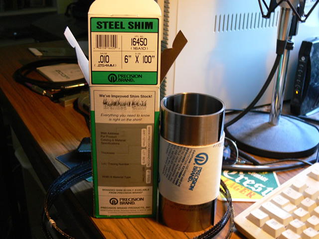

Post by Hippety Hop » Fri Jul 25, 2008 5:53 pm
Image Cost $34.65
I haven't unravelled it yet, but it looks nice and clean like stainless. I'll give it a wipe with my oily rag.
Cheers Hip.
