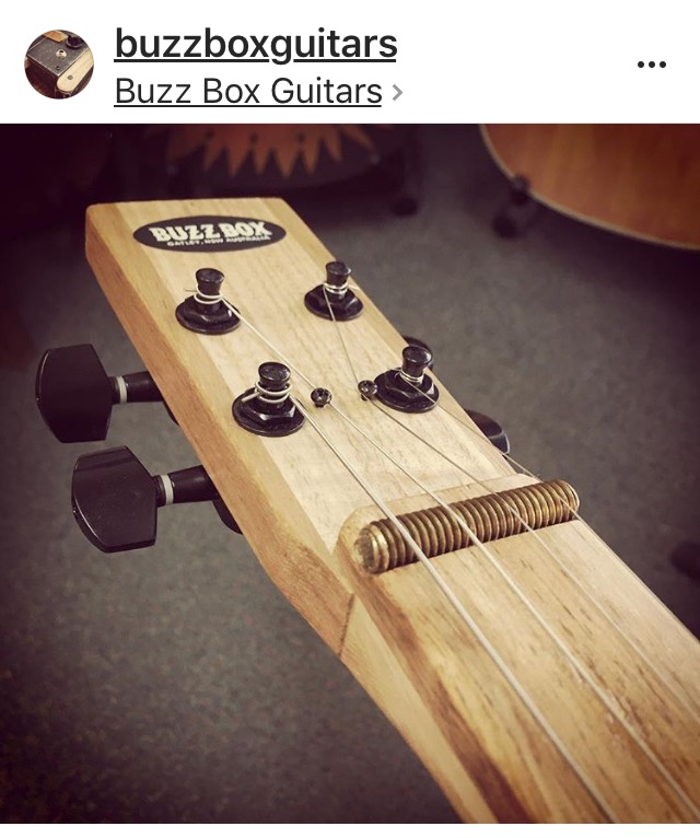

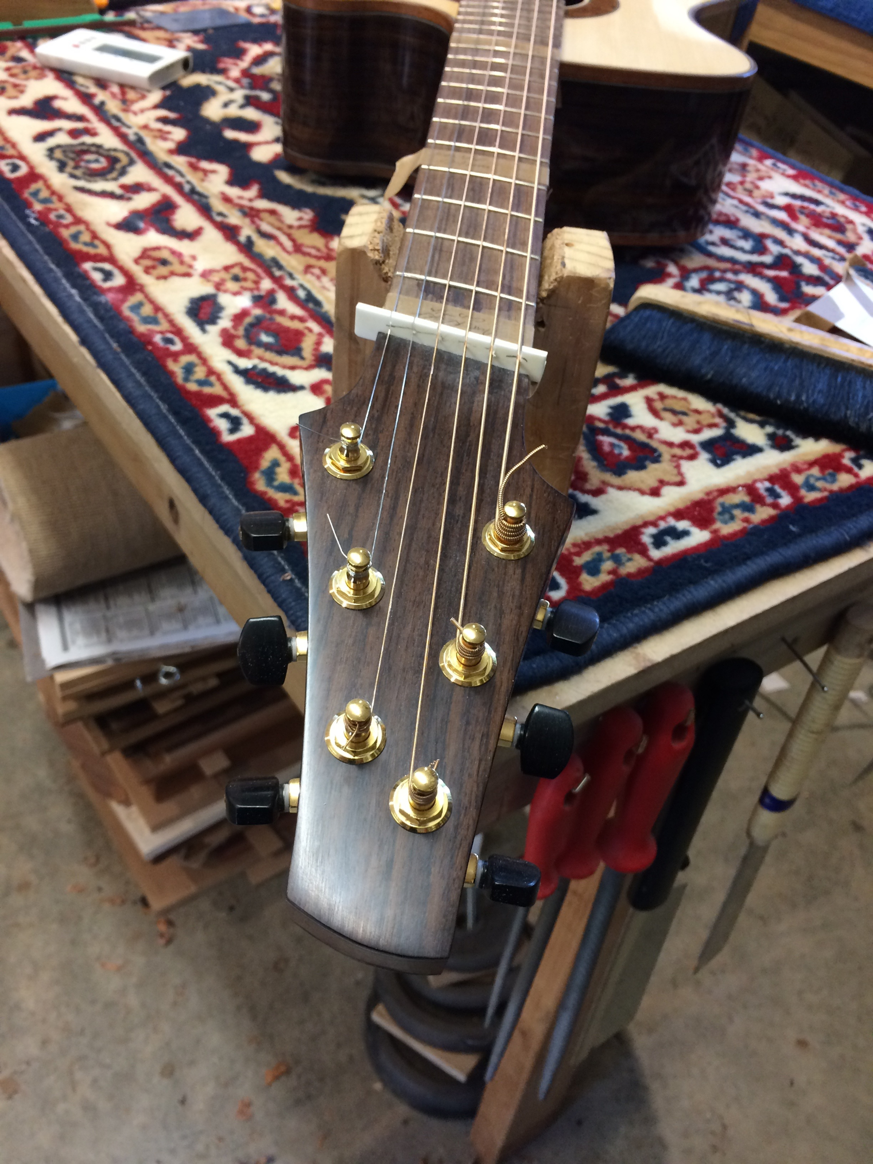

I really like the idea of straight string-pull but really don't want to give up on a symmetrical headstock. On my current steel string build that has led me to try thru headstock banjo tuners. But the other day I did see this :
What do people think? Are there other there other downsides with this compromise?
So I am thinking that with this sort of articulated string-pull you would still gain the better intonation at a compensated nut having the straight string but just defer any hang up to the articulation point.Articulated string pull
