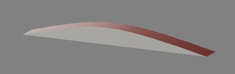

You are quite right, and thanks for the nudge.seeaxe wrote:Hi Deems
Seeing as we have given another recent poster a hard time for not using the correct terms, we had better make sure you are!
A bowstring is a much better analogy of what I was envisioning, rather than a brace carved from a solid, I was thinking of something that could be 3d printed with carbon fiber, kept to a very low mass. It would consist of 3-4 major components:seeaxe wrote: A better idea would be a simple bowstring truss/brace with an adjustable mid span post.
a. A base ( less than 1 mm thick by 3-5 mm wide) that would follow the same contour as the bottom of a falcate brace. This would be used to glue/attach to the soundboard
b. A micro adjustment mechanism attached to one end of the base. (this WILL be a challenge as Martin noted)
c. A series of triangular pylons placed at intervals along the lengthwise span of the base. these would be 3d printed and integral to the base
i. The pylons would vary in height from near zero at the end to 7-10mm at the thickest (bridge) point and then decrease in height towards the opposite end.
ii. The top of each pylon would incorporate a 'saddle' or an enclosed ring whose purpose is to keep the 'bowstring' material positioned properly. (The curve of a falcate brace presents an added complexity. a prototype might start with a straight brace)
d. A bowstring (material to be determined) that is firmly attached to one end of the brace, passing over each pylon and then attached to an adjusting mechanism on the other end.
by shortening the length of the bowstring I believe it would increase the stiffness of the brace.
If I can find some time, I'll try and draw up a 3d CAD model as a picture would no doubt add some clarity ( and some additional questions).
Thanks for the comments, and counsel.
Deems
