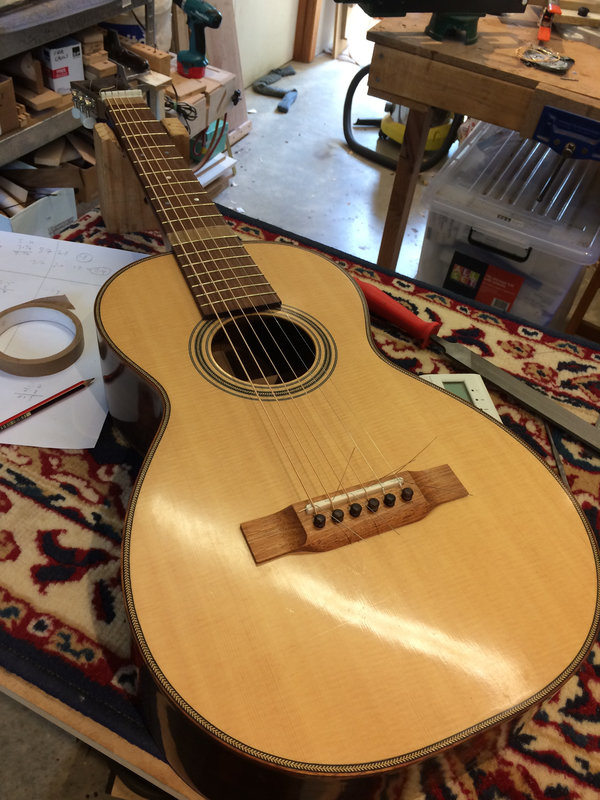

Getting to the end of this build after too many years...Ive forgotten when I actually started this one. Its had a string up and a quick test play and I'm currently setting up saddle and nut compensation. Specs as follows:
Scale Length: 619mm
Top: Sitka spruce. Bracing is falcate as per The Books.
Bridge: Blackwood. There's a rosewood/CF bridge patch underneath.
Bindings: Blackwood.
Back and sides: Indian Rosewood. The sides are laminated onto macrocapa.
Neck is Queensland Maple with rosewood fretboard. Neck is bolt on/bolt down as per The Books.
Tuners are Stewmac cheapies and the strings are Daddario lights.
Finish: Hard Shellac.

Love Parlour guitars.
That's a beauty Martin all class.
Al

Thanks Al...
I had a quick play and for a small guitar she's loud and bright.

Looking good Martin.

Nice looking Parlor. I like the classic look of a slot head 12 fret parlor.

Very very nice!

Very nice job Martin, I might get a closeup look at it next week!!!
Rod

How deep are the sides?-Ross
