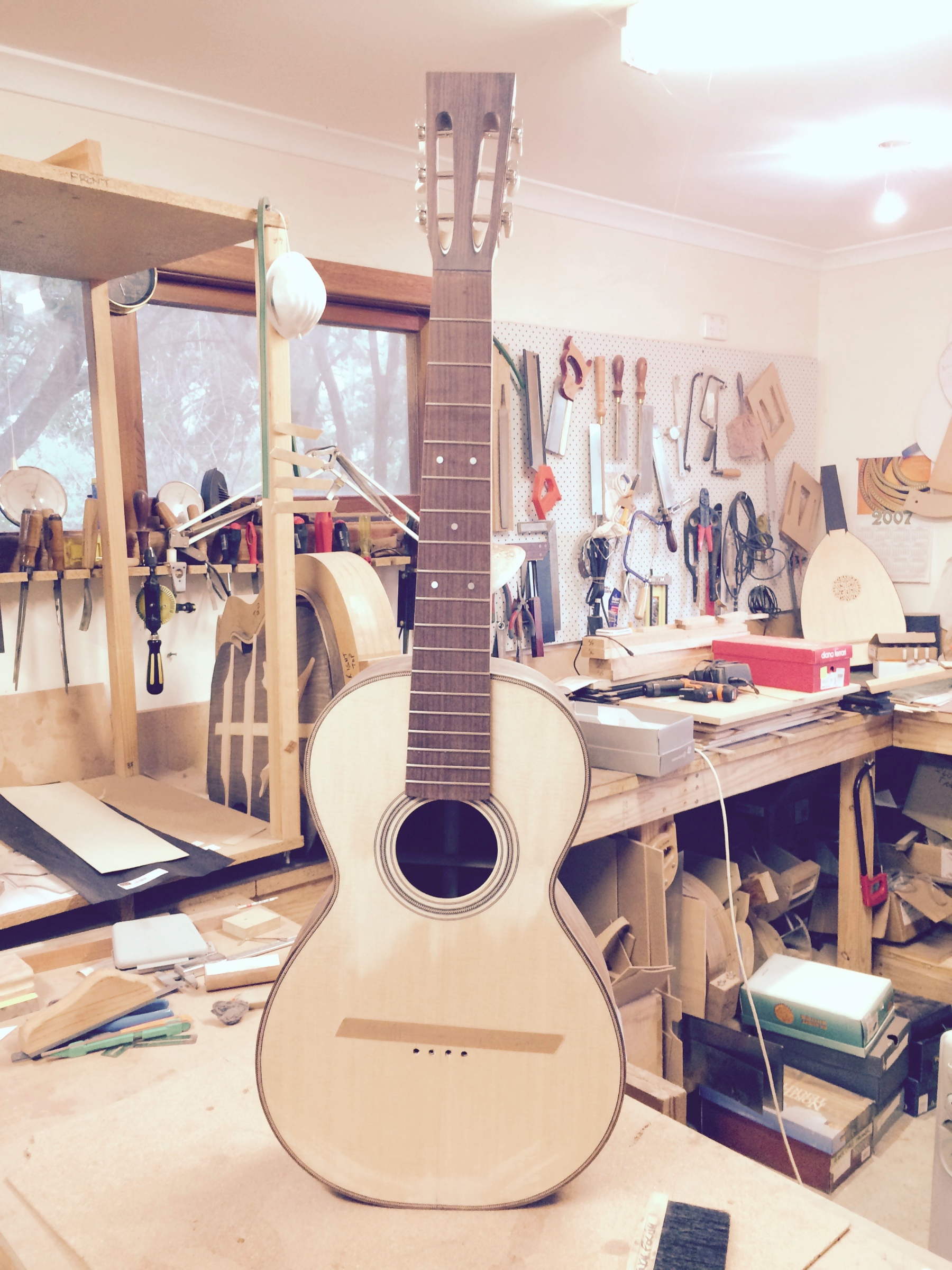

I did a 14 fret to the body 00 and it turned out. It has an arm bevel that I think makes the sound board more like a 0 size. The owner loves it. Here are some pictures viewtopic.php?f=1&t=6444

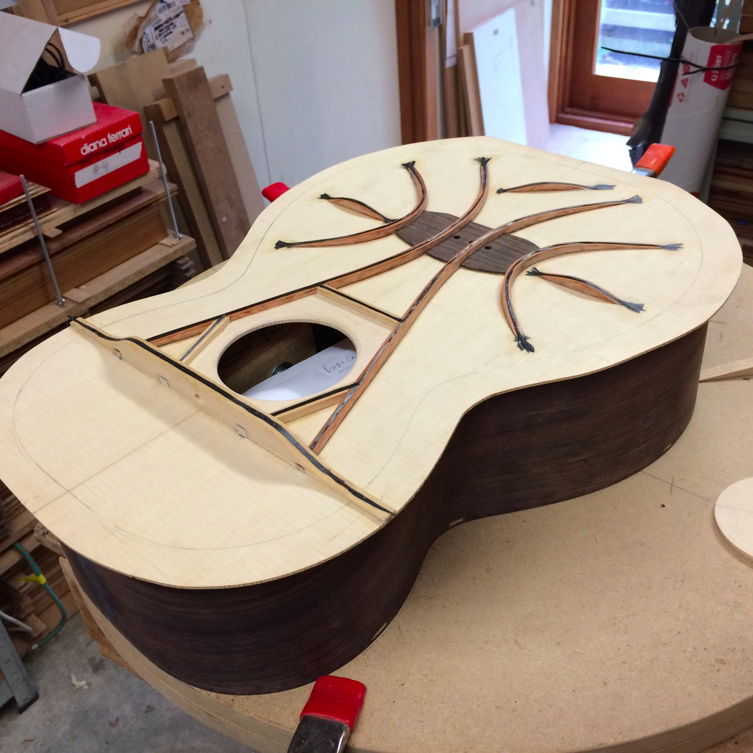

Francis...I'm currently building a falcate braced parlour. Here's a pic of the braced up soundboard.

Thank you both for the photo's looks like I can go ahead with the build.
