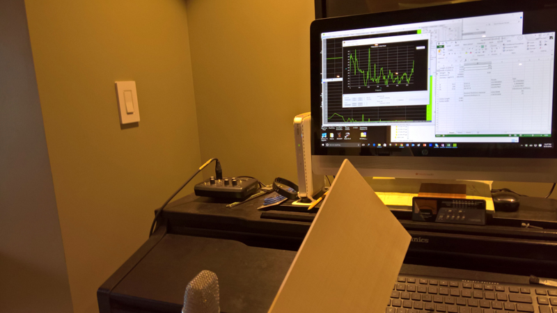

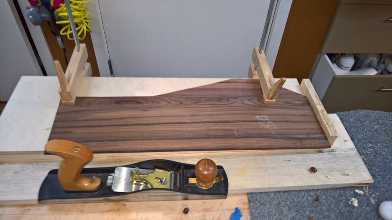

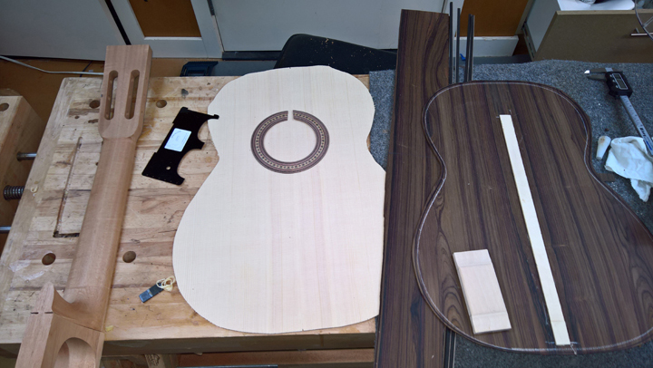

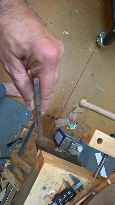

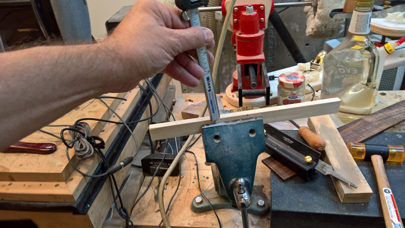

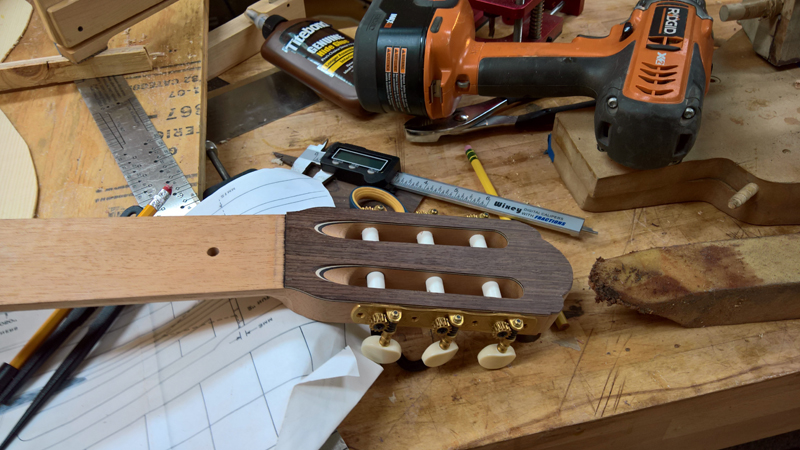

I spent the day getting the project up and going. First off I did the tap test to determine the target using one of the Gore\Gilet methods. The Lutz fell into a normal range, a little more cross stiffness than other tops.

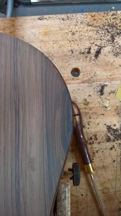

I joined both of the plates. I am a bit embarrassed, maybe being on the wrong side of 60, but when I went to my plane drawer to get a plane with a sharp blade I found a new looking Lie Nelson #62 low angle jack plane that I have no idea that I had or when I might of bought it.
I loosely profiled the top, back and sides, thicknessed the back and sides and glued on the back reinforcement strip. Ready to start bending and putting things together.

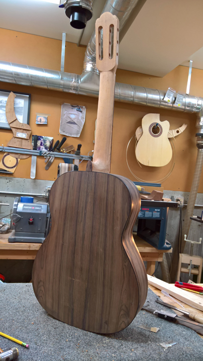

Another build thread!
That back looks nice, cant wait to see that later on.

The plane was a joy to use; actually a bit of a learning experience in how well a properly tuned plane works. Mike I do have some long forgotten wood gems in my closet. I watch the classified on various forums if I see some nice wood at a nice price I buy. It goes into my stash and generally out of my memory.

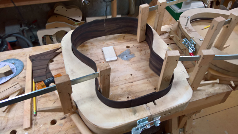

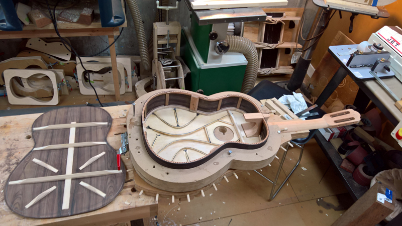

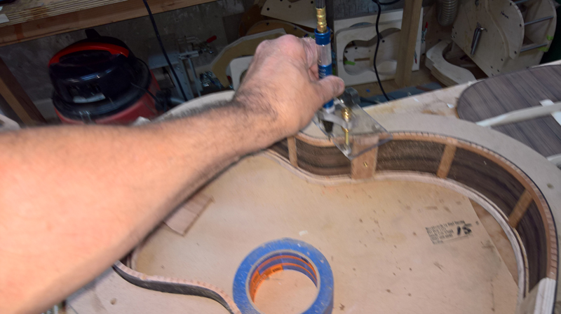

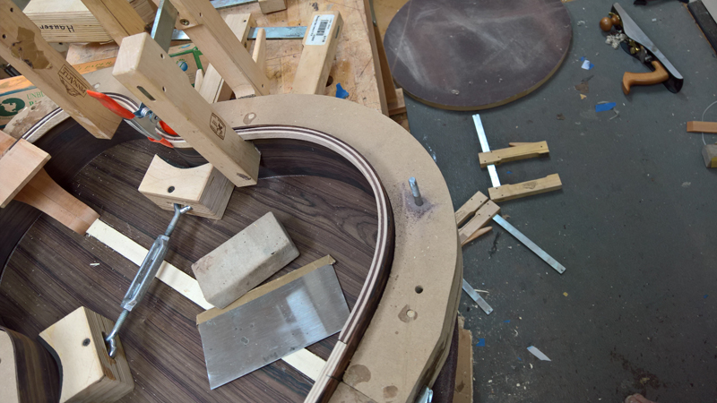

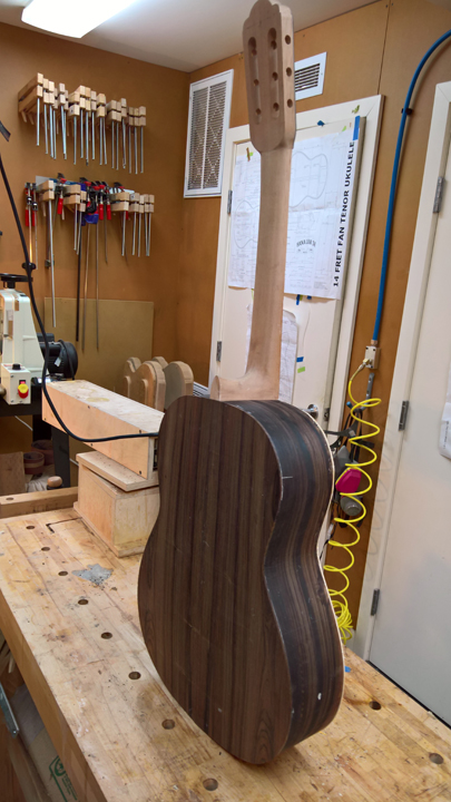

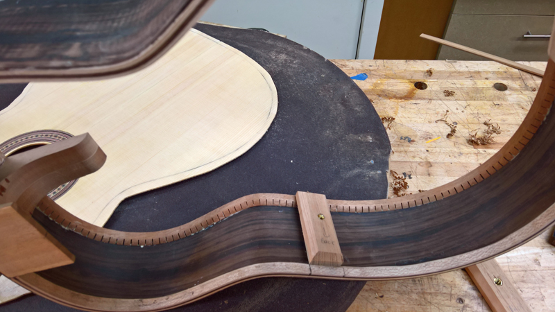

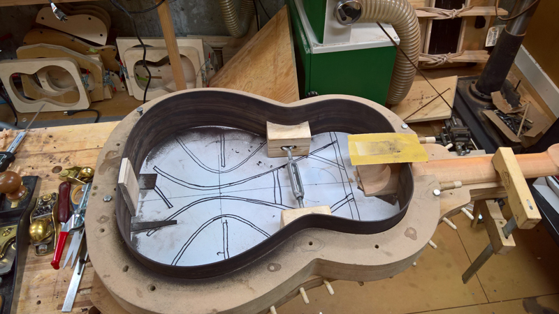

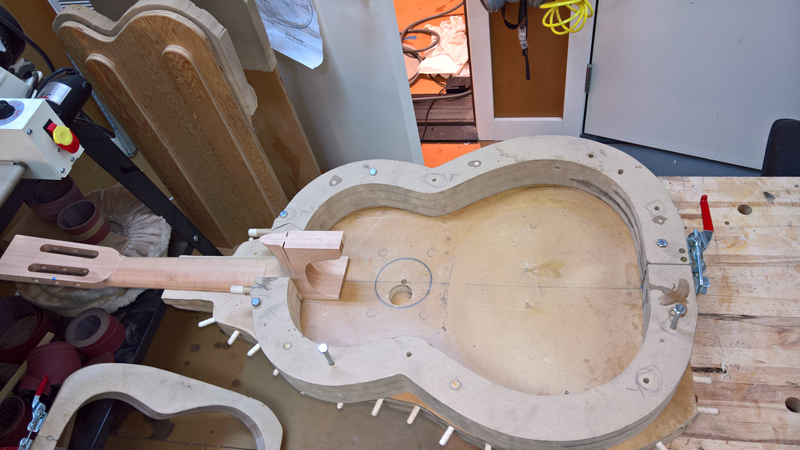

I spent the last couple of days getting ready and starting on the rims and top. As this is a traditional design I am going to build on a modified soleara that I made for my very first guitar. The modification is one that I got from the Bogdanovich book. I liked the idea of having a removable outside mold on the solera. So I combined my solera with an outside mold I got from Kenneth Michael Guitars.

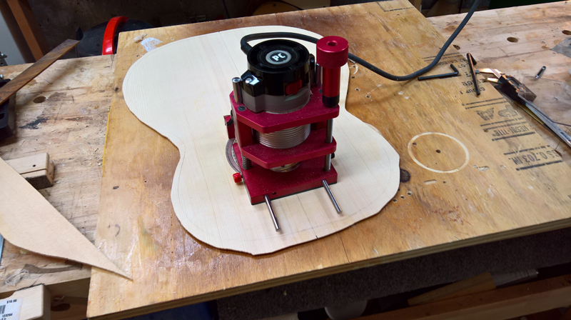

I also have a closed outside mold that I use for my contemporary Classical guitar with a bolt on bolt off neck. It comes in handy when trimming the sides and gluing on the tail block. I also use the mold to sand the tail block to match the rim. I had no issues bending the sides and my bindings with my fox style side bender.

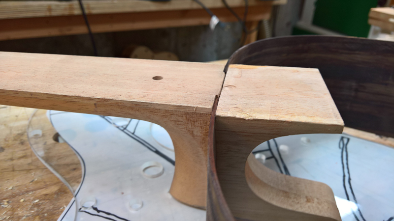

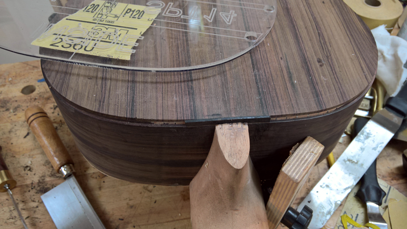

I got a little ahead of myself. I normally would wait until I had both sides cut to fit in the mold. That way I would have the sides cut right on the center line at the heel end. But I went ahead and glued on the tail block. No real issue but I had to do all of the measurements and cuts to fit the sides to the neck with a floppy glued assembly.
I did remember to take a couple of mm off the top side of the heel block so the top can sit flush to the neck. I used my Bishhop Cockran router base to route off the heel block. I extended the guide bar a bit so that I could balance the router on the plane of the neck.

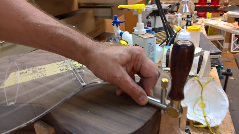

With the sides fit I used 15 foot radius sanding bar to trace out a close cut for the heel slipper for the back of the guitar. I used a band saw to cut close to the line. Then assembled it all in to my solera. I am going to wait to actually glue in the sides until the neck is close to the final profile. It is a lot easier to deal with a neck than to deal with a neck with a guitar stuck to the end.
I also propped up the rims the thickness of my top. The solera has a sloped ramp for the neck to ultimately give me 1.5 - 2 mm (measure at the nut to the plane of the top) of forward angle to the neck. Assembled as below I can use a radius board to profile the rims and the neck heel slipper.
My side profile was much closer in depth at the neck end than the tail end. When the neck side was close I used some stick-um sand paper to prevent over sanding.

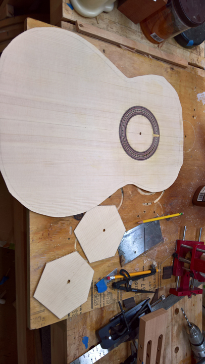

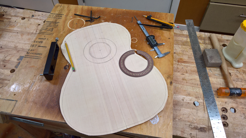

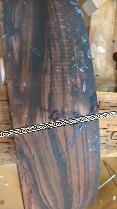

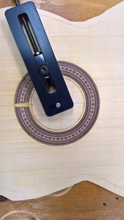

I also was able to install the rosette. I used a router to cut the channel but decided to cut the outline with a knife circle cutter and then route out the waste to the knife cut. I think I got the tool from LMI. It is nice in that it has the same size hole as my router base.
I got my cleanest channel ever with a perfect fit. I used titebond hide glue to glue it in. The dark lines around it are a combination of pencil lines and shellac from my initial preparation.

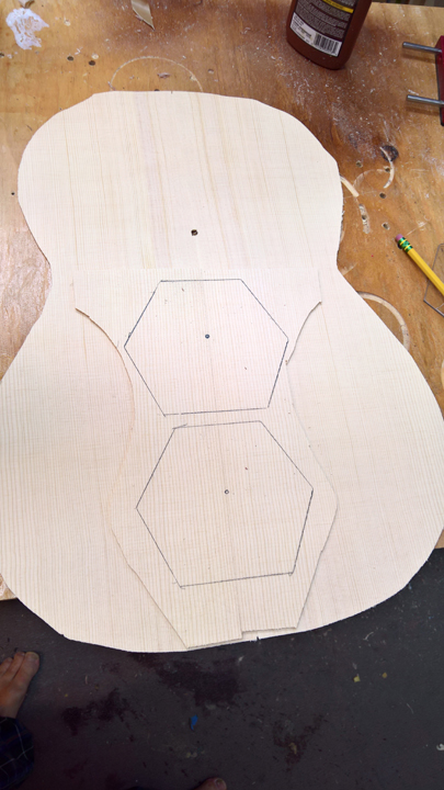

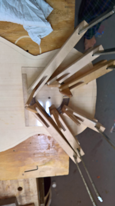

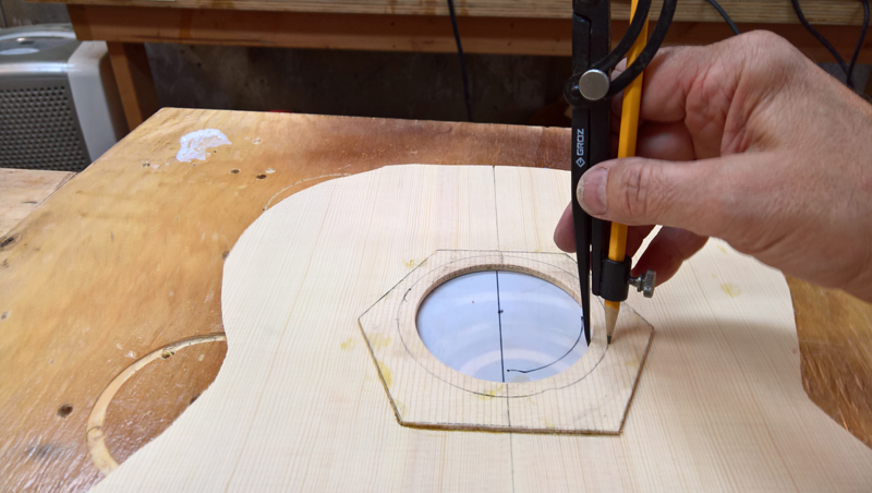

I jointed some of the waste from profiling the top for a couple sound hole doublers and thickness sanded it and the top to close to my final thickness.

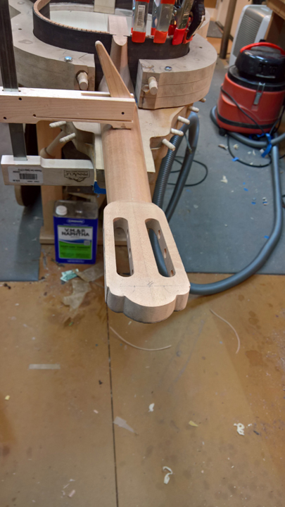

While waiting for that glue up I profiled the head stock. I am glad I did not glue the sides to the rims. It was a lot easier cutting the profile on a band saw without the rims flopping around.

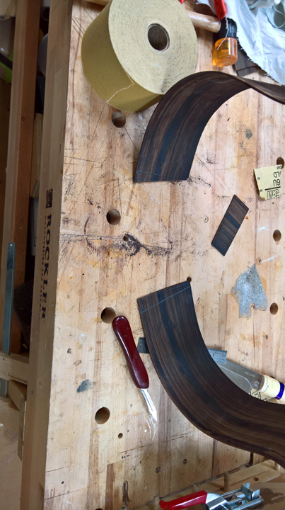

Making a bit more progress mostly working on the rims. It has been a while since I made a Spanish style neck joint.

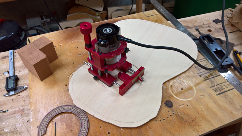

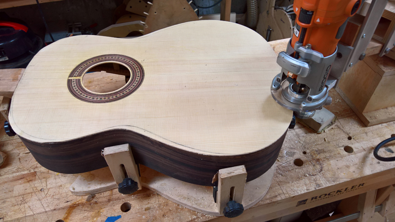

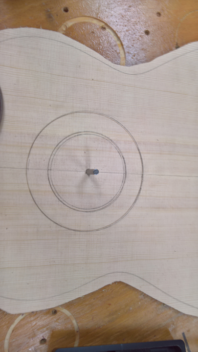

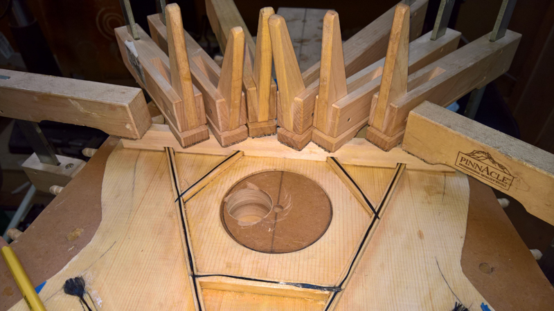

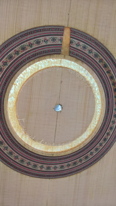

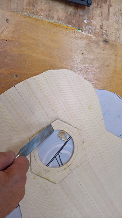

I used the LMI circle cutter to mostly cut out the sound hole. With the sound hole doubler patch I need to cut about 4 mm deep. A bit much for one pass. One bad feature of the tool is that I need to back out the radius to get the hex wrench on the set screw for the blade. Screw that! after I made the initial cut I pulled out the router and left just enough wood to keep my pilot hole center. I did have a nice clean knife cut on the top.
I marked and beveled the sound hole patch to make it look good from the front.

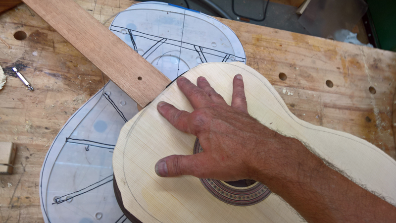

I also trimmed the neck side of the top real close to the final profile to fit on the neck heel.

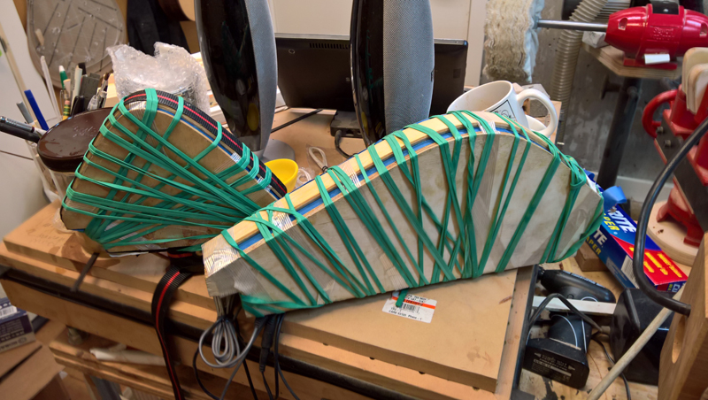

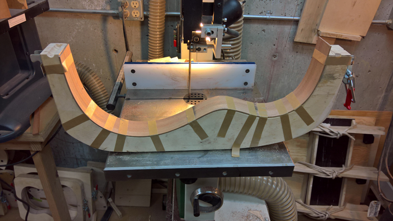

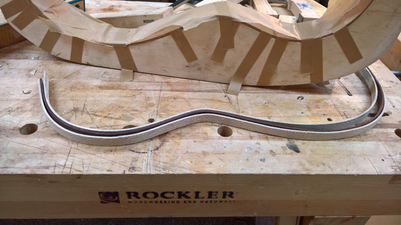

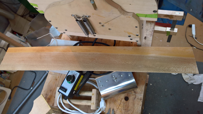

I grabbed a sycamore side from my stash of orphaned sides I have bought over the years bent it and ripped it to make solid linings for the top. I also had a pre-bent EIR side hanging around for a few years, so I also popped it back into the bender and riped it to make fancy laminated linings.

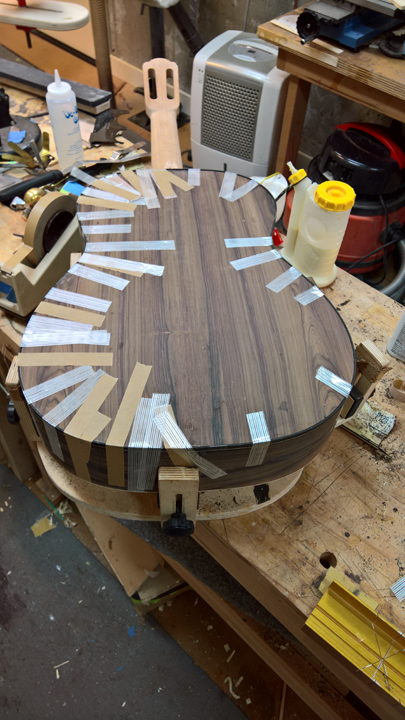

I just used my mold with another bend side to laminate the stack. I just used LMI yellow glue. Never enough clamps though. I needed to do one lining at a time.

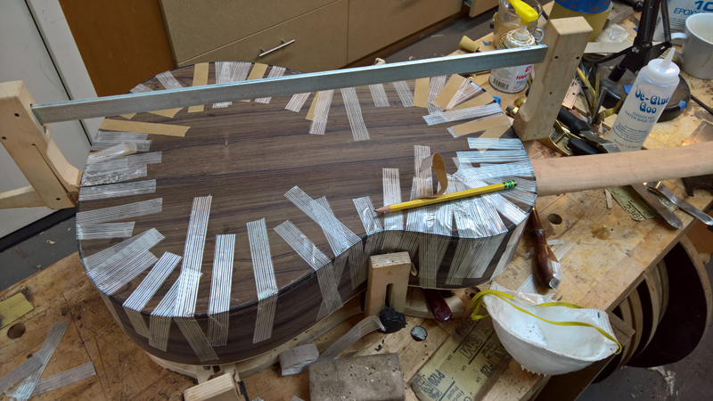

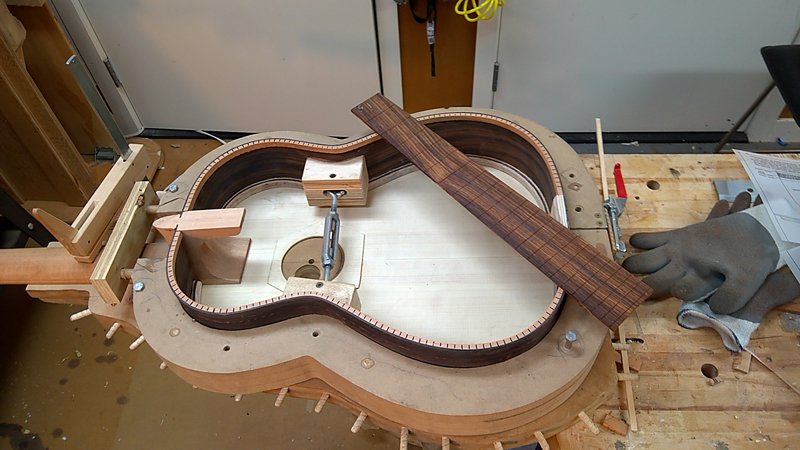

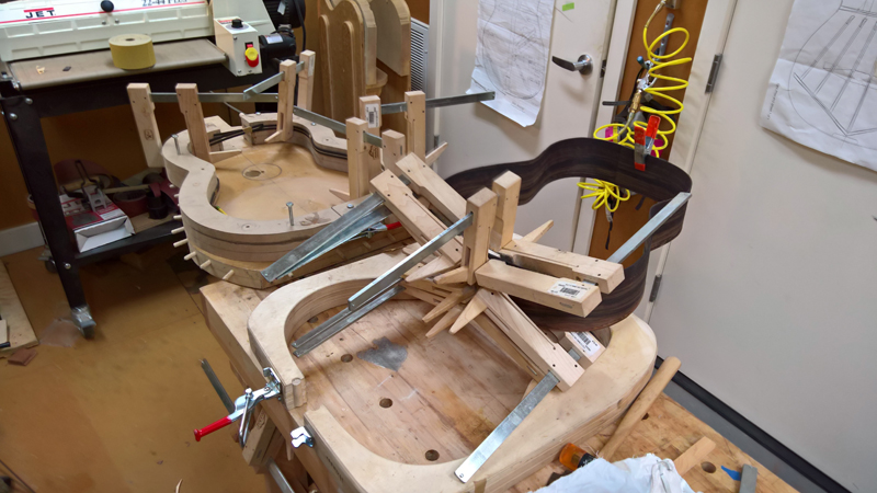

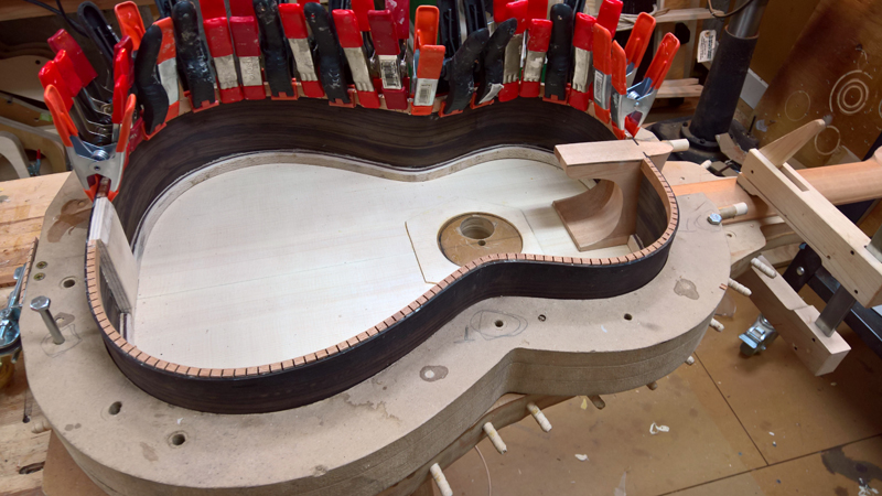

By hook or by crook I got the solid linings in the top and reverse kerfed linings for the back.

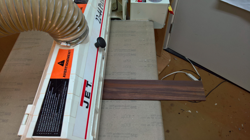

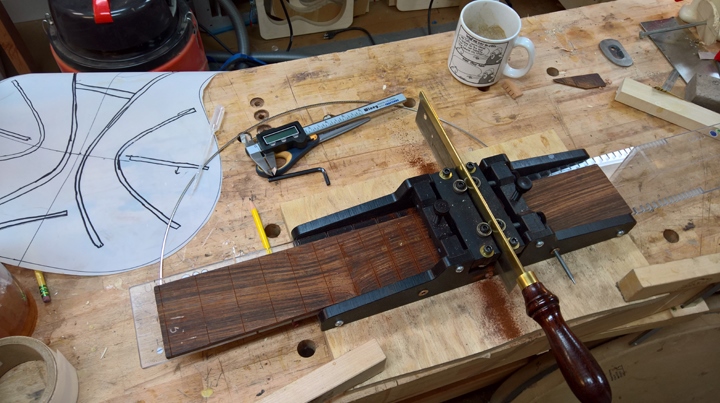

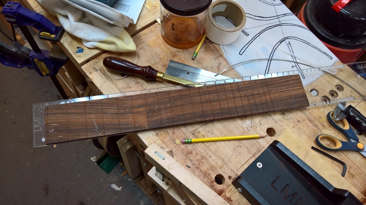

During the binding glue ups I made the fret board and worked on cleaning up the headstock
I glued a 1mm thick strip on the base side of the fret board and then thickness sanded it. Now the base is 1 mm thinner than the treble.
I re-radiuded the back of the rims, also along the way I profiled the fretboard.

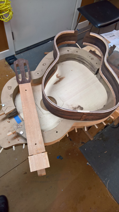

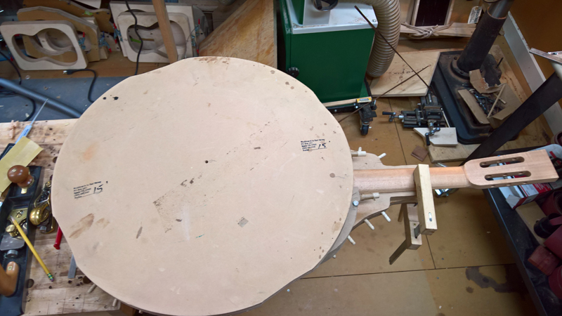

I have yet to glue the sides to the neck so I removed the sides and will be ready to profile the neck tomorrow. Hopefully I will also finish the rims with a mass support block and some of the side reinforcement strips.

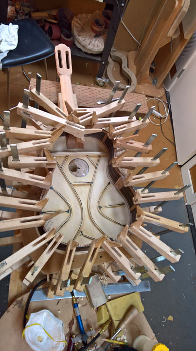

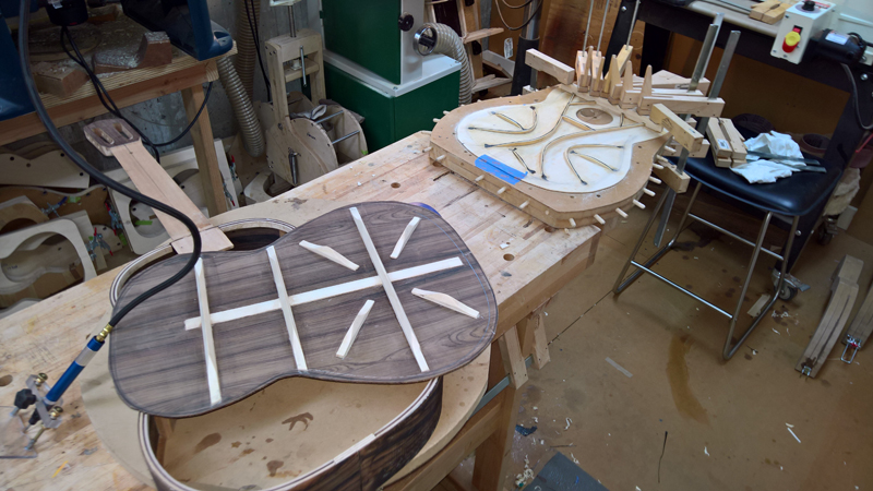

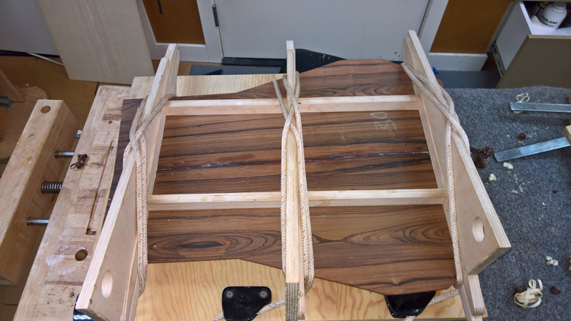

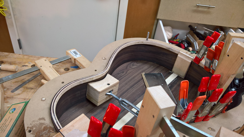

Sorry I have a big post. I have the rims nearly ready, I have braced the back and have one remaining brace for the top.

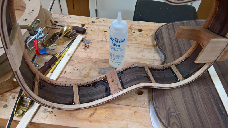

To finish the rims I added a couple of the mass blocks, that would allow me to tune down the top a bit after finishing the instrument. I also added a bunch of side reinforcement strips.

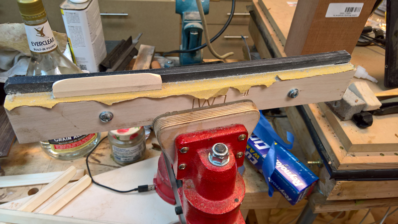

I used de glue do to clean off the harden glue. I got a bit sloppy

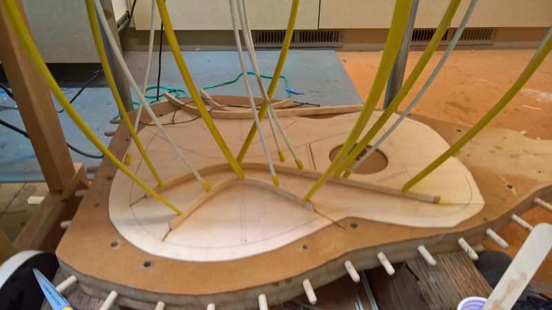

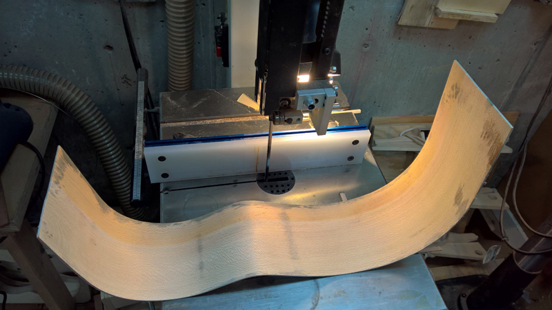

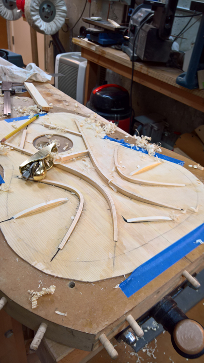

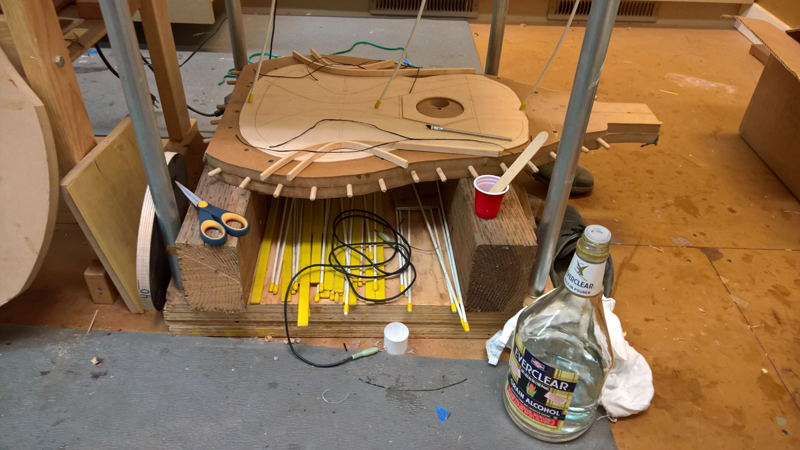

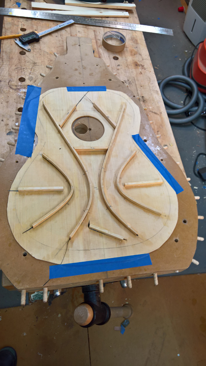

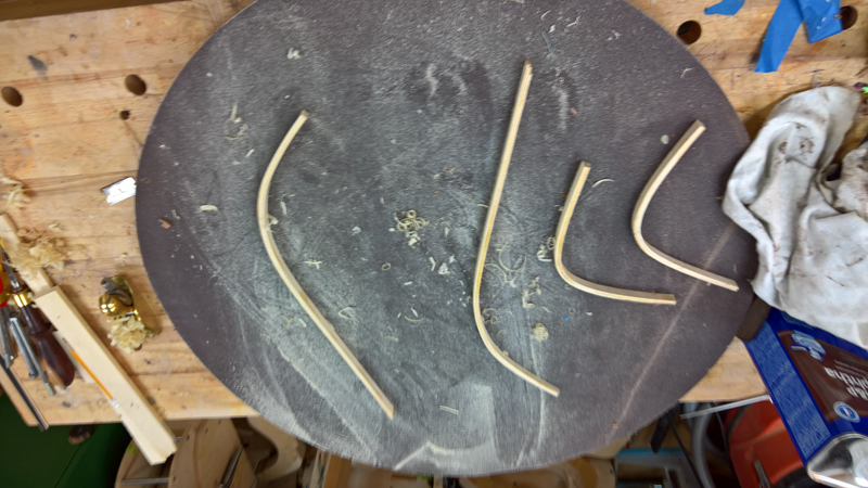

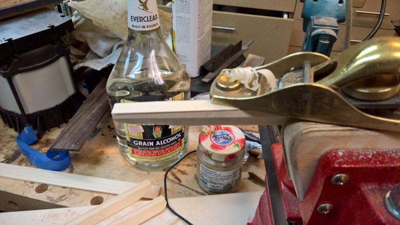

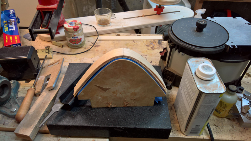

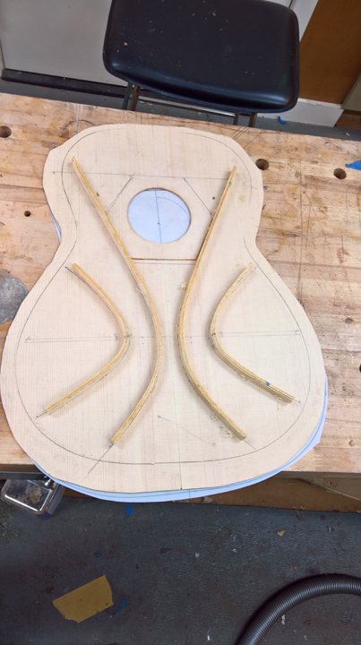

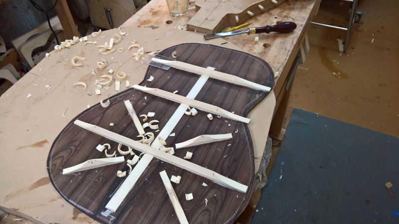

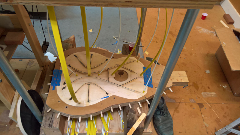

Around the same time I ripped a bunch of 1.7 mm englemann spruce strips and bent them on a hot pipe. The engelmann really bent easily for me this time. I used german spruce on my last classical and that wood was not happy about bending. I was amazed at the difference. I used West system 105\206 to laminate the falcate braces on the forms.

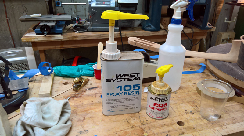

The next day I ripped them in half on the bandsaw, sanded them flat and prepared to epoxy them to the top.
I make sure that I have everything ready before I mix the epoxy. Once mixed I try to work quickly but more and more I try to be a bit neater.
It took me two session but ultimately I got them all epoxied. I then profiled the braces. For this guitar I am going to use 10 mm for the main falcate braces and 7 mm for the secondary. The braces all need to be profiles before they are capped with another strip of CF tow.

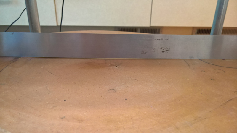

Note the effort I made to force the top to follow the solera before laying on the fiber.
The Solera has a 2 mm dish in the lower bout.

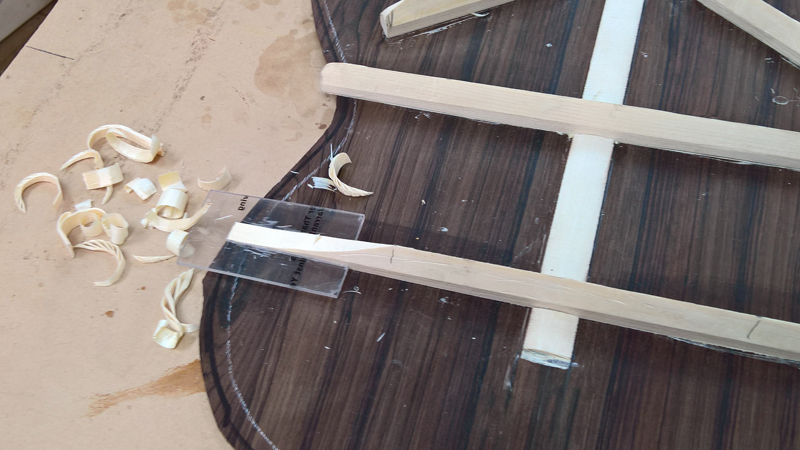

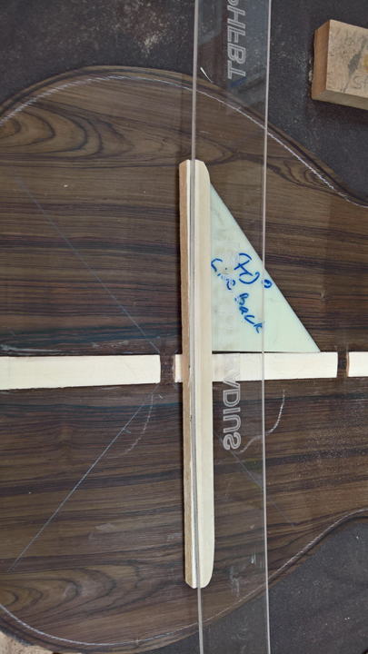

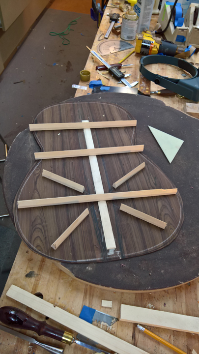

The back is a little more conventional. As per the book I pre profile the back braces with a 22.5 degree chamfer bit.
I will brace it has an active back, using 3 transfer braces and a set of radial braces

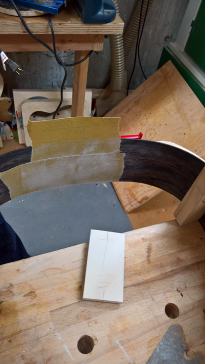

I used a combination of a plane and a radius brace sander to put the radius on the braces.

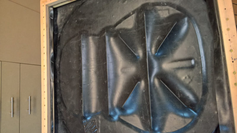

I glued the up in my vacuum box on a 15' radius disk.
I was able to find and use my handy brace end profile jig, and made quick work putting the profile on all of the braces.
Another couple of days and I will close the guitar.

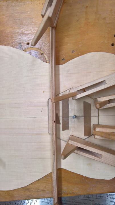

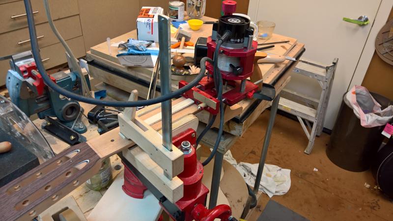

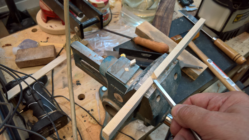

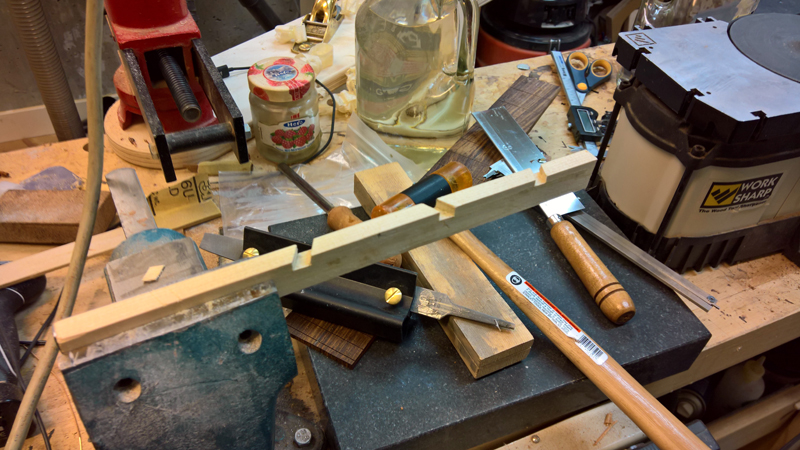

I added the upper transverse brace to the top. This is a bit of a pain as I inlet all of the braces that cross its path. As shown in the pictures I clamp the brace down, carefully mark the brace crossing with a scalpel and then use a razor saw and chisel to make the cut out. I set the brace right to the cutline in the vice and use the vice as a stop. I finally learned after many guitars how to keep the saw straight up and down.
Then I just clamped it down. As I did not use any CF for this brace, I could have used yellow glue, but to stay consistent I epoxied it down as well.
Next up final prep for the wings.

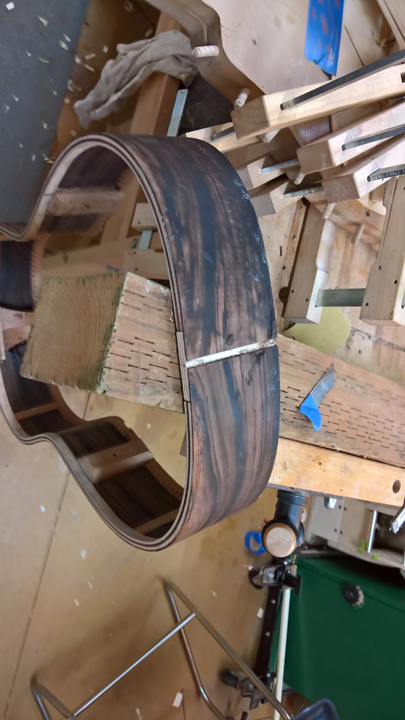

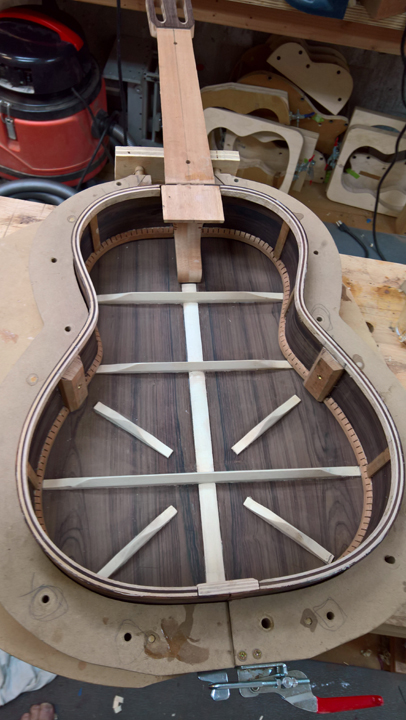

I had to do the final prep of the rims. I notched out a rebate for the lateral braces both back and top. I use a pencil mill grinder. I also notched cut out a rebate for the end graph. I just used a scalpel to mark out the cut and a razor file and chisel to cut and clear the rebate. I have some Petros Guitar shop Purflex that will match the maple purfling on the bindings and the ebony binding that I will use. I will install the purflex after the binding. Before routing for the bindings I wedged in a strip of ebony so that I had a smooth surface for the binding machine to register.

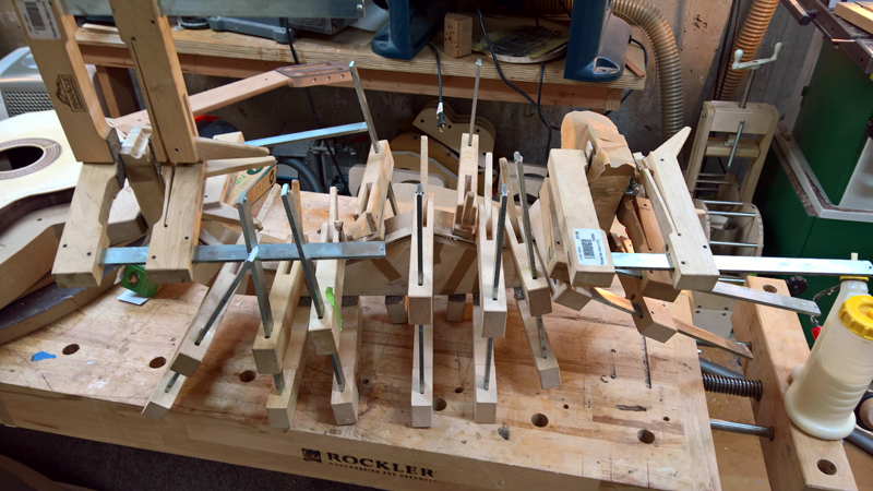

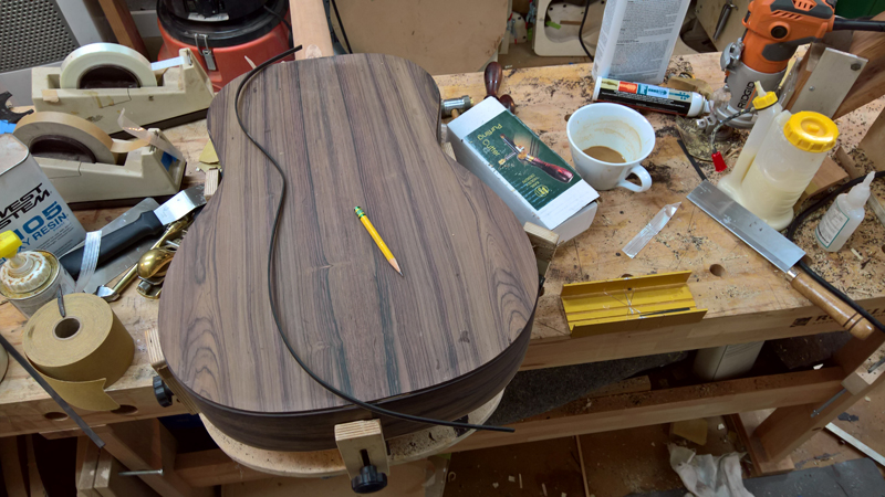

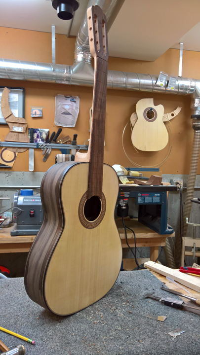

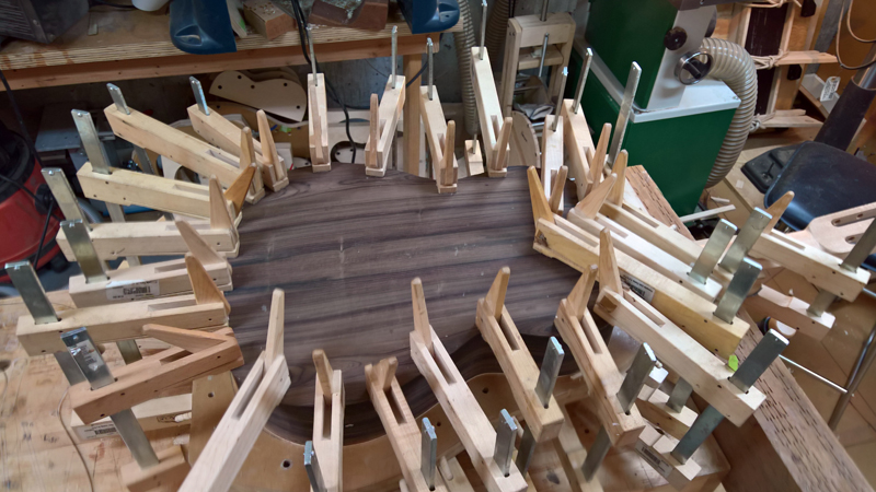

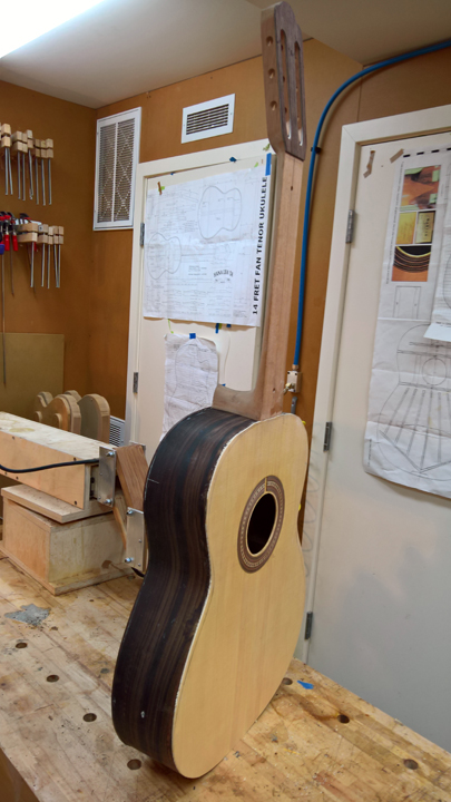

With everything ready I started closing the box. I glued the sides to the top with the neck clamped to the solera to force the correct neck angle. The angle does not rally get locked until the back is glued on is well with the top and neck still clamped the the solera.
Before clamping the back I cleaned the inside of the guitar again and routed the over hang of the top flush.
The back fits on nicely so I clamped it on as well, again note that the neck is clamped to the solera to force the small forward angle of the neck.
All cleaned up
next the bindings

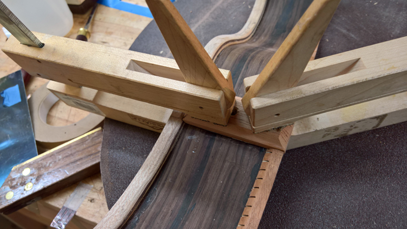

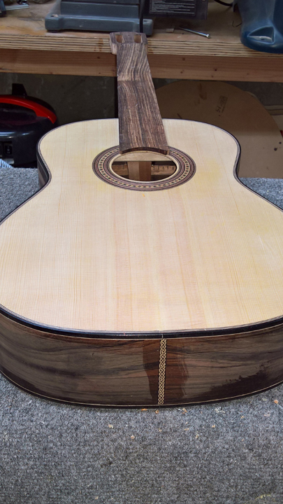

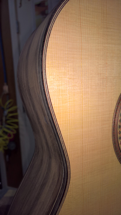

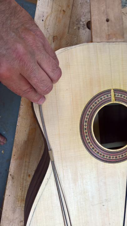

The back bindings are simply ebony with a maple prufling. The top will have a multi-line purfling to give it that traditional classical look. I tried adding some red and green lines from the rosette but I just could not do it. So I ended up with a black, rosewood and maple stack that I will install.

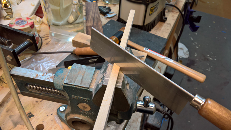

I carefully set and test the binding jigs cuter depths and routed the back for the bindings. I had a bit of chip out right on the outside curve of the upper bout. It was about 3/14 inch deep and an inch long. I found the pieces but it would have been a mess to put back together. Luckily I had the cutout from right next to the chip out. I clean the chipped out area straight and square with a chisel and glued on a small strip. Sorry no pictures of the damage but here is a picture after the repair. The repaired area is right over the chisel handle
The biggest pain for spanish neck joint guitars is having to install the bindings with the neck on. I start with a scalpel and a template to continue the binding line. I use a purfling cutter to continue the cut on the sides. I increase the depth with a razor saw and clear the waste with 1 mm and 2 mm chisels. It is a real pain.
The test binding seems to fit.
After that it is just a matter of trimming the bindings and installing them. I used a scarf joint for the bottom and a butt joint for the top. When working with a scarf joint I install the binding with inward cut first. That gives me a solid notch to insert the second binding into. I am really able to push it tight that way.
Next up is the top binding.

johnparchem wrote:Sorry about the previous long posts with pictures. I will break up todays into a few posts.
Cutting the slots in the UTB is indeed a pain in the proverbial. What I do is cut the slots for the ends of the primary braces before the two soundhole braces are glued in. I make the sound hole braces a bit lower than the ends of the primary braces..this way once the former are glued in I can fit the UTB over the ends of the primary brace ends and then mark the cuts for the soundhole brace ends. I generally end up with a better fit of the UTB over the four brace ends.

You say you are using 10 mm height for the falcate mains. This sounds quite high. Is it something you have calculated from the rather fearsome calcs in the book?
Good luck with the continuing build.
johnparchem
Posts: 557
Location: Seattle
Re: Completely traditional looking Hauser style classical guitar
Post by johnparchem » Tue Sep 13, 2016 6:50 am
Thanks Martin and Dave,
Actually for a classical guitar I find that 10 mm is on the low side for a classical where the T(1,1)2 is higher than 190 Hz. This my 5th classical top. On my first I thought that the falcate braces could be lower due to the lower load. My first thought turned out wrong. The Gore medium sized SS is braced with 7 mm or 8 mm with a target of 170 or 180 Hz. The lowest target for a classical is 190 Hz up to 220 Hz. Using the Book's vibrational stiffness parameter values, I find a classical spruce top in about .4 mm thinner than a steel string. So the thinner top will tend to lower the T(1,1)2 of a top but I want to go higher not lower. I do get a little back as the classical is a smaller guitar but I still find I needed taller braces. So I picked 10 mm.
I need to start playing a bit with the secondary brace height as I am finding they do have a big affect the tops resonance. Looking at the closed box numbers I think this guitar will be right at 190 Hz. It is 1 Hz higher than my last classical at the same stage.
johnparchem
Posts: 557
Location: Seattle
Post by johnparchem » Tue Sep 13, 2016 6:54 am
johnparchem wrote:Thanks Martin and Dave,
I am not quite sure at this point as I do not have enough experience, but I am finding as a first approximation that the vibration stiffness parameter values basically normalize the effect of the top between classical and SS of close to the same sized instruments and the target resonance can be controlled by the brace heights. If I wanted a classical at 170 Hz I would go with the same brace height I used on the SS to achieve that resonance.

Post by johnparchem » Fri Sep 23, 2016 3:12 am
I finished the bindings, added a scrap piece of purflex for the end graph and have started finish prep.
I still need to make a bridge.

Post by kiwigeo » Fri Sep 23, 2016 10:20 am
All looking very nice John...

Post by demonx » Fri Sep 23, 2016 6:41 pm
Looking GREAT so far!
Bit jealous of the vacuum press!
How did you find the purflex? I've wanted to use it for a while now but no one seems to order anything lately that it would fit into the theme!
