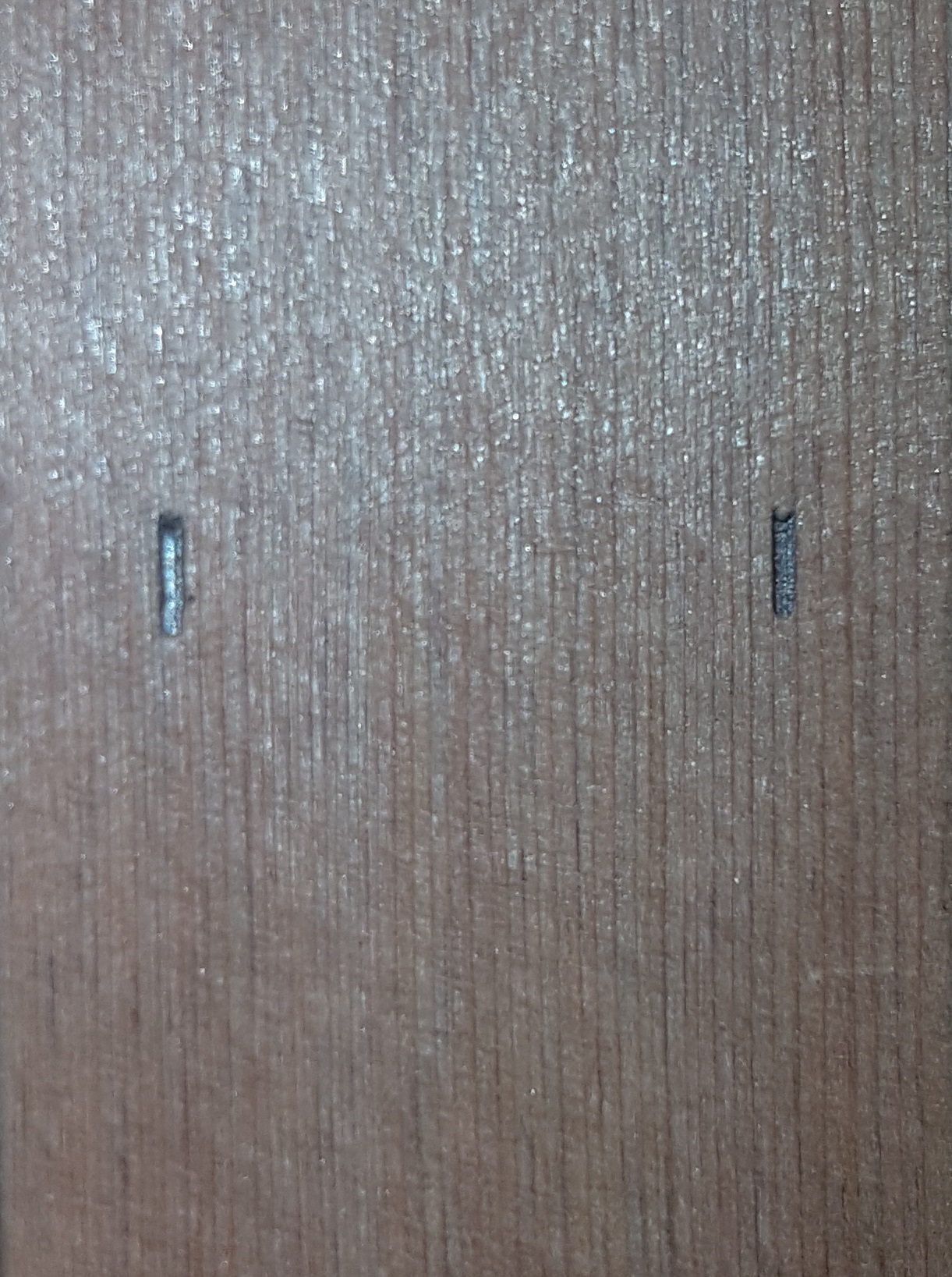

Picked up a piece of Huon Pine yesterday thanks to Bob, i took some pics of an off cut from the billet and going by the growth rings on it the 85 mm piece took about 225 years to grow so,,,, if the tree was about one meter in diameter that makes it about 1240 years old when it died,, Wow!!! hard to tell but it was probably much older than that!!
closeup of annulars, black marks are 10mm apart
70 to 90 mm shows the sapwood and bark.

Pretty awesome stuff I tried counting one and gave up :lol: I had access to a stereo microscope where I worked I think you guessed rite I also had some old spruce from a pedal organ and it was 1870 according to the news paper used when gluing it together .Here is the trick I had some relativity new spruce say 20 years old and under the microscope you could see the sap wood had deteriorated more in the old so long story short the wood structure was lighter ,more tone ?who knows .

Wow! Don't think I've ever seen a piece of timber with that tight a growth ring pattern. More rings per inch than a Proctologist's clinic!
