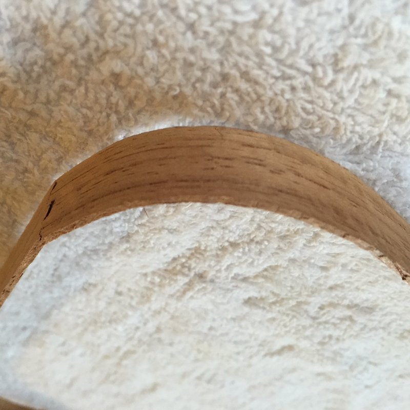

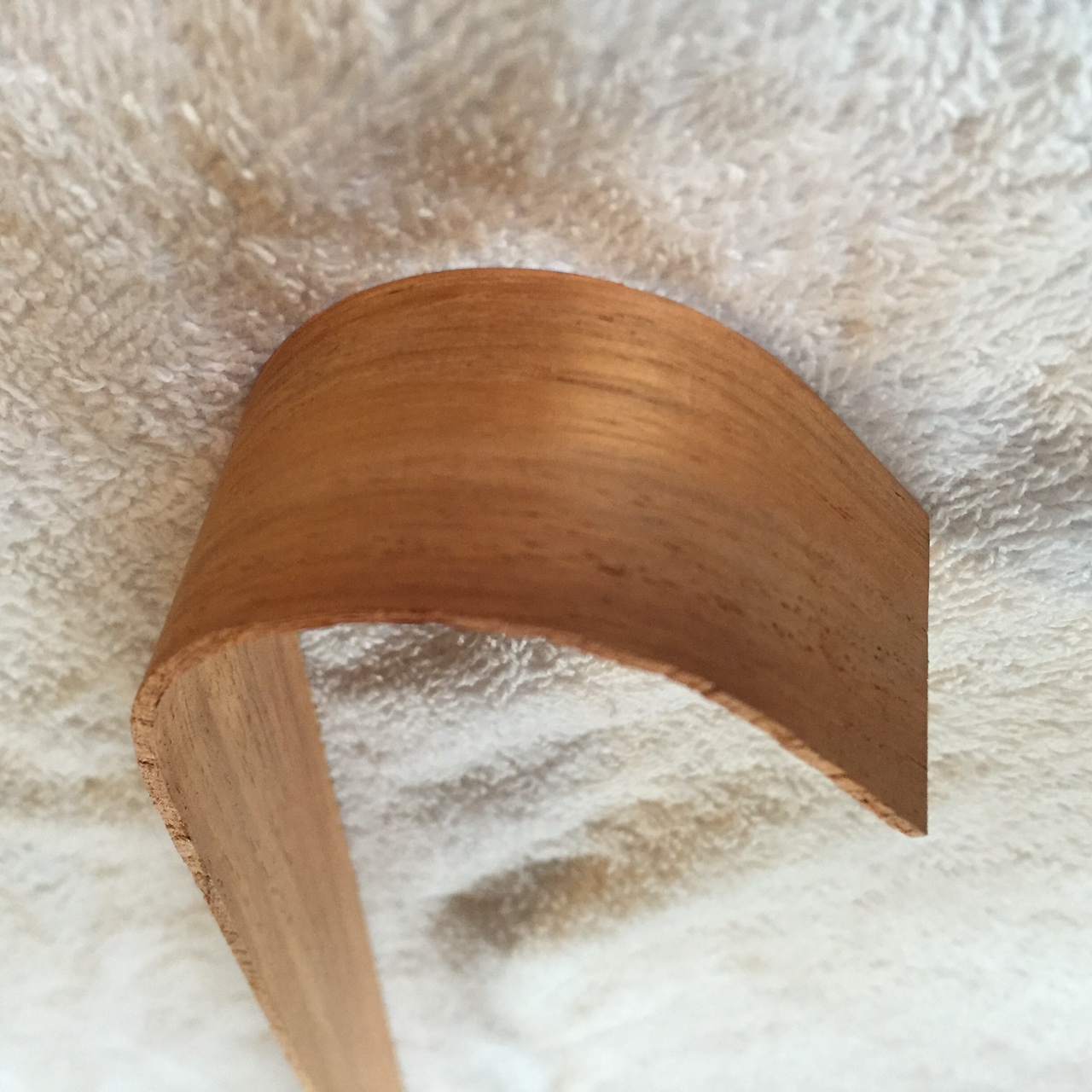

I bent a 2mm thick piece from a different NGR stock after a light spray with water and it was really easy to bend to a tight radius. Iron temperature was closer to 200C. This piece has a much richer colour - rose to orange. I then tried a 1.6mm thick piece from the original stock after soaking it for 30 minures. It was still difficult to bend and did crack a little although I probably could have avoided that if I went a little slower. I used a metal strap. This piece is much browner and relatively pale.
