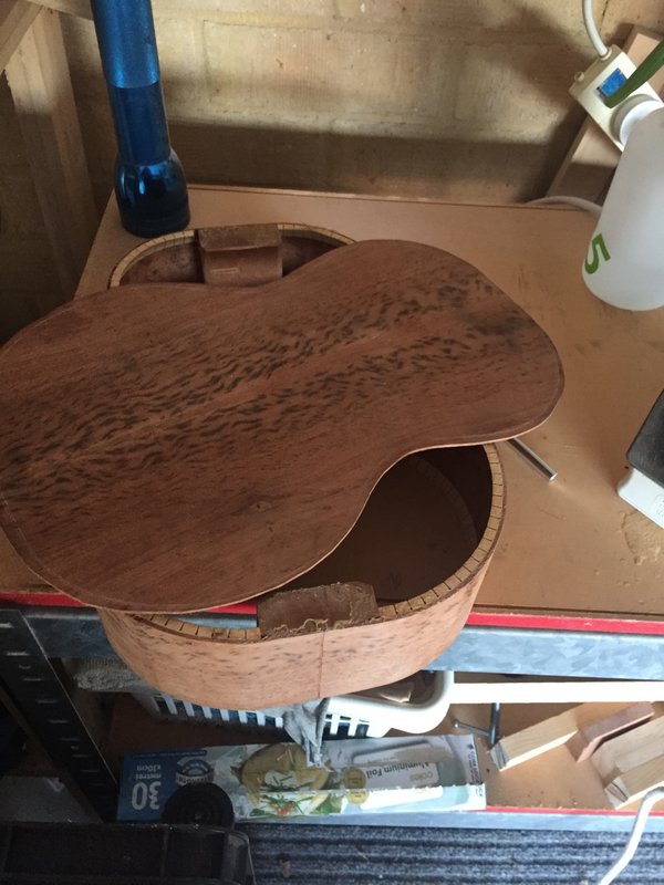

I have glued the back on a ukulele and it has slipped during clamping that I didn't notice and now the Centre line isn't lined up with the body. Is there something I can do? Was glued with Titebond

Heat will loosen titebond.

I have an old unused steam iron, will this work for ungluing? What kind of temp will I need to get the glue to?

Steam will swell the timber and raise the moisture content of the wood. Soundboxes need to be assembled with lower moisture content in the timbers than the instrument will be normally played in, within reason. Most makers assemble at 45%RH (relative humidity) which gives around 8% moisture content within the timbers. Soundboxes can swell and contract as moisture content rises and falls, but if the moisture content in the timbers goes lower than the assembly RH, the result is that the timbers usually crack-something has to give. It usually happens if there are joins in the soundboard or the back and at the waist at the edges in my experience. Braces can also let go, or if they don't they can split as the doming in the back or soundboard flattens out. I use steam to re hydrate instruments that need repair after being exposed to extreme low RH, eg. left in a hot vehicle in a black case in direct sunlight, or for de-wrinkling my linen suit prior to a summer's gig! To re hydrate sound boxes I introduce a little steam into the sound hole(s) then plug or cover the hole(s) so that the moisture will stay in the box while the wood absorbs it. Just do it a little so as not to get condensation in the instrument. I then put the guitar, uke or whatever in a plastic bag so that the air inside and out has a high RH. Lightly built instruments require extra care not to re hydrate too rapidly. Instruments don't like sudden extreme swings in moisture content. So gentle as she goes, err on the side of caution. Steam can also be used to bend wood. So NO! Steam is not a good idea for removing a glue join on a soundbox. It can be used, however to remove a neck join for a neck re set. In some cases iron can be used with a damp cloth to swell dings in timber as well. You can search this forum for info on neck removal, RH, dehumidifiers and methods, soundbox assembly and timber conditioning. Also there are some good tutorials on You Tube re these issues, especially on neck removal/neck reset work, and good info if you google on all sorts of luthierie topics. With a uke, the backs are usually pretty thin, unless the instrument is totally underbuilt. So a gentle heat gun or a hairdryer will probably penetrate the wood enough to soften the glue on a uke along with the judicious use of a heated knife. Just don't heat too much or you will soften the glue where the liners meet the sides as well and also the glue holding the braces if there are any. That's why I use aluminium heat shields and slow heating just enough to penetrate to the glue I want to soften. If your knife is too hot it will scorch or burn the wood, if not hot enough the knife will need to be forced with the risk of tearing the join, the wood fibres or an even greater disaster! Think glue join only and be gentle, using moderate heat and have a feel for the temperature of the knife and the the softness of the glue as the heat weakens it. It's quite easy if you feel your way.-Ross

Your iron (minus the steam as Ross pointed out!) or a heat gun will do it and also use a warmed up knife or thin paint scraper to get inbetween the side and back plate. As for heat, a medium on the iron and high on the heat gun but make sure you keep both moving over say 150mm of the joint at a time, don't stay in one area for too long to minimise the chance of scorching (I use an iron but if I was using a heat gun I would heat the area then keep removing the heat away from the instrument, test the joint with your knife then play the heat on it again if it doesn't separate, things can turn to custard very quickly with a heat gun!) . Work around the perimeter slowly separating the joint a section at a time, take your time and don't rush! It should come apart relatively easy once you get the feel for it.
Before re-gluing the back make sure every bit of the old glue has been scraped or sanded off, Titebond doesn't like gluing to old glue!

Careful working around the centre seam.....if that starts to separate then things can get messy. I generally avoid working directly over the centre seam with the heat gun and instead work a hot pallete knife in from either side of the seam around the head and tail block areas.
The trick is to work carefully and gently with the pallet knife. Also work carefully around brace ends..especially if youve housed them into poskets in the linings.

Got it off, slowly slowly, but did it. My old clothes iron and a pallet knife did the trick
