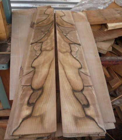

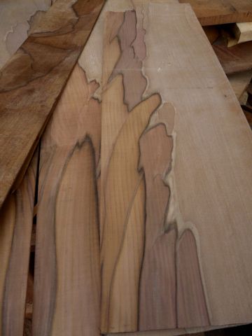

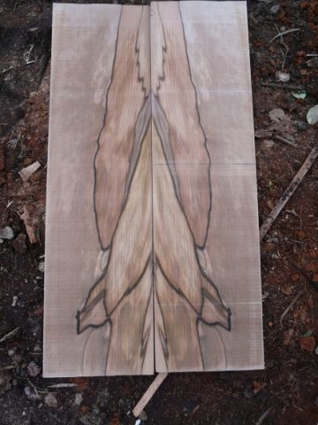

Just a few of images of some Black Sassy that lost the cream due to spalting but retained an amazing pattern.

Beautiful set Tim.
Posts: 1553
Post by ozziebluesman » Mon Jul 14, 2008 10:15 pm
Gee thats amazing figure!
Thanks for posting Tim.
Post by Bob Connor » Mon Jul 14, 2008 10:19 pm
Whoop de doo!!
That's pretty special Tim.

I managed to resaw several sets that have been racked out. All I need to do is let them dry without getting anymore spalting particularly where the rack sticks are in contact with the sets.

Tim, can you explain what is happening to the wood. Does this effect happen as you cut/dry it? Iv'e not heard about this. Can you tell us a bit. Its quite amazing.

Blackheart Sassafras is prone to fungal staining particularly where there is moisture and little air movement. The wood was actually a beautiful cream colour in the areas adjacent to the heart staining. However the fungal activity moved through the material rapidly. If I had any control over the processing of the log it should have been cut when things were a lot drier. In addition if the wrong rack sticks are used then there will be an instant build up of fungal spores. So regarding the sets I have racked out, I will have to check them tomorrow to make sure that they haven't already started to stain given our current wet conditions. Of course if I had a state of the art kiln this may have been avoided.
I hope that made sense.
