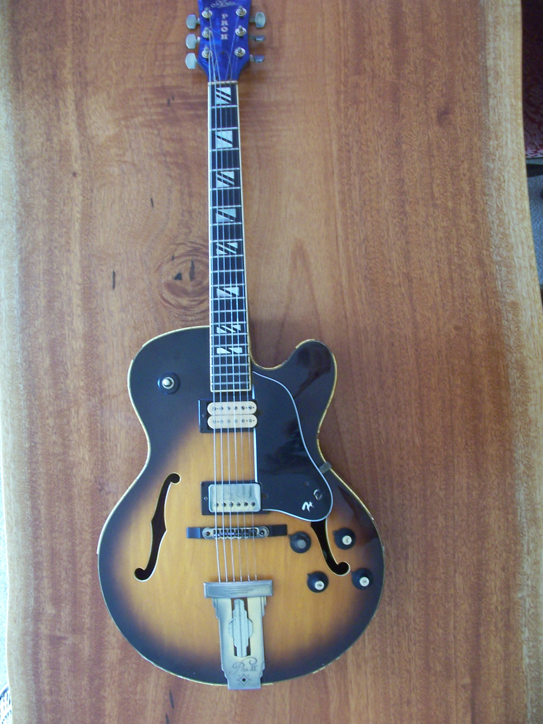

A good friend of mine owns this Aria(pix) - from research it may well be the first ever made. A fall resulted in partial separation of the top - which has been successfully reglued(titebond). A U.S. luthier has recommended FCA ( from LMI) glue for new binding. References are excellent but it can't be shipped here. Does anyone know if avail. in Aus.

The Aria in pik is lying on my maple slab table - 3.3mtrs x 0.9mtr.

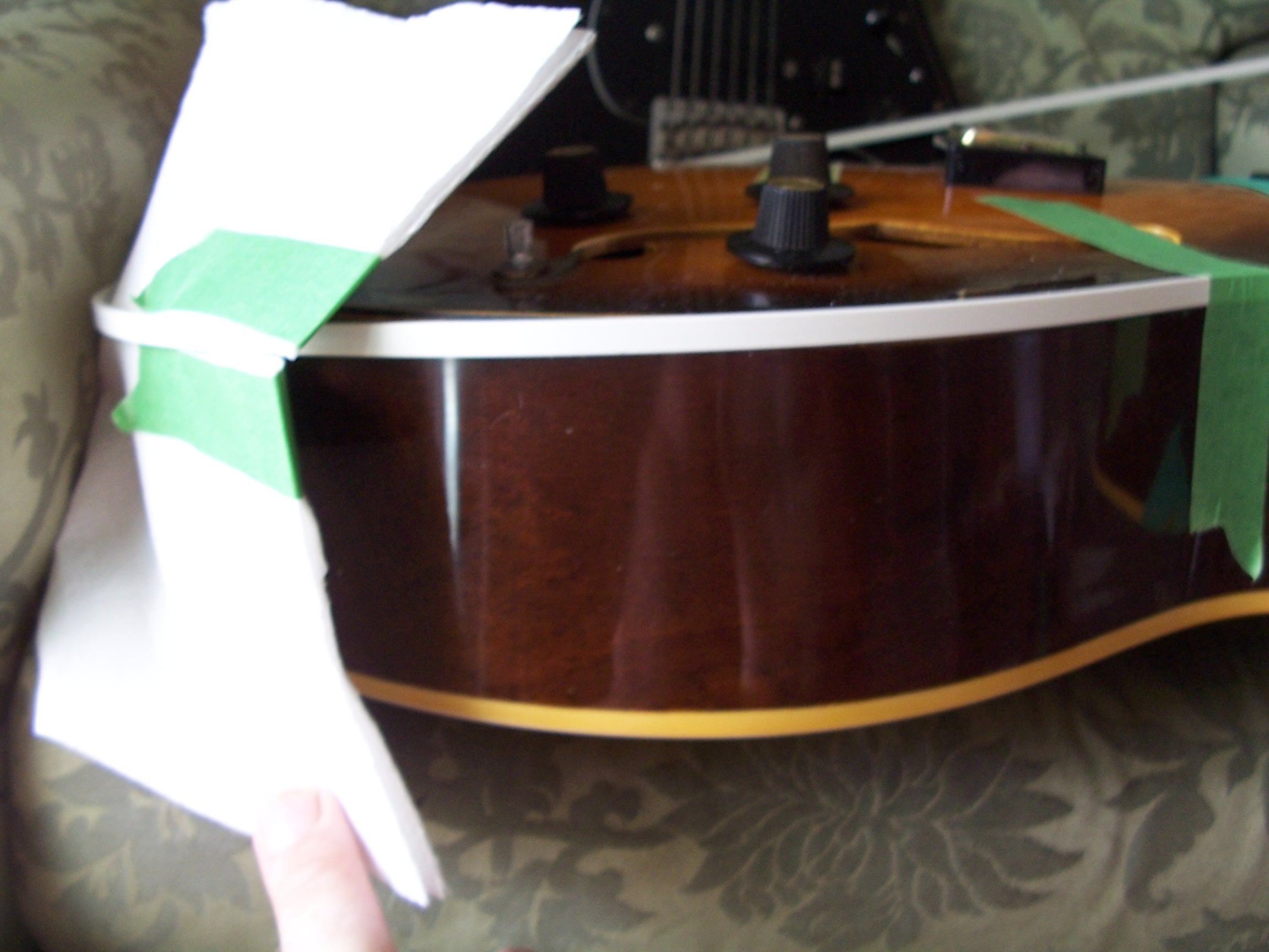

I intend to mask off the finish around the guitar. Hopefully if I'm careful the glue won't bleed under the masking tape. This will also give me a safe level to file the binding to without scratching the finish. I always test before tackling new skills/glues & finishes. Seems I just can't avoid solvents with this repair.

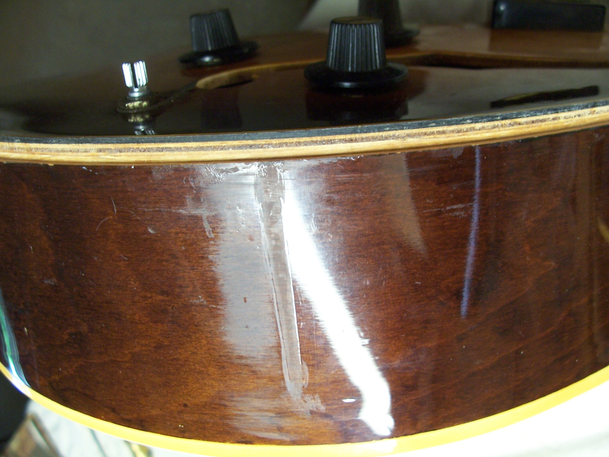

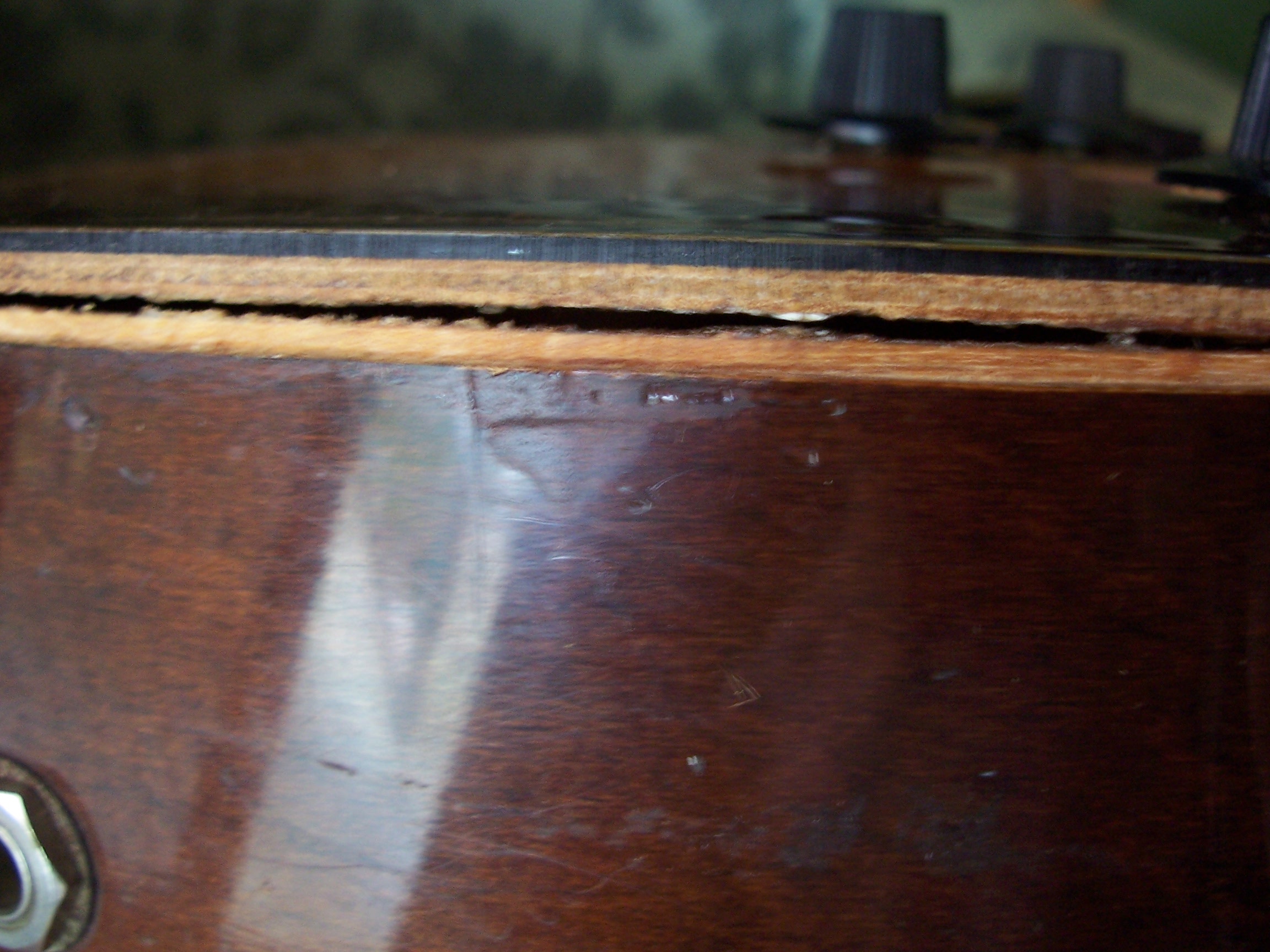

The pix here show where most of the superglue went when the owner tried to repair it after a "mates" advice. I thought it might have gone right thru the lacquer but pik shows the removal very successful. 4 pcs of 2 ply paper towel shown in pik was used as heat insulator - the heat required to bend binding was quite extreme. I will finish buffing the lacquer when repair complete.
Timeline: top pik 1st - bottom pik 2nd & mid pik last.
