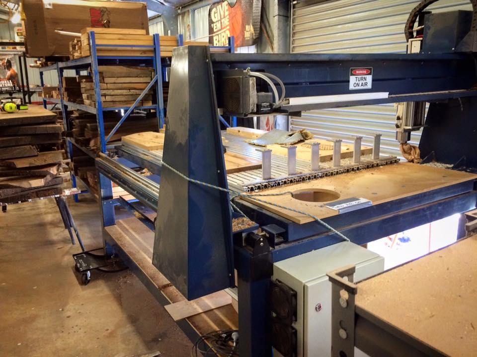

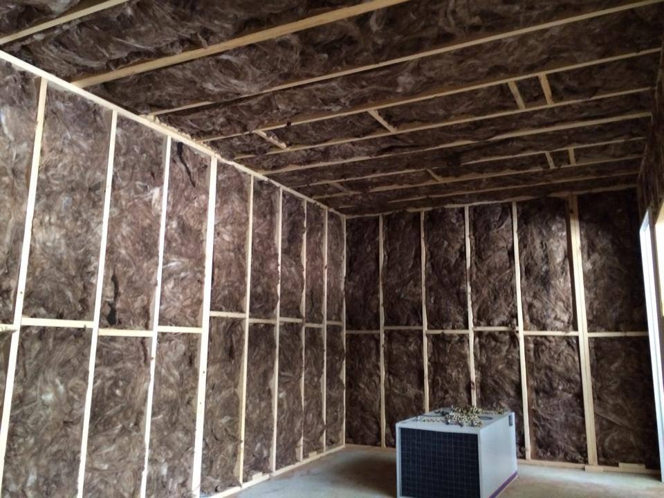

In my current workshop the CNC resided in a 6x3m room that was insulated and had a plexiglass window for people to look through without having to wear PPE. It was also good for me to have it running and I was able to glance through the window to see where it's at.routout wrote:The cnc soundproof would be a nice addition But I have to wear the fact mine is in the same room,seperate spray booth would be a great Idea.
The attached pic shows the inside of the room before I covered the walls.

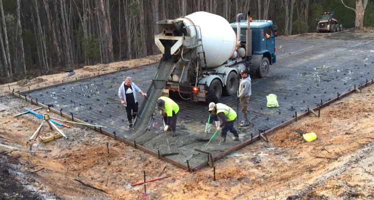

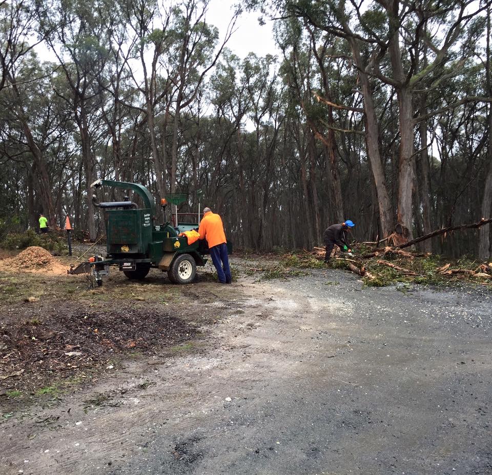

Bit of an update:
Re: Some news + designing a dream workshop?
demonx wrote:Bit of an update:
- image.jpeg (145.91 KiB) Viewed 25364 times

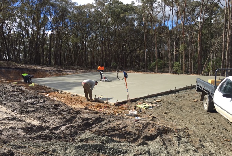

Slab is finshed, in about a week the shed itself will be going up.
- image.jpeg (192.1 KiB) Viewed 25364 times

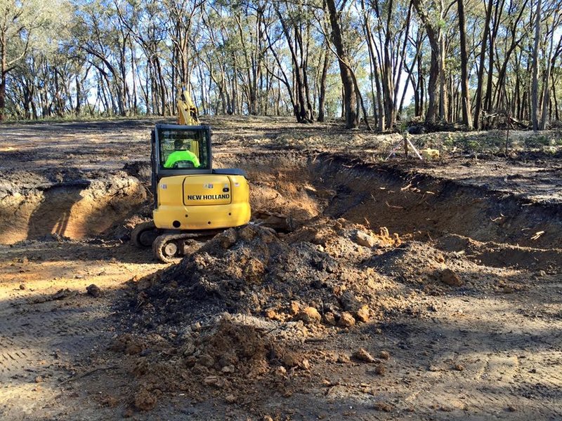

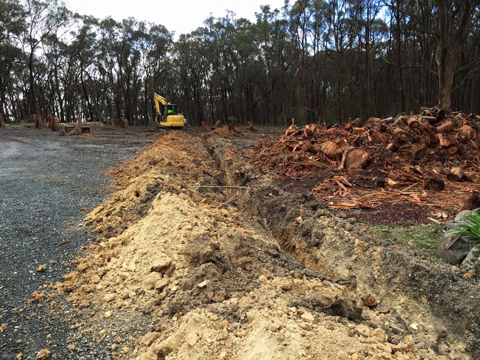

Before that there was tree lopping, excavation and trenching for power
