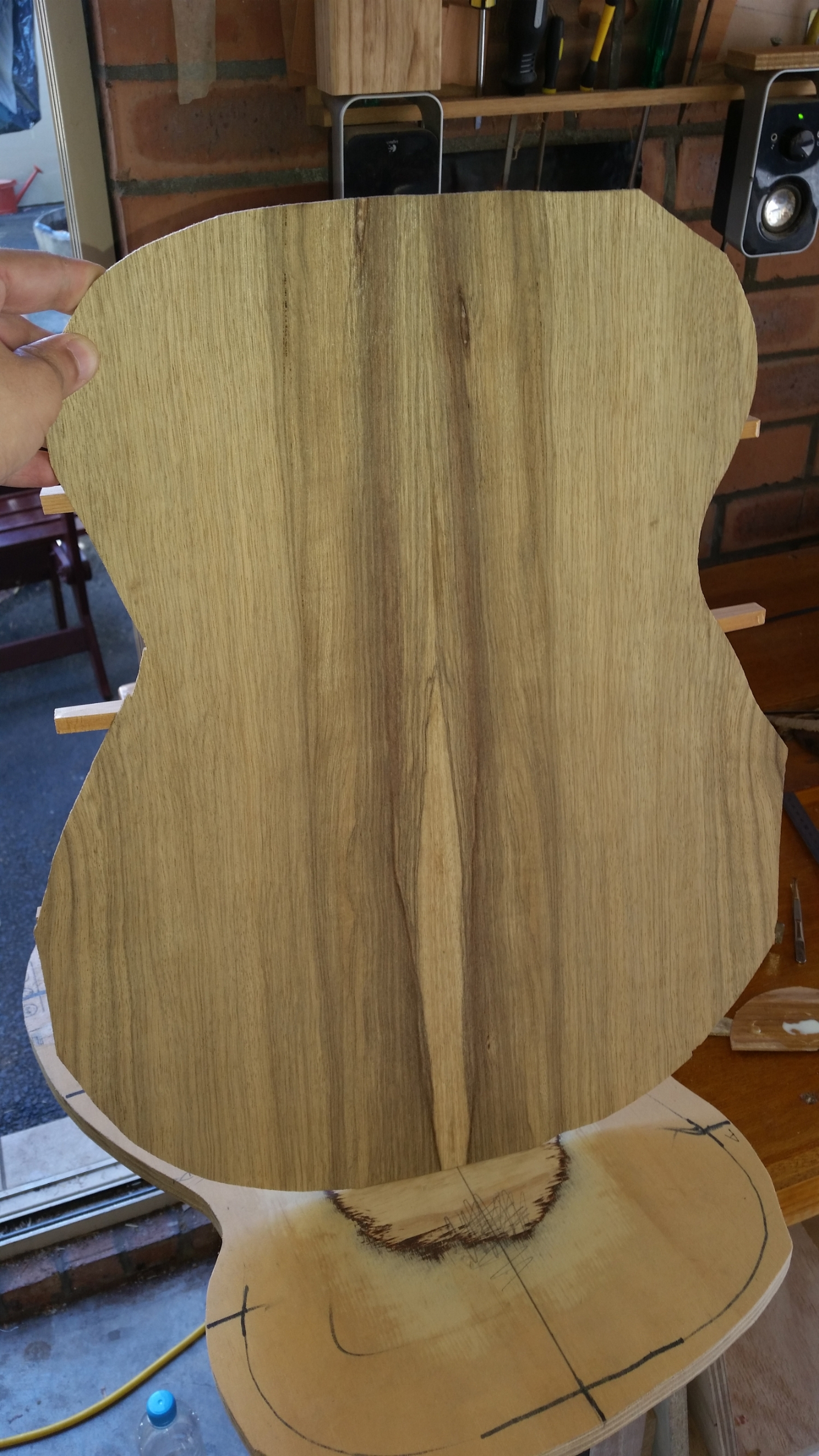

Back strip
Back
Completed back.
This guitar is going to a professional muso and will mostly be used for live performances plugged in - for that reason (among others) I chose a non live back.

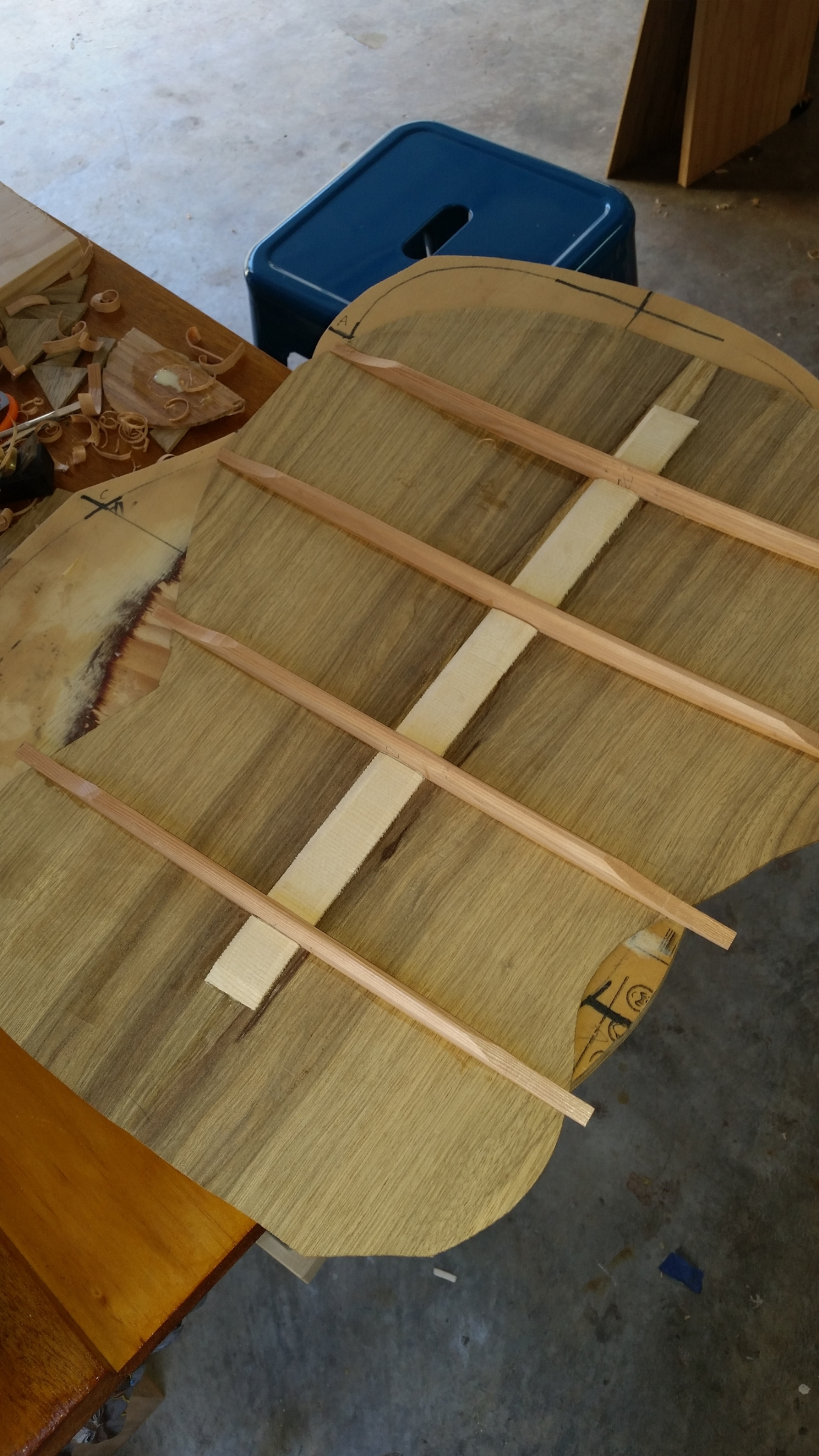

Back braced

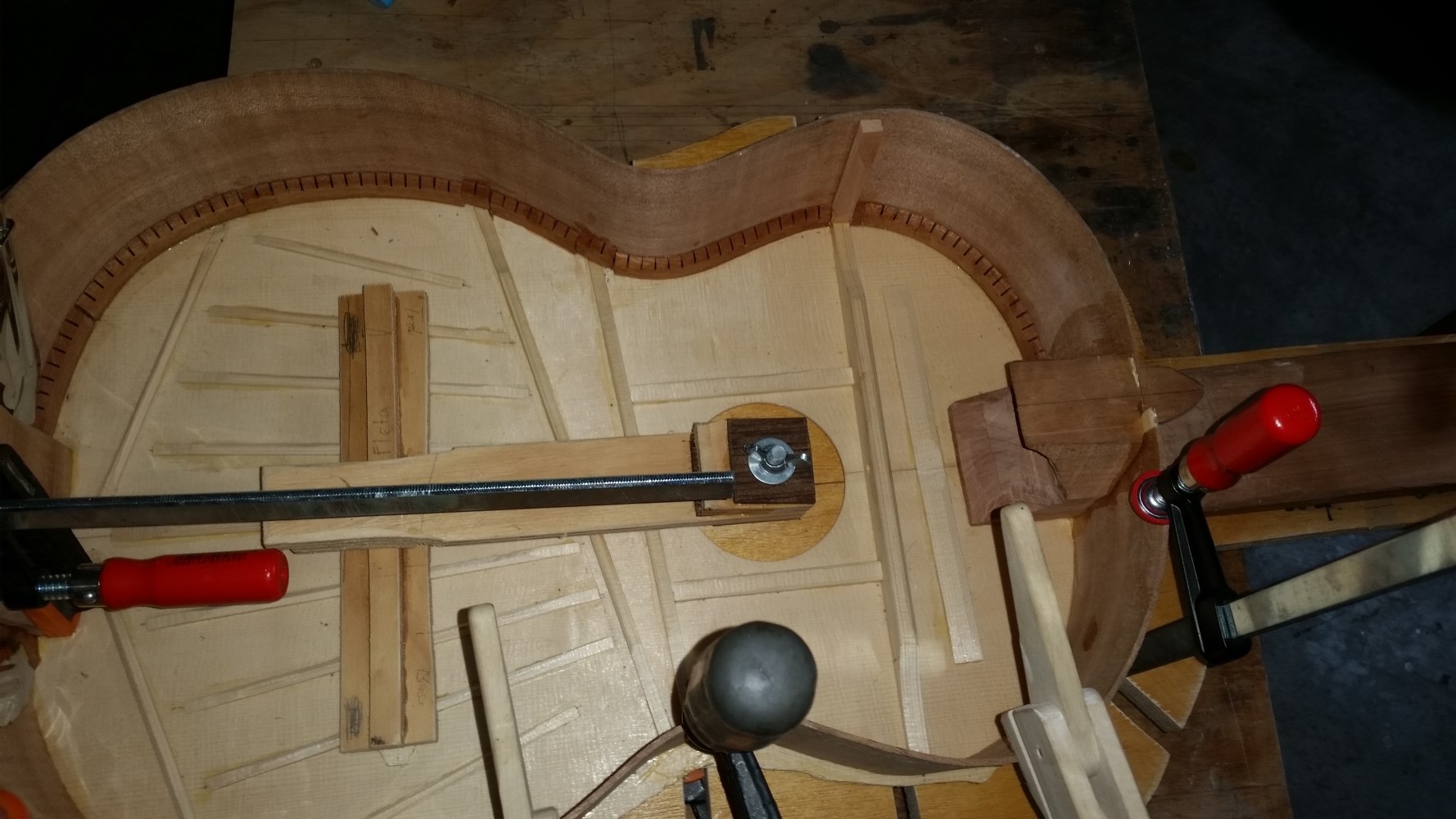

And a sneak peak of where the Fleta build is up to:
Fleta
