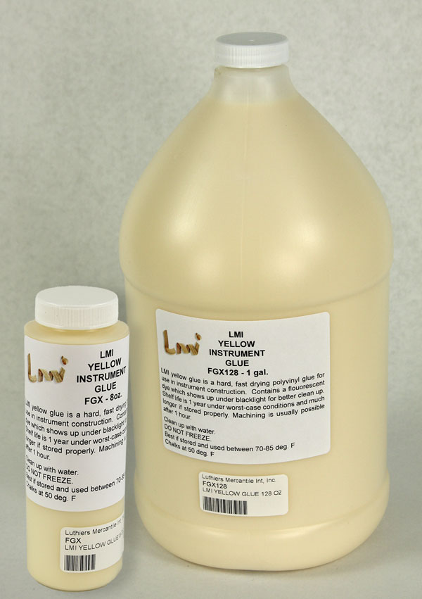

This stuff looks interesting. Looks like they've stopped using the LMI white glue.
http://www.lmii.com/products/finishing/ ... ument-glue
It has a florescent dye which is visible under black light which should make this stuff great as a glue for wooden bindings. I find that some glues are impossible to see until you start throwing some finish on. Depends on the timber but this should speed things up a bit.

I have been using this stuff ever since my LMI white glue passed it's use by date around 18 months ago. It is different from the white glue, and at first I was sceptical, but have grown to like it. It is more like Titebond than the white glue and is a VERY strong glue if used correctly, but is quite unforgiving. It also sands much better than the old white glue which tended to clog sandpaper and my drum sander strips. However, the white glue was more forgiving of poor joints and did dry harder. Get the joint tight with the yellow glue and it won't let go, the wood will break before the glue joint every time. However, any tiny gap and you will likely get a failed joint. I have had one failure and that was mea culpa. There have been a few reports of bad results with this glue, but they are very likely to be user error rather than a problem with the glue.

Bob, apparently the manufacturer of LMI white glue was taken over by another company and they changed the formula without any notification. Some Luthiers were having trouble with the new formula gelling after a short period of time. I never had that problem, but I always stored the white glue in the fridge. LMI was unable to get a solution to the gelling problem, so they abandoned the white glue and it is no longer available. After some months of having no glue available, LMI announced their yellow glue which they claim is an improvement on the white glue and Titebond. Not sure about that, all glues have their advantages and disadvantages, but it is good stuff.Looks like they've stopped using the LMI white glue.
