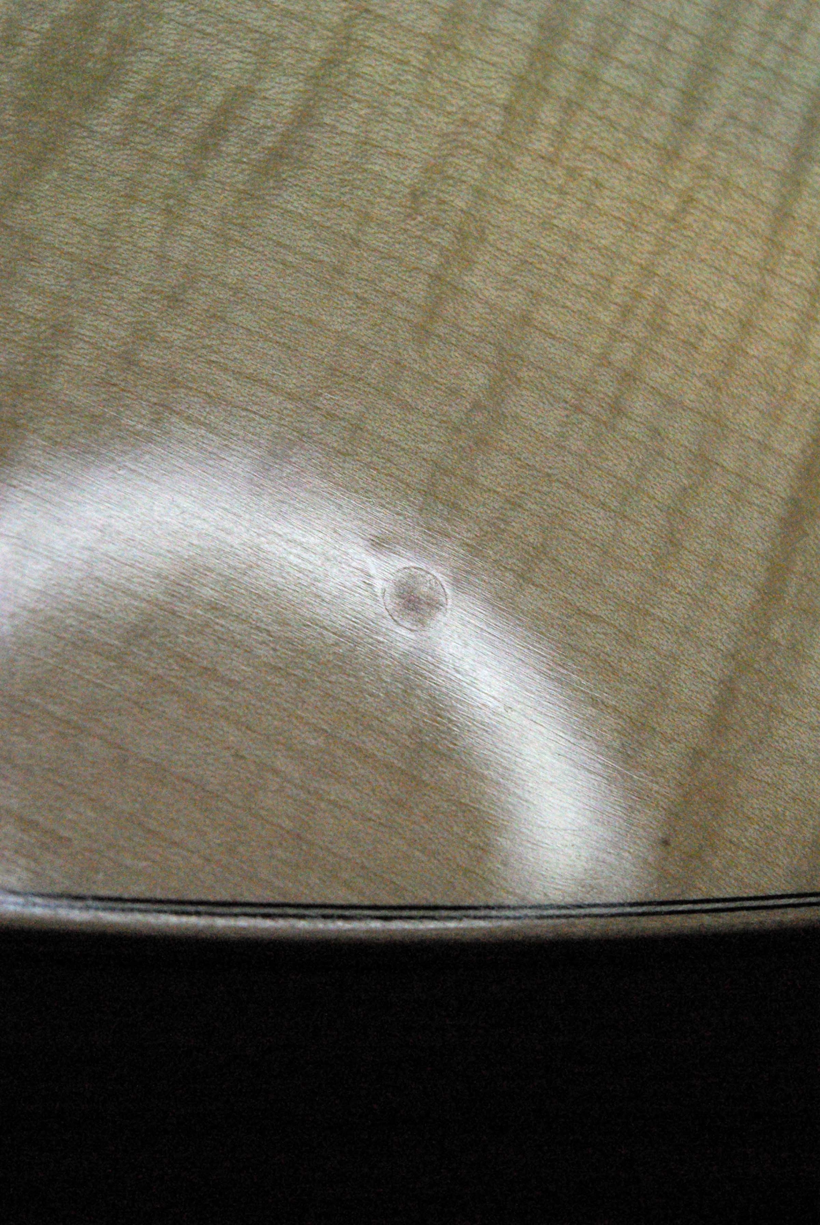

We keep getting told that pretty much any finish will stick to shellac but what about the other way round?
That might sound a bit silly but I am in the situation where I have scraped off a nitro finish because I had a couple of little knot holes that I thought were filled but weren't. I had tried filing these with CA on top of the nitro but spraying nitro over this wasn't behaving. So after sanding clean I put on a couple of coats of shellac in order to seal any ca left around the holes. However spraying nitro over the top is still showing the original circle where the ca was.
So is the shellac failing to cover either the remaining trace of CA or a trace of nitro? Or is something else entirely going on?

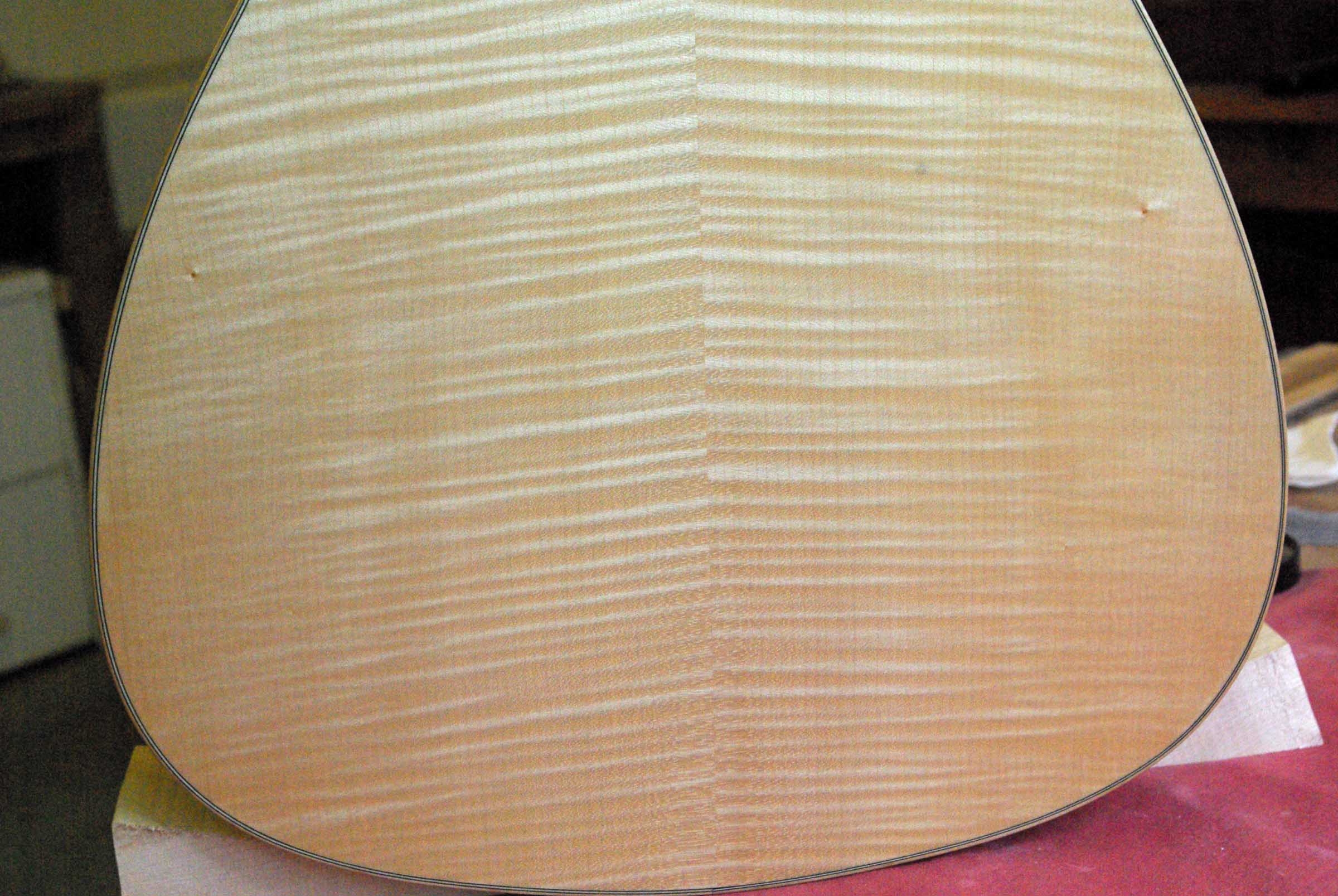

I found I had been daft. When I thought I had cleaned back to bare wood I was actually nowhere near as I found out today when I went to remove it all again - crikey I'd put a lot of lacquer on that back! Anyway I had a mishmash of nitro, CA shellac and more nitro so no wonder it wasn't happy. Anyway today I got it really cleaned back, couple of shellac coats and the first spray of nitro looks OK.
For interest this is what it looked like: and the knots are only small:
I thought they would add interest as little features - next time I shall refuse the timber!
