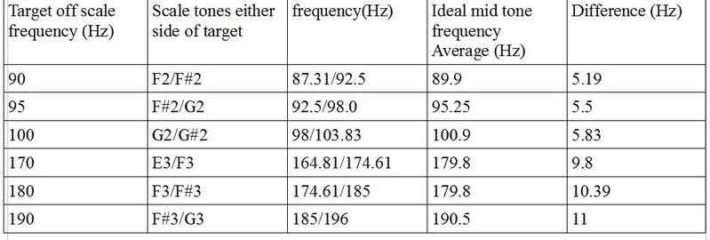

I have managed to get my t1(1) frequency to around the mid point between G2 and G#2 (102Hz) and my T1(2) to 192Hz which is close to the mid point between F#3 and G3. I am getting the very clunky note on G# and pretty much a similar clunk on G. But only really a hassle on the 3rd and 4th frets 6th string, which is G2/G#2. My specific mobility calc gets me a figure of 16.8.
I'm wondering if the bandwidth of the 102Hz and192Hz peaks are a little wide? Am I correct in saying that as the specific mobility rises, the bandwidth (Q) at that peak would narrow? Does this imply that brace shaving would be the best way to adjust the resonance as the resonance could be lowered to say 180Hz, increasing the specific mobility, narrowing the bandwidth to be more specific to a non scale tone and would also repel the T1(1) to a lower frequency which could then be adjusted to where it needs to be to avoid both a scale tone and an octave between T1(1) and T1(2)? Is there a way to modify the air mode bandwidth? Am I completely off track here?????
The following table shows the difference between scale tones at different relevant frequencies and the mid point average of each frequency. I surmise that these mid points are the ideal off scale targets. It can clearly be seen that as the frequency drops, the difference between those frequencies drops implying a narrower range for the frequency to be for it to satisfy the off scale tone requirement, and to my current thinking a narrower bandwidth for that frequency is needed for that frequency to not overlap onto the adjacent notes and cause admittance problems. Comments and advice please.....

G2 is at 98Hz and G3 is at 196Hz, with your T(1,1)1 at 102Hz and T(1,1)2 at 192Hz. Play G2 on the 6th string and the first two partials are both in close proximity to resonances, which is likely why you hear some wolfiness around there. Classical guitars are particular prone to this as 100/190Hz is where they naturally fall, with the problem exacerbated by the thick plastic 3rd string. Wolves are never very far away on high mobility guitars. Choosing 100/180Hz helps avoid hitting two partials of the G quite so hard. However, I think it's going to be hard for you to get down there (180Hz), made more difficult due to the low radius top curvature (20' vs. ~33', which is what I use). Wolf notes are often much more evident to the player than to the audience, if that's any consolation.
