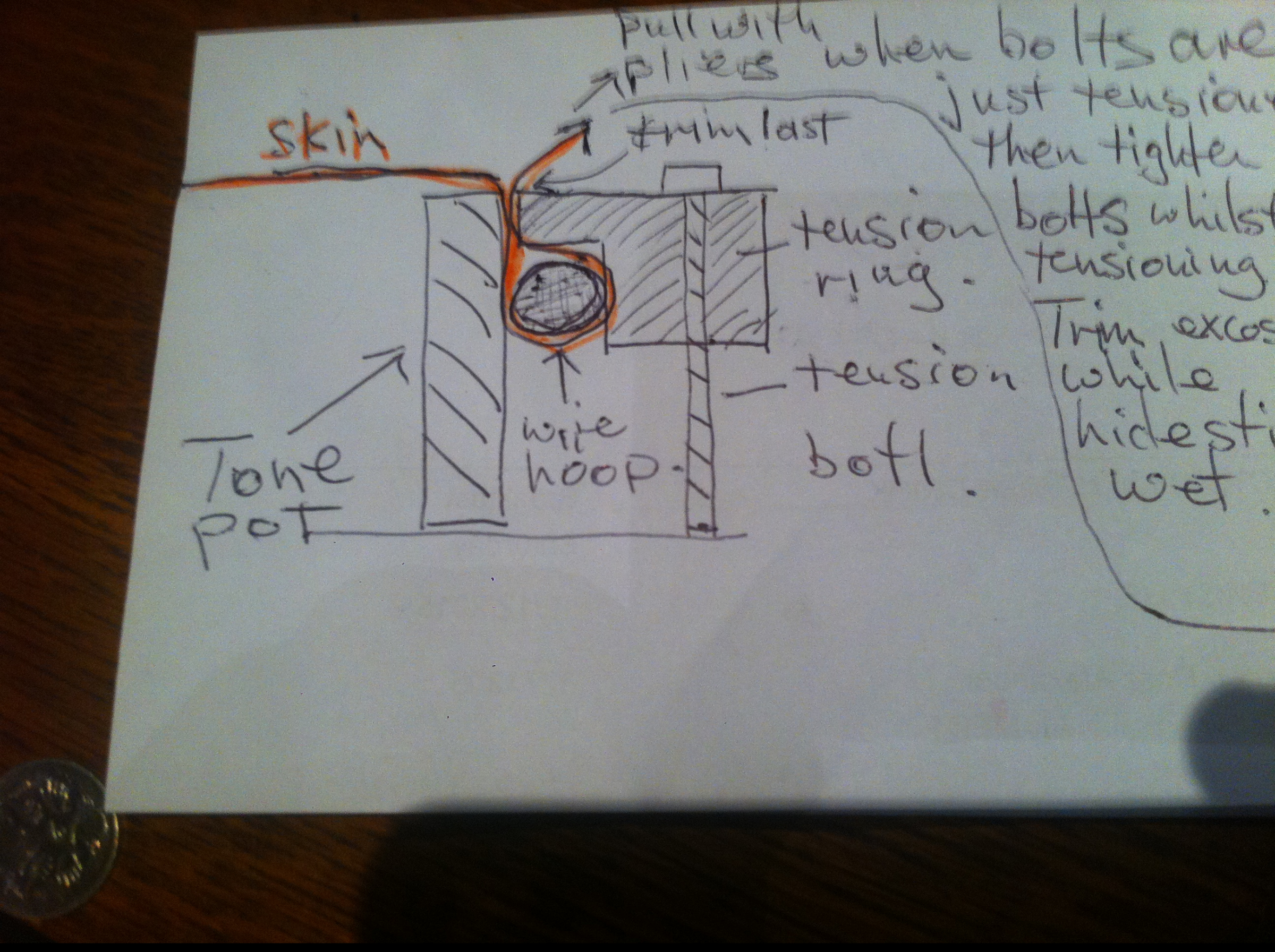

I did a banjo mandolin recently. These old instruments are not exactly standard sizes. There are some calf skin heads pre formed around wire hoop of different sizes available from places like Lamberties in Melbourne, or maybe Paytons in Sydney. Also Australis music, perhaps...
The instrument I worked on had a tone ring and a wire hoop. I used green kangaroo hide, stronger than the usual pig or calf skin, and more even along and across the grain. I wet the hide and stretched it on to the rim with the hoop in position, bolted the rim on, then pulled the soft wet hide as tight as I could with a pair of pliers while tensioning the rim down. Then I ran a knife around the greenhide that was sticking out of the rim and cut it flush.Easier to cut when wet.I then waited till the greenhide dried and shrank resulting in a nice tight drumhead.Hope that makes some kind of sense... the trick if you don't use a pre formed skin, is to wet the material so that it will stretch then shrink when dry.If you don't want to tackle the problem yourself, try a banjo maker.. there are a few around, freight for a small instrument via Aus Post pretty reasonable.
