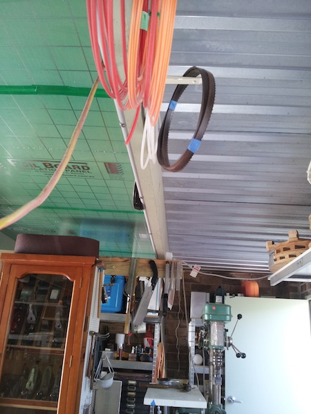

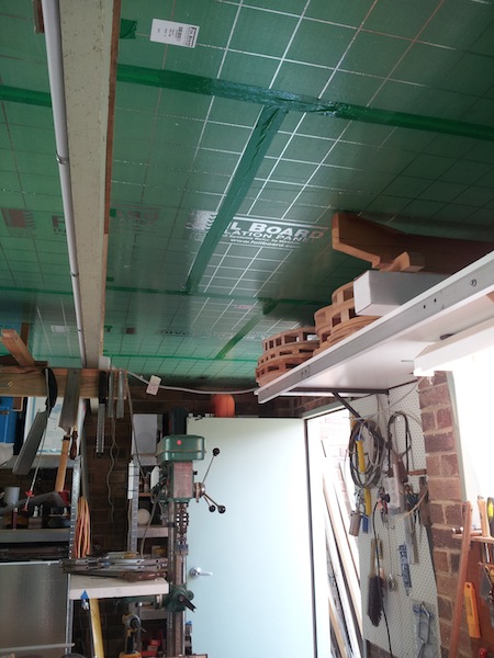

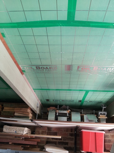

Post by rocket » Sat Jan 02, 2016 5:44 pm
I've been at the new place for a bit over two years now and the workshop is still a work in progress, basically a double brick garage with a metal deck roof. I decided to insulate the ceiling using CSR super 15 foil board, supported by a timber trim the foil board sits between the rafters leaving a void of 10mm between it and the deck roof, very effective light weight insulation.

Post by demonx » Sat Jan 02, 2016 6:42 pm
A little bit of insulation goes a long way! You'll notice a great difference.
This year will be a workshop move for myself also, building a new one that will be over 200 sqm. Insulation in roof and walls is a must!
