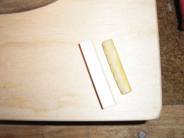

I ordered some of the vintage stuff from Stew-mac. We'll see how that
looks. I am trying soaking a polished nut in some strong black coffee and
I'll post some pics when done...

Post by Dave Anderson » Thu Jul 10, 2008 1:16 am
OK , here after 15 mins. soaking in coffee, are the results...
The "Coffee Nut" is on the right. Looks good to me !

Post by Hesh1956 » Thu Jul 10, 2008 5:43 am
Well Dave I feel funny being the one to tell you that your nuts look great....... :D
