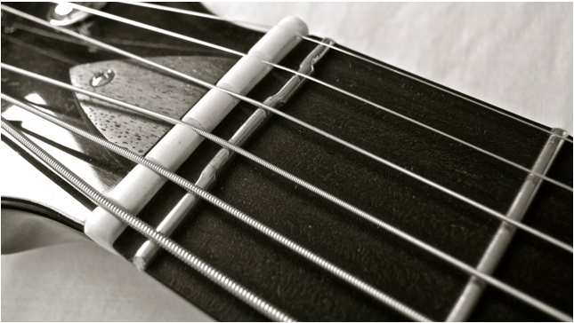

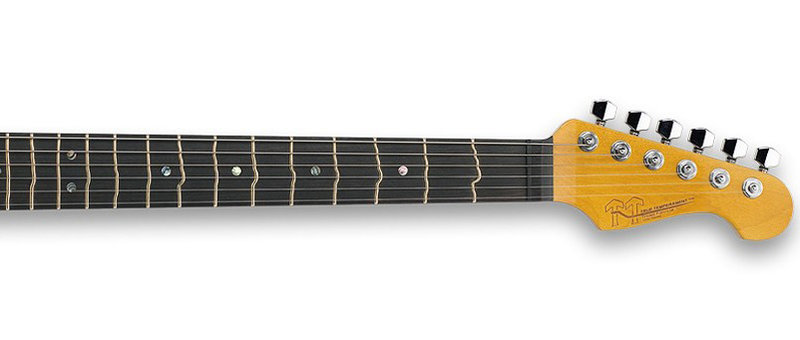

I have seen this picture of one by Nigel Forster ]
- J.F. Custom
- Posts: 778
- Location: Brisbane
Re: does mass of the nut matter?
No Mark - no personal experience here.
Was just commenting. No reason you could not do it, but what a pain to do! As that picture demonstrates...
Could be worse.......J.F. Custom wrote: Was just commenting. No reason you could not do it, but what a pain to do! As that picture demonstrates...![]()
