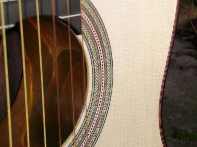

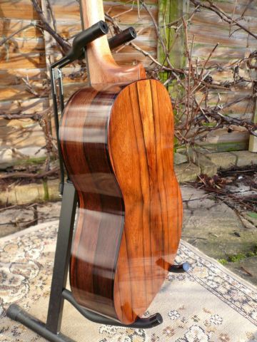

Here is my Torres copy 'La lena' (complete with tornavoz!) that has an oil finish.
Colin
