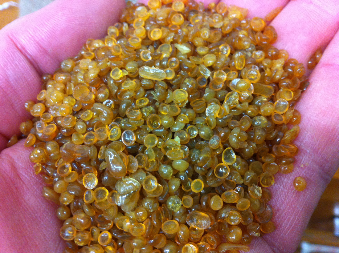

Re: Glue ?¿?
The Davis company in the auscab's photos is located in Christchurch, New Zealand...my home town. Apart from being famous for contributing to the pollution of the Heatchote River they are also famous for their cooking gelatine.mickeyj4j wrote:Are you serious?¿?matthew wrote:Oh and to the original poster ...
