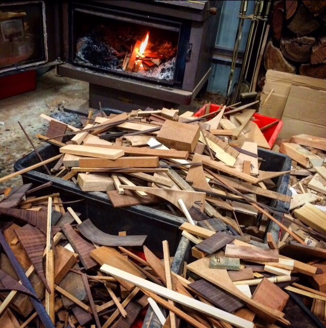

I've never used Bote Cote, but it sounds like temp to me.
I've had the same thing happen with both West Systems and Z-proxy. Anytime it's coldweather I need to have the woodfire going to make sure the temp is comfortable enough (minimum 15 deg+) for these things and any paint products I may be working with. Twenty degrees is a ideal temp to aim for.

demonx wrote: Anytime it's coldweather I need to have the woodfire going to make sure the temp is comfortable enough....
Hope you've got your firewood and tonewood clearly labelled :shock:
demonx
Posts: 1395
Location: Ballarat Victoria
Re: bote cote
Post by demonx » Mon Jun 08, 2015 9:29 am
If it's on the floor, it's probably firewood!

demonx wrote:If it's on the floor, it's probably firewood!
Good God man....there's IRW pieces in that pile...I can see at least 3 bridge plates!!!!!
It burns well!
I've got box fulls of the stuff piled up that's bigger pieces, too good to burn, these piles are the smaller rubbishier stuff that just piles up, when you're cutting timber every day you really run out of ways to re use, I sell a fair bit off but even then only so much can be sold off, so these boxes are just kindling. Every day though I'll be looking for little bit and pieces for something and I'll rummage through the kindling, but at the end of the day, this is all just firewood. For example, the bridge plate on my latest build came from this pile! The sound hole reinforcement came from this pile
