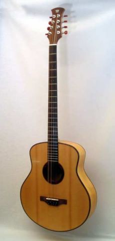

Here is a new zouk I have built to take to the US next week for ZoukFest in Santa Fe NM and the GAL convention.
Sitka soundboard, Huon pine body, Qld maple neck, ebony fretboard and tiger myrtle rosettem bindings and head overlay

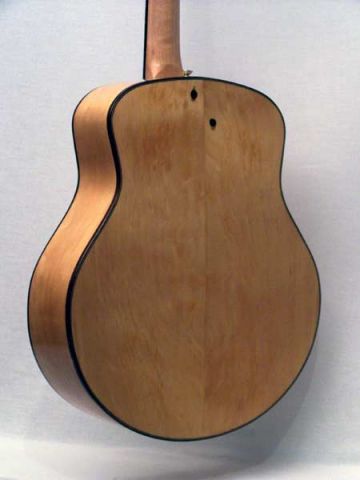

and the huon backImage

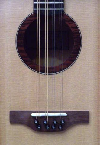

and a detail of the rosette and bridge

Thats a fine looking instrument Graham, Im, sure it will be appreciated by the American audience.
Ive noticed you have been using more guitar derived shapes, I assume the reason is playability. Lattice braced?

The body length and width is almost the same as the teardrop shape, with the upper bouts added. It took a while to get the proportions right (at least in my view) and it does make it easier for the instrument to sit on the leg :D
Hybrid X/lattice braced

A beautiful looking instrument there Graham. Very tastey.
Posts: 5259
Post by Allen » Sat May 31, 2008 5:46 pm
Really nice looking instrument there Graham. I especially like the the body shape, and the stripes in the soundboard look really good. Gives it heaps of character.

That's a really nice looking zook and I bet it sounds great. really nice lines and wood choice. Good luck in the US.

Beautiful looking instrument Graham . Very appealing shape and the myrtle bindings really suit the Huon. Very cool rosette too ! Congratulations on completing yet another fine instrument. :cl

Looks great Graham.
What scale are you using on that?

It is a 26" scale, the 660mm long classical on the Ibex fret ruler. I tried to keep the weight down as much as possible, so only two bolts through the hollow neck block. The Huon was a bit of an experiemnt, just cause it looks so cool, and smells wonderful through the soundhole

I like the neck mount!
Don't see thru bolts on acoustic instruments much!
Nice work Graham!!

Great looking instrument, I love that crisp looking soundhole/rosette detail. Well done. I sent a mandolin to the USA recently, great feeling. I thought is would be like sending coal to Newcastle, but it apparently got a good reception.
