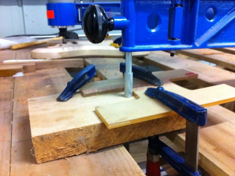

The first thing is, if you have a duplicator machine, then use this for a straight out copy, they are one of the best things in the world IMO, they allow you to match exactly the shape provided you take your time using them
I have a gemini unit, and highly recommend it to anybody
http://wood-carver.com
you can also make simple versions of these as well if your up to trying, they really are a great tool in the lutherie world IMO

Side topic, I used to own a Marlin, a more expensive version of your Gemini. I rarely used it and sold it to some arch top luthier in QLD. I found the process way too slow and often to just hand carve instead as it was so much faster

The only thing I was using it for in the end was cutting angles into neck pockets, but I found an easier and quicker way to do that too so the machine was just sitting there taking up a lot if space (was about a 5ft x 5ft as I had an upgraded (oversized) version

Yes the duplicators take up a lot of floor space,

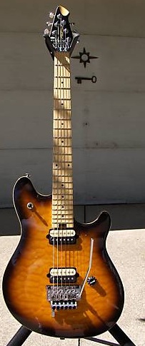

We have a neck to be copied, the customer wants the same profile but shorten slightly to accomodate a bone nut rather than a locking nut
On close inspection it appears symmetrical and clean, couple of flat spots on the rear which could be contributed to player wear
We are copying a peavey neck, this is a generic internet photo

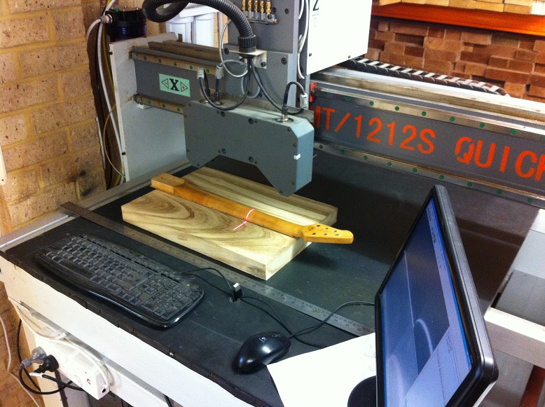

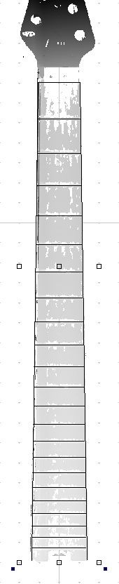

Post by simso » Sun Sep 21, 2014 6:33 pm

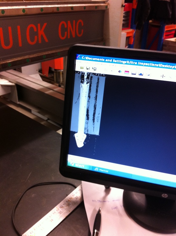

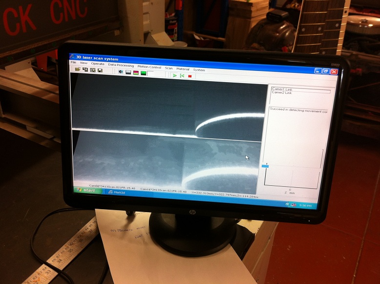

Quick scan
The laser scanner works, by firing a wide laser beam at the item and then the cameras mounted in each side measure the reflection and correlate that to a distance etc through a program
This creates what is called a point cloud, the item is then strip recorded and re-assembled "stitched" into a singular component as per photos
The first picture shows the two cameras individual views, then the assembled component and a view of being scanned
One issue is, that the items need to be sprayed in a non reflective paint, "which I dont do", so this means you get lots of stray lines dots point clouds

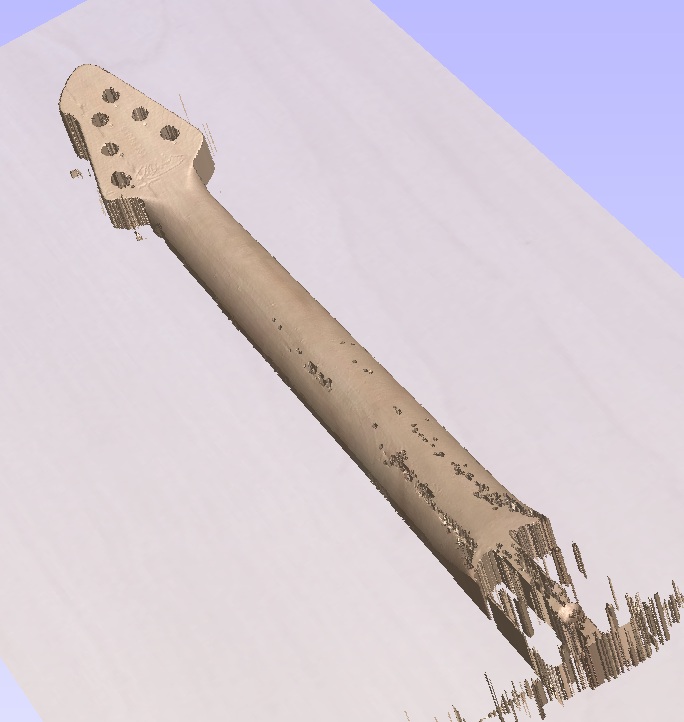

Post by simso » Sun Sep 21, 2014 7:41 pm
Not a bad idea, the laser is not pursay like a laser cutter, but more like a laser light as emitted by a laser leveller or power tools with laser guidance lights, I have a special spray its a dry chemical powder, but not cheap stuff, it just wipes off afterwards.
Because you really are redrawing the whole thing from scratch and just using the laser scan as a reference, its satisfactory

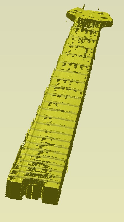

This is the laser scanned image brought into a rendering program
The sections with holes are where the laser did not reflect properly due to the surface finish, same with the stray lines about, they are where the laser scanner picked up a single or group od dots out in the air, from example stray lines from incorrect finish
laser 6.jpg (76.76 KiB) Viewed 15454 times

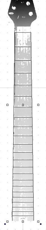

Post by simso » Sun Sep 21, 2014 7:47 pm
The top view drives the laser nuts, because the frets just bounce the light everywhere
laser top.jpg (71.82 KiB) Viewed 15452 times

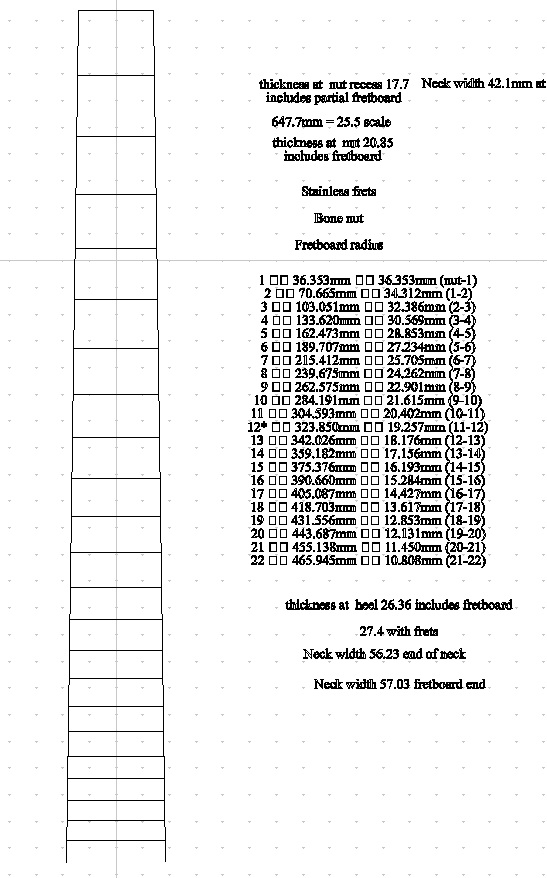

Post by simso » Sun Sep 21, 2014 7:53 pm
Now I use these scanned files for reference as they are 1:1 scale
I start with drawing the top using just the neck width at the nut and the rear fretboard width, and then I lay down the frets according to the correct scale length being used
I use physical measurements with a set of verniers to achieve this
Re: Laser scanning guitar parts
Post by simso » Sun Sep 21, 2014 7:56 pm
I then super impose the laser scanned image on top of my measured drawing

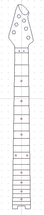

Post by simso » Sun Sep 21, 2014 8:00 pm
And trace with cad the outline of the head, rear cutout, the exact size and location of the fret markers, the same spot for the locking nut mounting holes and so forth and I end up with an exact copy of the laser scanned image, but instead of a 3d scanned image with lines every where I have a clean vectored file that any computer can utilise, and I can now edit that file / reshape it or modify according to the clients wishes
Total time to draw the top to scale is about 15 minutes, its not really that hard to do
But in this situation the customer wants the locking nut removed and replaced with a bone nut, so I need to shorten the neck on the final run,
Cad top 3.jpg (29.64 KiB) Viewed 15450 times

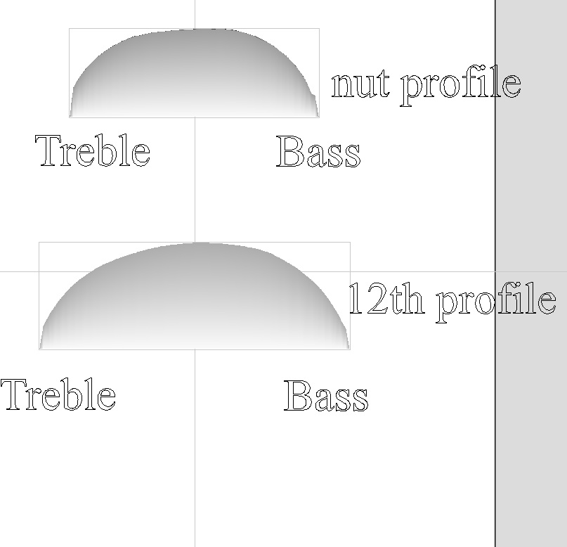

Post by simso » Sun Sep 21, 2014 8:04 pm
Now that I have a top profile shape, I can flip the drawing over in cad and use it for the rear shape.
I have to take some slices from the rear scan to get my back profile, I usually do a slice through the scanned image at the nut and 12th fret
You can see straight away the rear profile is assymetrical not symmetrical like I thought it was when holding
