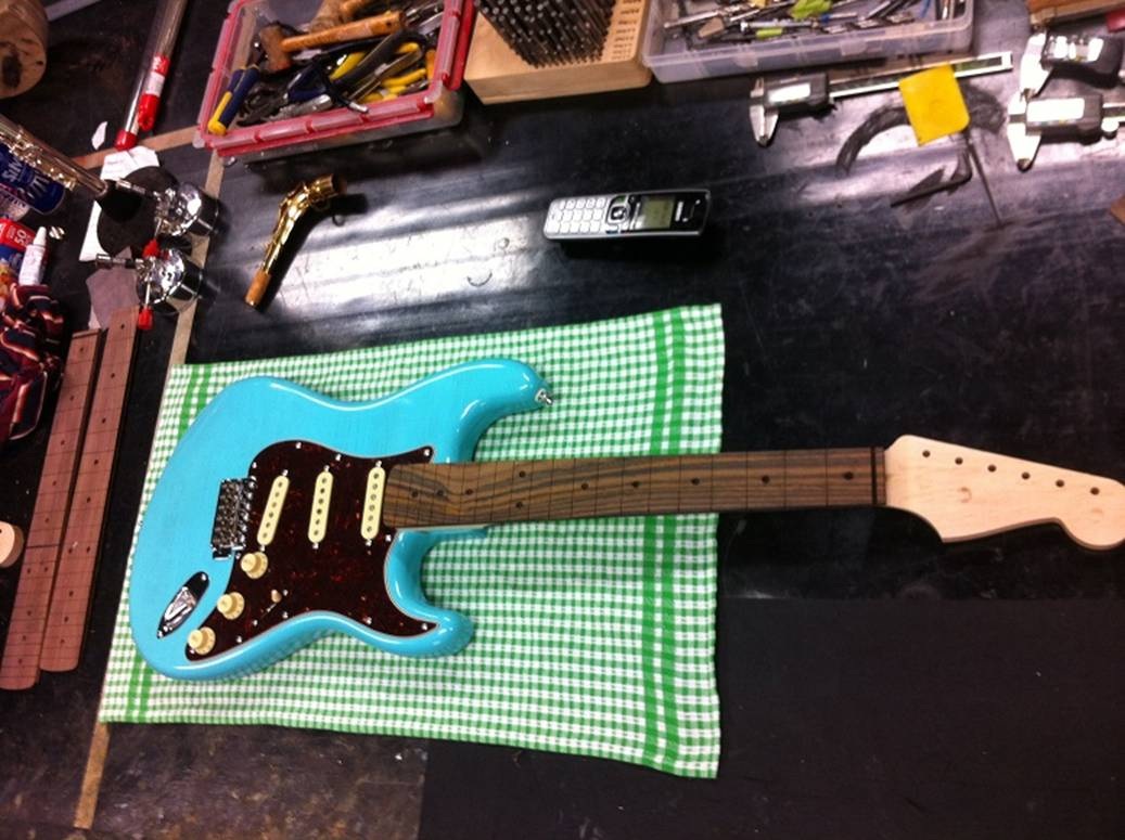

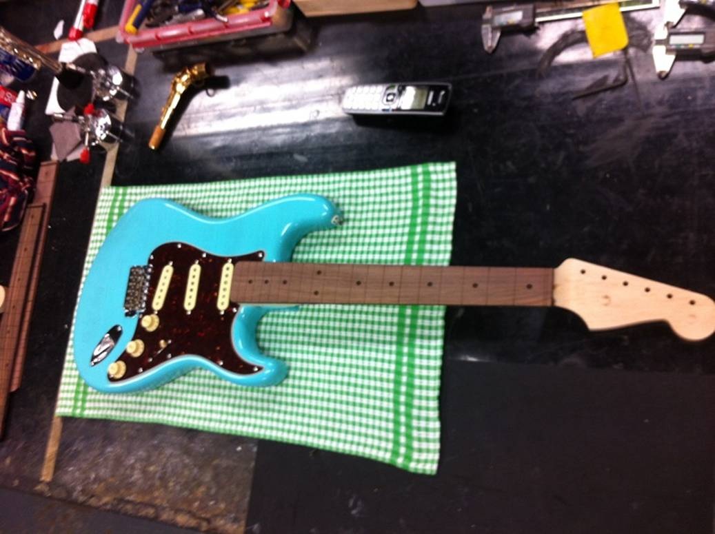

Had to make a conversion neck on a customers strat today - converts it from a 25.5 to a 24,
They asked for just a rosewood board, so I did two rosewood boards to show them the difference between wood examples
Rosewood and rosewood

As for your necks, I'd pick the second one.

When I make necks / fretboards /tops / backs for people's guitars , I'll usually grab out 10-15 raw blanks and just lay it on the guitar, orientate it up down left right, I know it sounds stupid but you let the wood speak to you, when you see the right piece for the right job, it just jumps out at you.
When you look at some custom guitars made by different people, the wood grain and orientation saids a lot about there eye for detail IMO
That fretboard I thought was a classic example, the grain is orientated so it flows in a downwards direction, very distinctive and mimics and extends the body contour forward so that way the eye flows down the full length of the guitar, the board was cut to place the vee in the grain right in at the heel

I always carry quite a few blanks of various species for this very reason, I'm just doing a Strat neck myself for a guy that wanted a 'rosewood' FB, wasn't until I showed him the stack I had that he realized it came in more than one generic shade or grain pattern that the mass produced axes seem to do so well.
