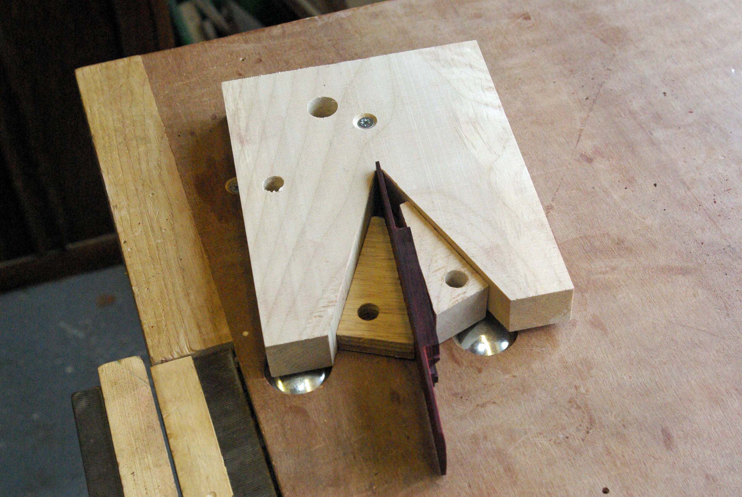

I think this is an interesting area for all woodworkers. The trick being to grip, often awkward shapes, with the minimum of time spent clamping and unclamping.
It is often useful to see what was used in the past when workshop equipment was simpler. Below is what I was using today to reduce the width of my rosewood bridge. It is a variation on a very old theme and works remarkably well. It is held by a dowel into a benchdog hole.
Dave M
Dave M

Thanks Dave. I like that and do find it is interesting to see these 'old' techniques, as you say.
A question about the holes in the small wedges - I presume they are just to hang on something, or do they have some other purpose?
Re: Piece holding techniques when hand planing
I would use that hole to grab the wedge to get it out again without risking to touch the clamped workpiece wit a screwdriver or so.vandenboom wrote:A question about the holes in the small wedges - I presume they are just to hang on something, or do they have some other purpose?

Yes I tend to string the wedges up to the birsdmouth I think it's called so that I can find them when needed, then hang the lot up out of the way.
