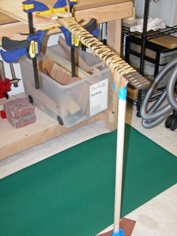

When I was was using Titebond for fret boards I had good luck shimming the neck and inducing about 1/8" of forward bow while gluing the fret board on. But admittedly it was hit and miss and did not always work.
Lastly I don't want to use the truss rod for anything other then adjustments in time and not as an off the bench remedy.
