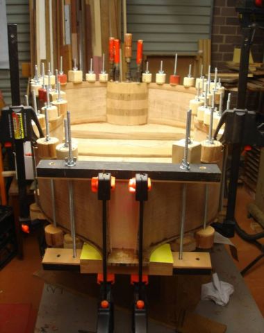

Post by matthew » Tue Oct 09, 2007 12:32 pm
Nicely figured Tassy oak ribs (from mitre 10!) bent with a combination of heat blanket and supersize bending iron to touch up the curves. They are about 2.8mm thick and 220 wide.
Above, I'm using the heat blanket when clamping to the neck blocks; spritz the outside of the rib with water, slop on the hot hide glue, clamp in position, give the heat blanket a burst and tighten the wingnuts till the ooze squeezes out all round.

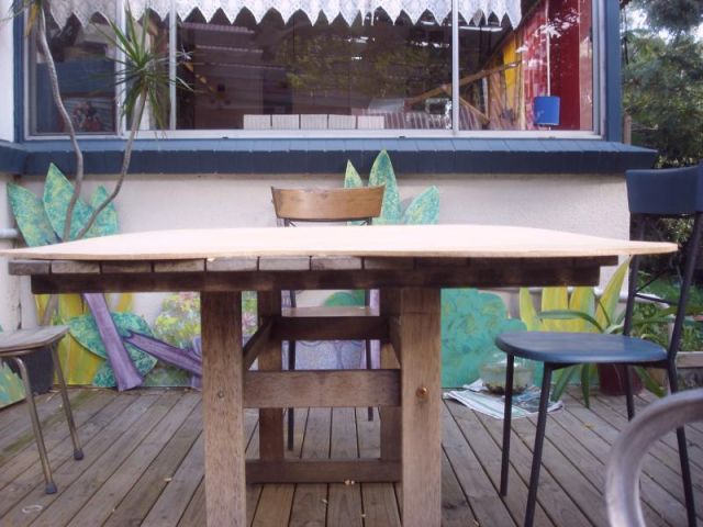

Post by matthew » Fri Oct 12, 2007 12:19 am
I tend to eschew power tools because I don't like the noise or the dust.
But this means I need some big gouges and a solid worktable ...
The small gouge is a pfeil 30mm #9 on a converted table-leg.
The big mother is just that.

Post by matthew » Fri Oct 26, 2007 11:18 pm
This last pic is a bit ugly but it shows how much wood has to come off.

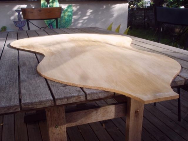

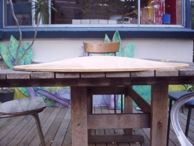

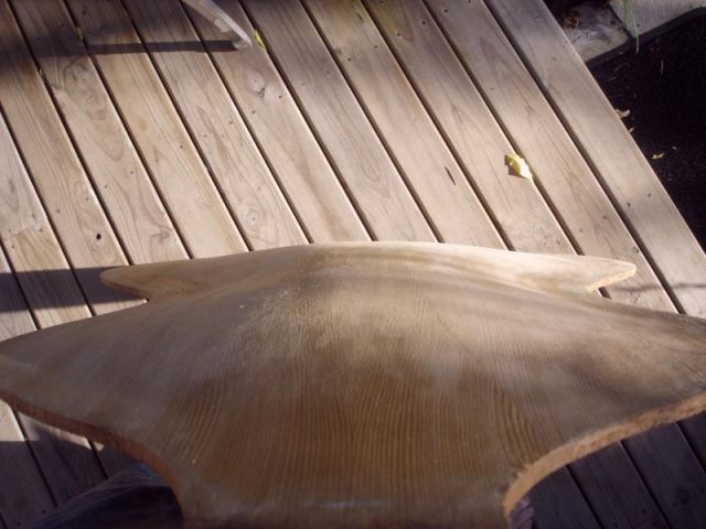

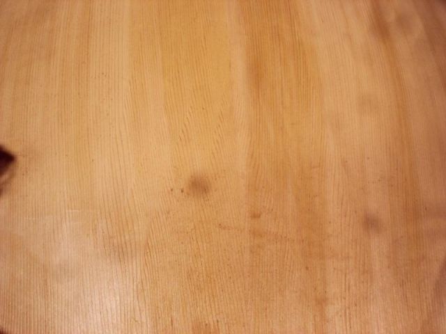

Post by matthew » Tue Mar 18, 2008 8:45 am
Top arching progress
Not the "bearclaw" effect on the last pic. pity it will be hidden by the fingerboard!

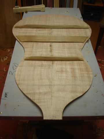

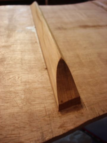

Post by matthew » Tue Mar 18, 2008 8:52 am
Bracing style for your critique ;)
the back is now glued on. I think I'll have to thin it a bit towards the edges more cos its quite heavy and stiff. plenty of meat to work with.

Post by Kim » Tue Mar 18, 2008 11:16 pm
Very nice Mathew, outstanding work in fact. I would imagine that sanding the top down on one of these beauties could get quite erotic no? :D
matthew
Posts: 1193
Location: Sydney, Inner West
Post by matthew » Tue Mar 18, 2008 11:59 pm
Well Kim ...
The best way to find out if there are irregularities in the arching is to run your hand over the plate. I do this, eyes closed, for several minues at a time, and where I feel a bump or ridge I mark with chalk to hit with the scraper later.
It is a very pleasant process. This is a life-size instrument, more or less!
Its interesting that the fingertips will tell you what the eye won't. Something about what makes a curve beautiful is the rate of change of the curve. Just as braking a car to a stop smoothly is something we sense, not calculate (even rate of change of decceleration), the rate of change of a curve can be felt better than seen. (I am not the author of this analogy, though I would love to take credit for it ...)
