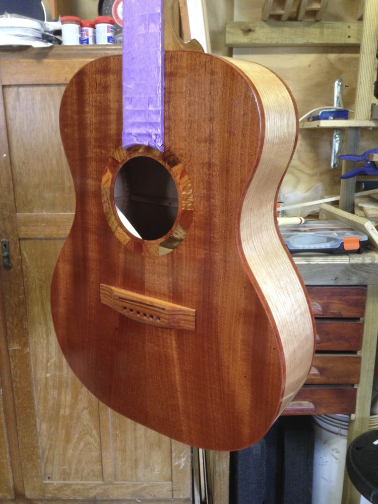

Hi Colby,
I have made several guitars from reclaimed wood. The trick for finding something appropriate for back and sides is making sure it is wide enough and preferably quarter sawn. Fortunately, most hardwoods that were used in furniture etc were quartered.
I probably have some Tassie Oak left over that was reclaimed from a desk that was thrown out on the side of the road in Lindfield, Sydney. I used it for a small body steel string that I am very happy with.
I can have a look in my shed to see if there's enough left for another build. Maybe not a dreadnought shape but probably enough for a small body shape.
The pic below shows the sides and the top while finishing.
