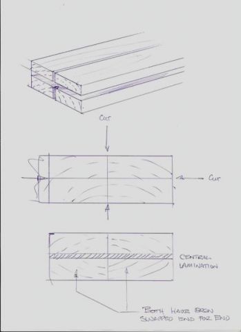

I have aquired a piece of naturally dried Queensland Maple.
I would like to ask the forum members if they could give me some advice to weather the piece could be useful for guitar building. It is crack free, 600mm long, 55mm thick. I have marked out 200mm on the end. My idea is i may be able to get two neck blanks from the slab.
Good question Alan!
I recently ordered and recieved half a cubic metre of Qld maple which was cut in slab form to enable me to resaw for guitar necks. Some of the outer slabs were very similar to what you have posted. So my advice would be to resaw the pieces into four and swap two of the pieces end for end and then add a lamination. This is probably a better option than trying to follow the quarter face too closely and wasting a lot of wood.
Please note that the drawing below is for two necks

I like Tim's suggestion. The piece is not wide enough for a one piece neck blank. I read somewhere you have to be careful what woods you laminate together in case one type of wood shrinks. What type of wood should i use Tim for the centre laminate?
TimS
ANZLF Approved Supplier
Posts: 210
Post by TimS » Fri May 09, 2008 8:50 pm
The centre laminate is really an aesthetic issue. I would personally use something that is the same or similar to the back and sides. Possibly also incorporating purfling strips that are in harmony with the bound edges of the body.

Well I the re-sawed the Queensland Maple as per Tim's adivce. Many thanks Tim.
I think this wood will make good necks. The smaller blanks are for two concert uke spanish heel necks and the others for two 000's built to the stew mac plan. I have some Sapelly Mahogany to laminate between the two halves.

Those look great and I do like Queensland Maple a lot.
If I might make a suggestion to re-orient the lams in the two taller blanks by switching the two pieces around. As they are, if any movement occurs while acclimating they will cup towards the bark side of the log. As they are they'll pull or cup away from each other if that happens. Oriented the other way they push against each other. I don't think it matters either way for the other two smaller sets.
Posts: 1553
Post by ozziebluesman » Sun May 18, 2008 4:12 pm
Thanks Larry.
That suggestion makes good sense and i will laminate the wood that way.
