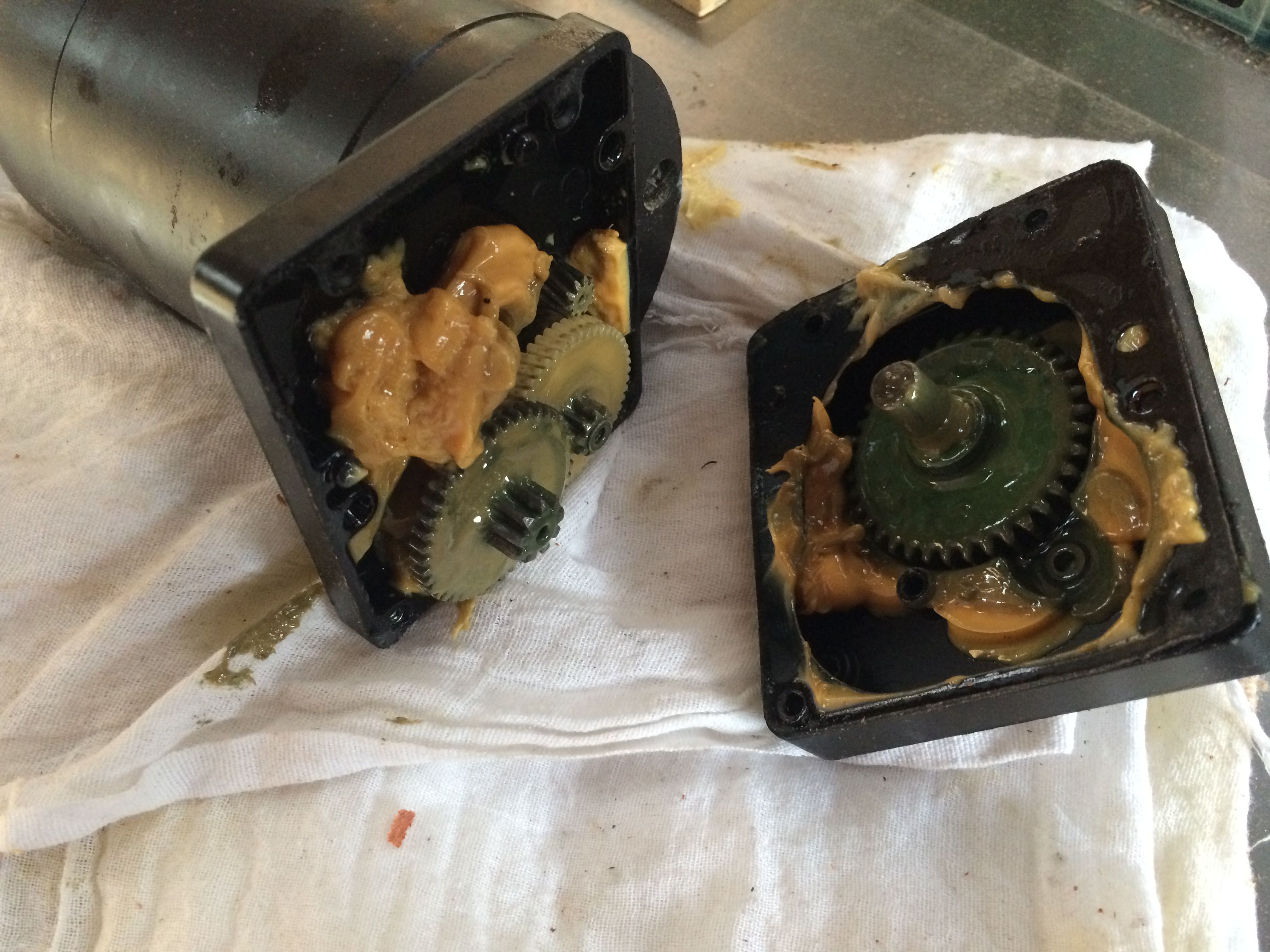

Cracked open the gear box and found this.....I think this sh*t is supposed to lubricate the gears??? Either that or someone dropped their peanut butter sandwich in the gearbox.

Looks like the shit Ive been hacking out of my lungs...

sebastiaan56 wrote:Looks like the shit Ive been hacking out of my lungs...
Lung Butter :shock:
