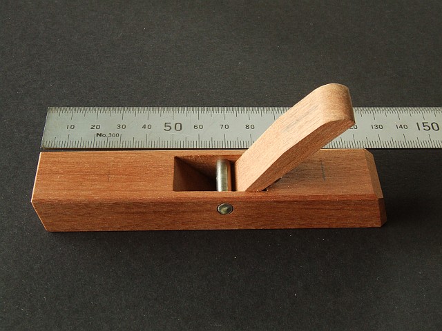

And just for completeness, here's a little plane I made specifically for leveling purfling (45 degree bed).
