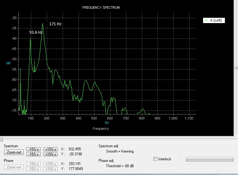

The following is the final Spectrum Analysis with the bridge, saddle and pins. My target was 95 for the Air and 170 for the top. So I am close. I am not right in the middle of two notes but I am not on one either so I am leaving it. I am not sure my target was correct as it is making the D28 more like a finger style guitar. But it does sound good overall.
Of note I noticed nearly a 2 Hz drop in top frequency from no pins to having the pins. Just shows how sensitive the top is to weight.

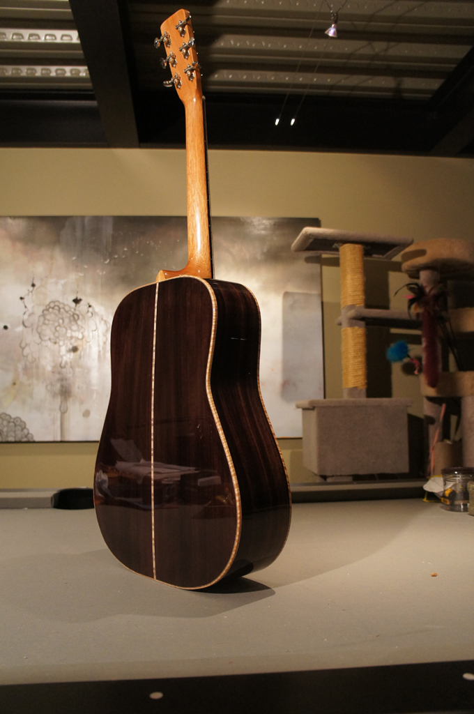

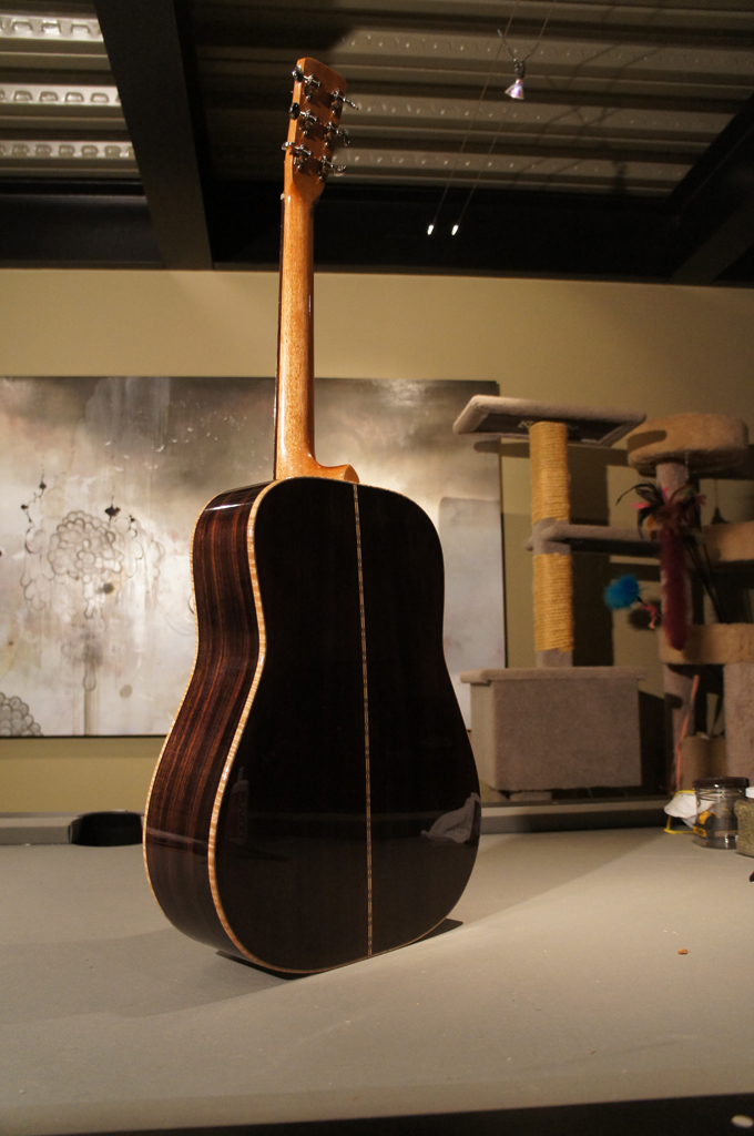

Very nice John, just don't lean it against the cat pole. Well done. Wayne

Nice gat John.
That cat scratching pole has to go mate. Ya dont want ya cat curling up for a nap on top of a guitar fresh out of the spraying booth.
