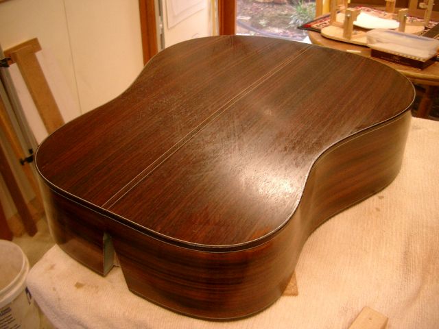

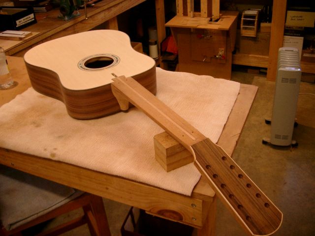

Post by kiwigeo » Thu May 08, 2008 4:41 pm
Some pics of the instrument in question. First pic of the body and neck ready to go. Second pic of the body with one coat of neat Z-poxy finishing resin applied.
