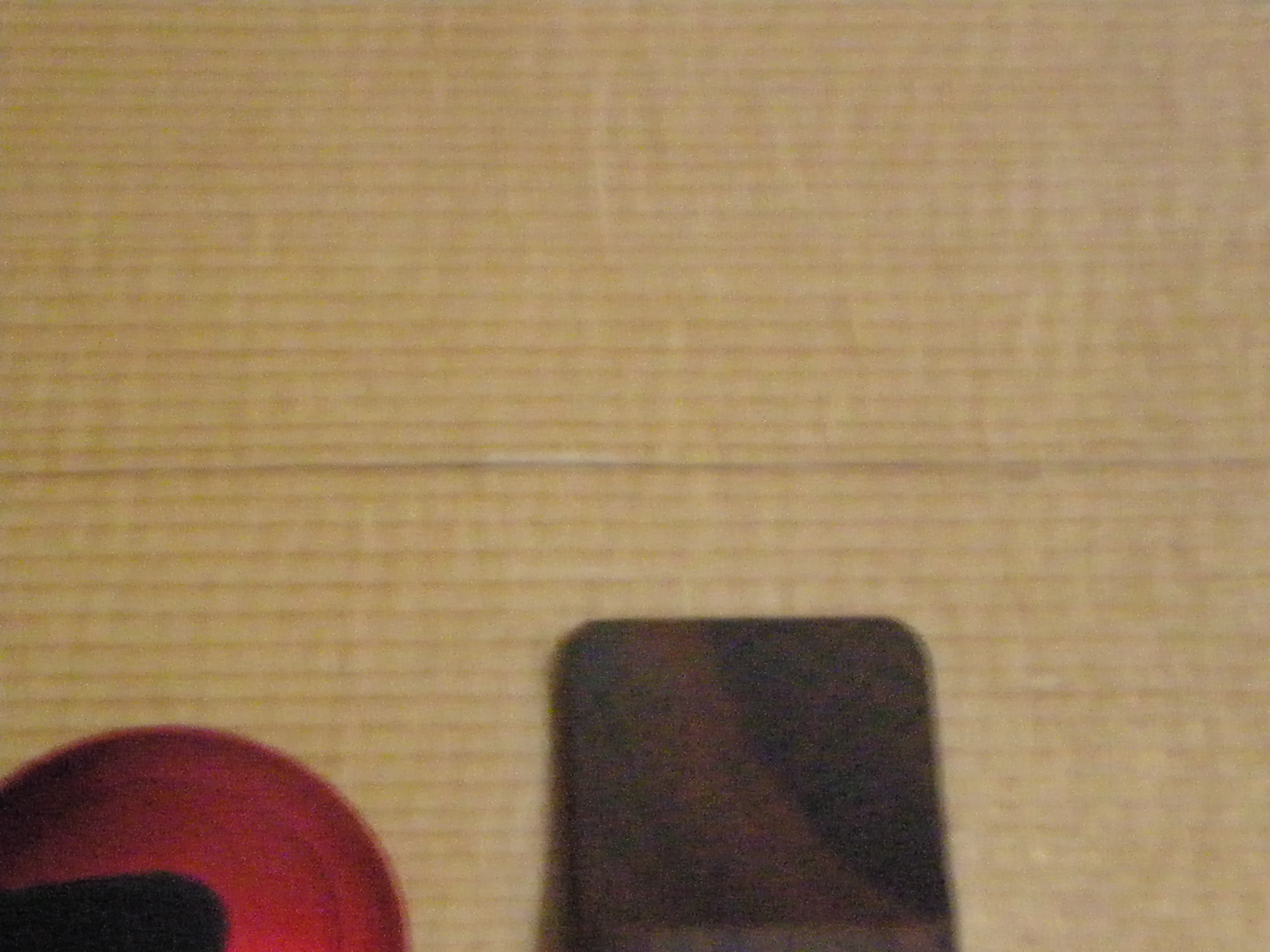

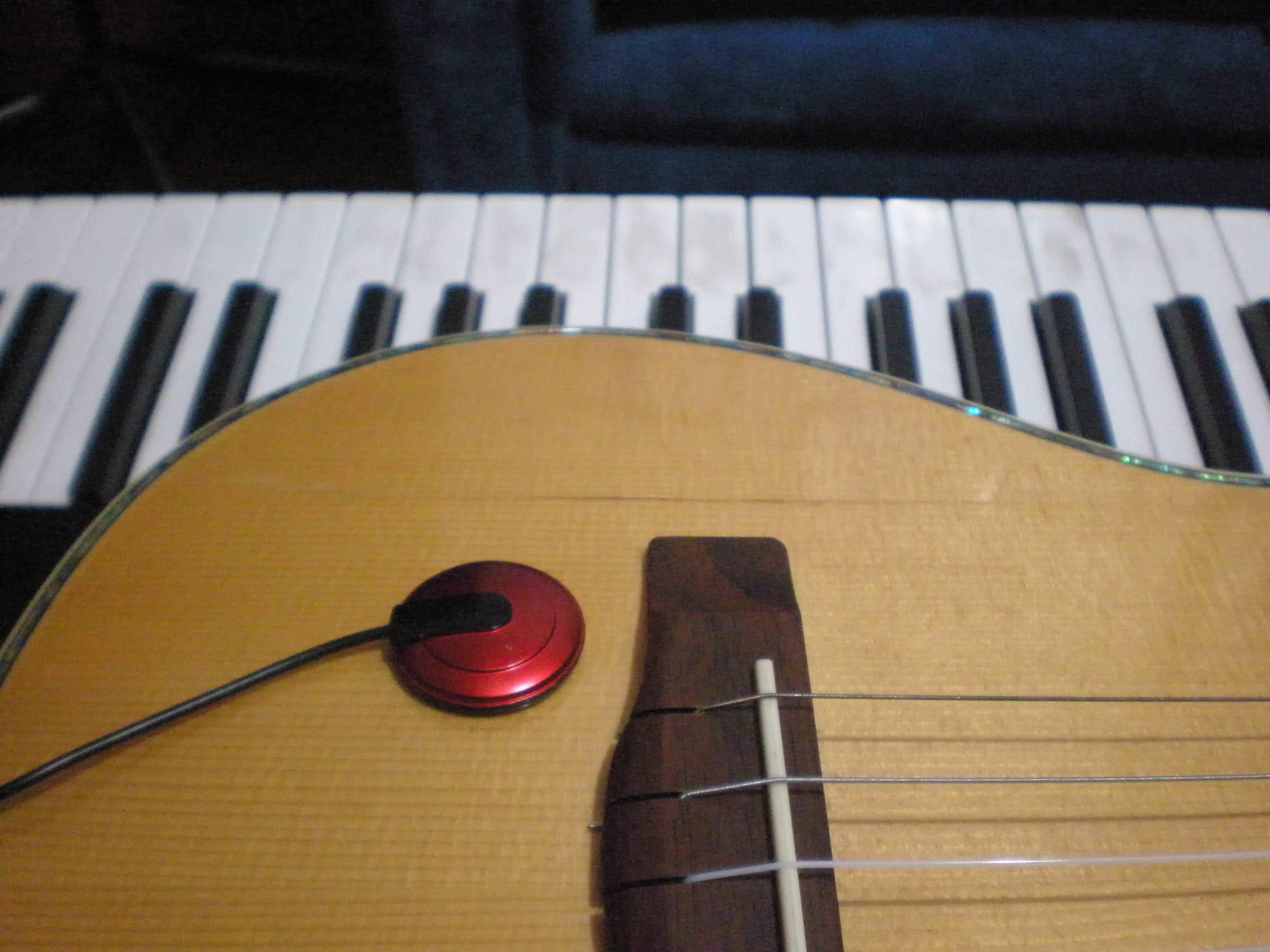

I have a Greg Bennet Samick Baritone ukulele. it has a crack in the sound board. i originally thought it was a crack in the finish but over time it has gotten longer and i noticed now the the top part the sound board is now above the bottom part so i know its not just cracking. if i had only thought to take it in sooner it may have been an easy fix.
Here are several picks of the crack. its the black line you can see on the sound board.
I did buy this to use as a cheep knock around guitar and it was not terribly expensive but to be able to fix this would be great. would it be possible for me to fix or should i leave it to a professional. This ukulele only cost me $150 NZD. (roughly $125 USD) so if i was to take it in would it be worth fixing.

Simple repair.
As mentioned, you will need to put a couple of cleats in from behind, just make sure you orientate the grain direction correctly for strength
As far as the tops concerned, its a grain line crack, so it will come together nicely, dependant on how dirty it is and what glue you use will in turn determine the end result being visible / invisible / or just plain yuck

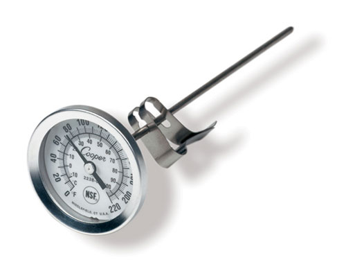

I use a meat thermometer.....but anything that you can sit in the container of glue and will read up to at least 80degC will do. This thermometer won't do the job....mickeyj4j wrote:
nice a baby bottle warmer and a plastic container to put the glue in. ok and what type of thermometer would be best for this situation.
Re: ukulele - Crack in Sound Board
I use a milk frothing thermometer from the $2 Shop. Costs a bit more than $2 tho' - maybe about $10

Don't know where you're located, so I'm presuming it might be a humidity related crack, being that it's either summer and very hot and dry in many parts of Australia, or very cold and dry in parts of the world with snow and central heating.
Same sort of repair in either case. The instrument would need to be brought into a bit more humid environment. Hot hide glue is still the best option for the crack. Some repair cleats placed over the crack on the inside of the soundboard reinforcing the crack.
Afterwards, keep the instrument in a more stable environment. Not allowing it to dry out too much.
