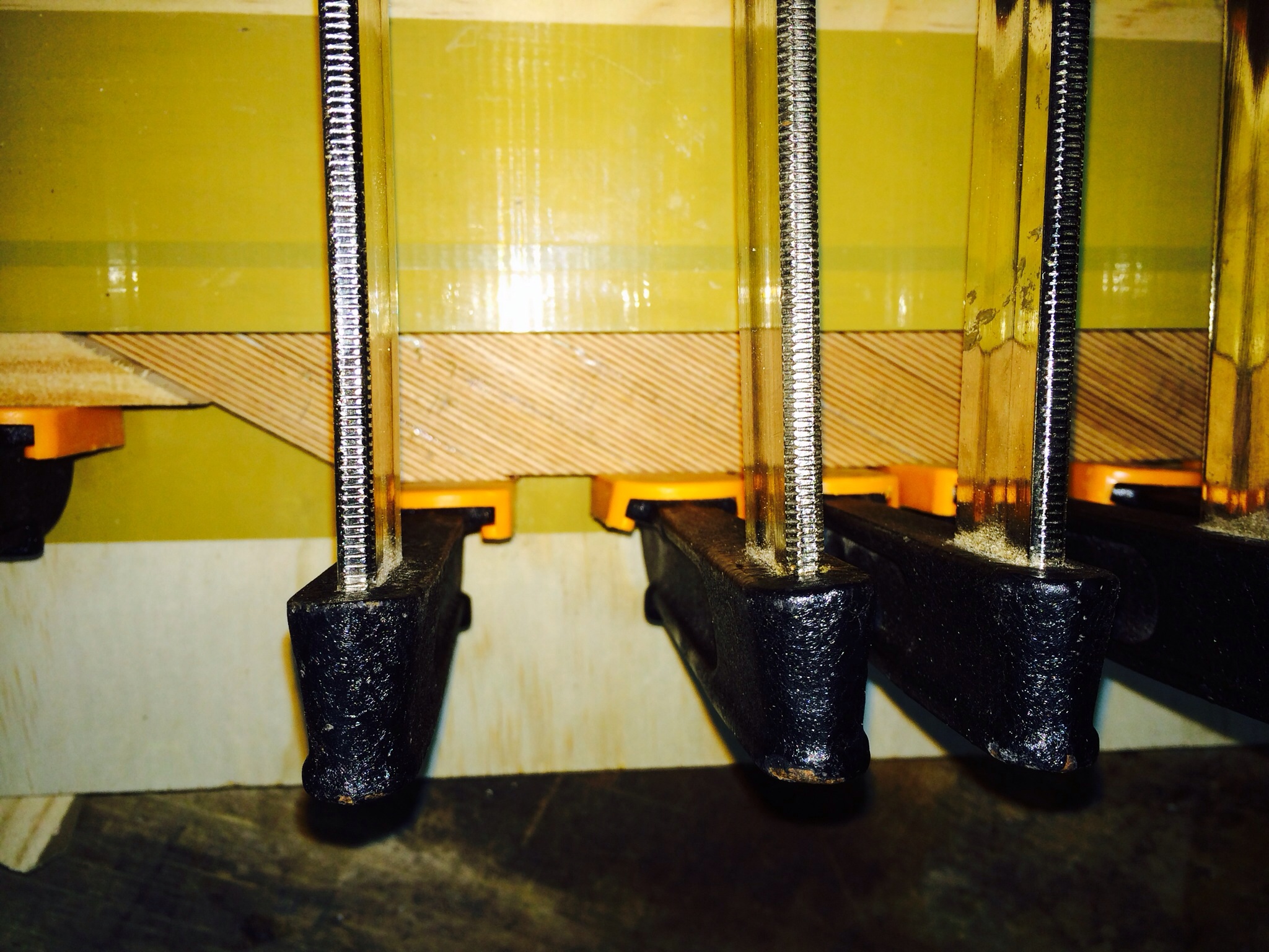

Hey dudes,
I've been dreading this part of my latest build: a first attempt at making my own herringbone and wheat patterns for a custom rosette.
What I learned tonight while gluing up a dozen 30deg parallelograms of veneer, was that it's vital to add clamps and tighten them in the direction of the wedges. Made sense when I accidentally stumbled upon this fact *half way* through the gluing process :)
Next step is to square everything up, and then cut into several 3mm strips.

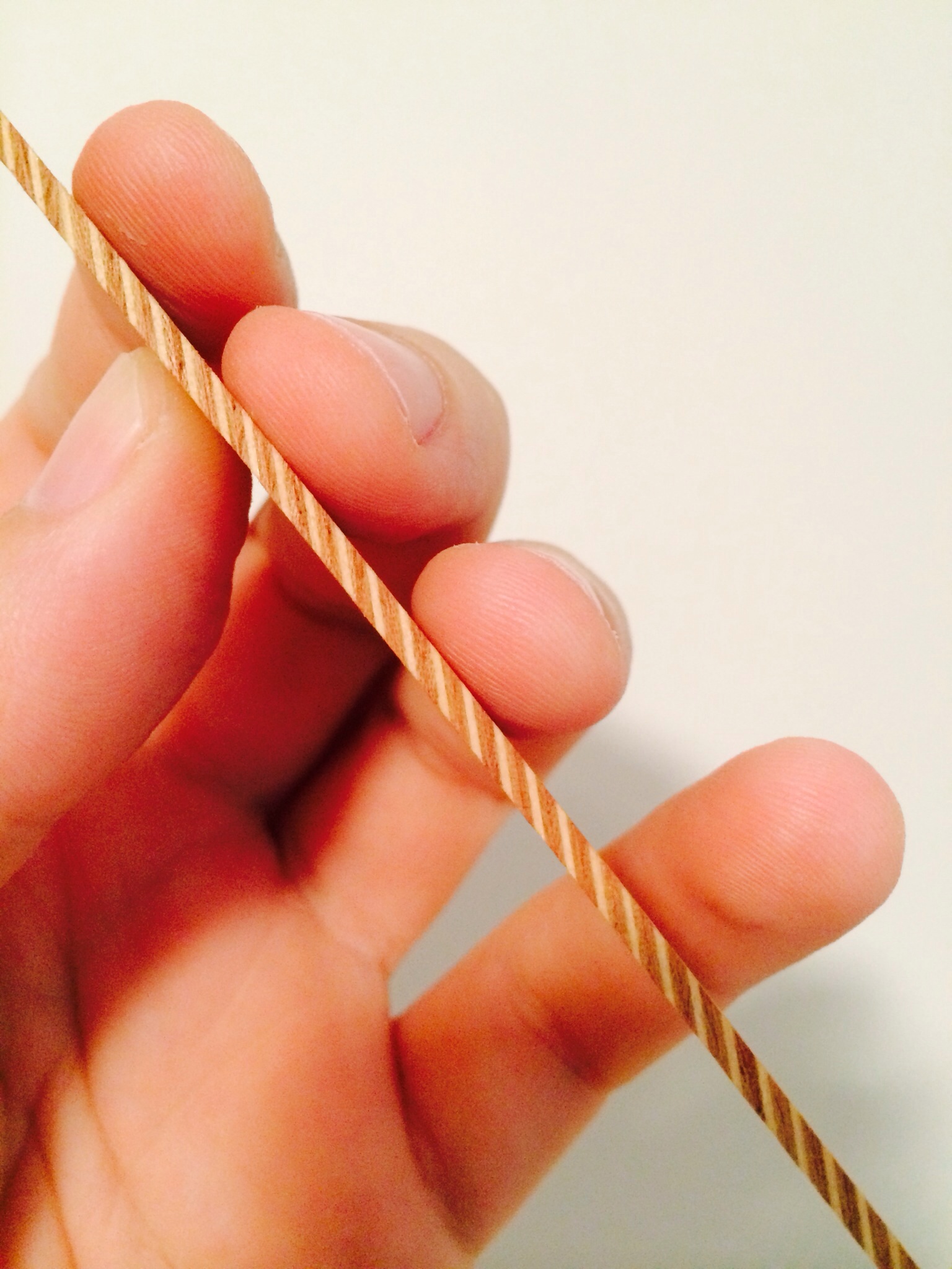

Wayde Christie
Re: First attempt at making herringbone and wheat for rosett
Post by Wayde Christie » Mon Feb 03, 2014 10:35 pm
kiwigeo wrote:Kudos to you Wayde for taking on what is a pain in the arse job. Me.....I buy my rosettes ready made and just bung 'em in....if I did my own finishing an instrument would take 2 years instead of 1.
:) I'm hearing you!
It's going well so far - here's the completed stack.

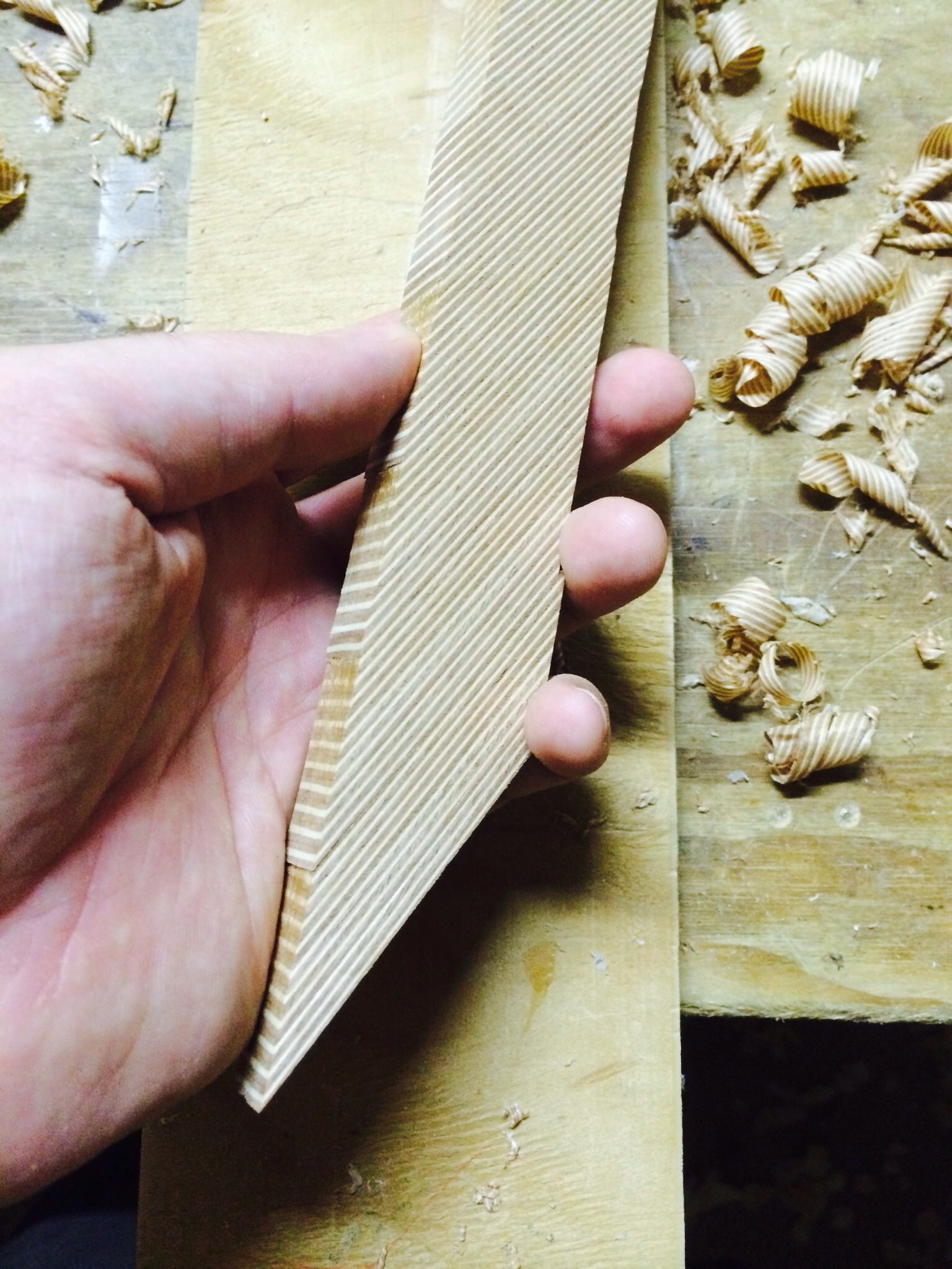

Wayde Christie
Post by Wayde Christie » Wed Feb 05, 2014 8:59 am
First cut through the stack. Will add a couple of veneers before thick seeing with a hand plane.
