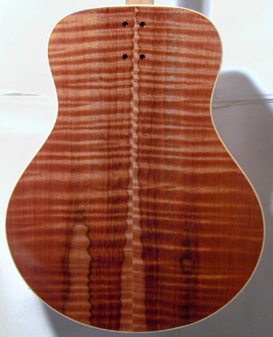

The second might be Kwila, which is related (I think) to Australian red cedar, but I had a plank a couple of years ago with a similar flame to that. Smells a bit like a combination of AustRC and Mortein.
Even if you can't use them for instrument, it is always good to have a few planks of good, old timber about the house. There will always be a useful project to use them on one day 8)
Here is the back of a Kwila guitar bodied bouzouki I made

Hey what are the screw holes in the back of the bouzouki for?

Post by graham mcdonald » Thu May 01, 2008 4:31 pm
They're not screw holes. Access holes for machine bolts that hold the neck on in a hollow neck block. The neck is made like a strat, with no heel, with threaded inserts which take the machine bolts. A long allen key tightens up the bolts through the holes, which are lined with short lengths of carbonfiber arrow shafts, which are just there to give neat finish to the holes.
