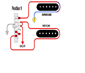

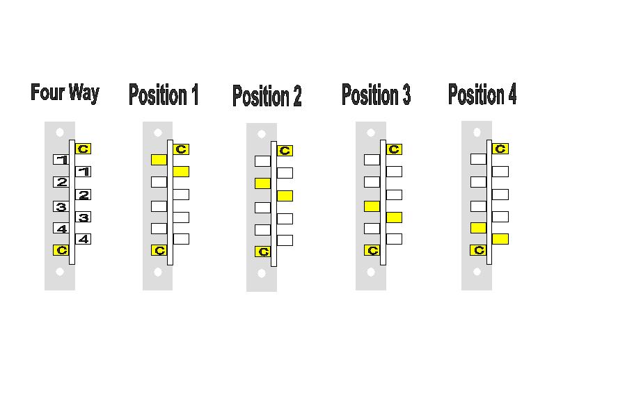

Hi, Nick.
I have found it a help to have a visual aid to help get my easily distracted brain around switches.
Most likely is a short where you disconnected and reconnected the neck cover ground. other than that I'd look for a blob between switch lugs.
Just print this and draw your wiring over the positions that aren't working and it will become apparent if the jumpers are incorrectly placed. Hope this helps.

Post by jeffhigh » Mon Jan 27, 2014 8:39 am
Great animation Dekka!!
The neck pickup is switched on the ground rather than the hot, that's the key.

I wish I was that clever. No. I drew the positions diagram but not the animation. I found that years ago on the net when I made my 4way Tele.

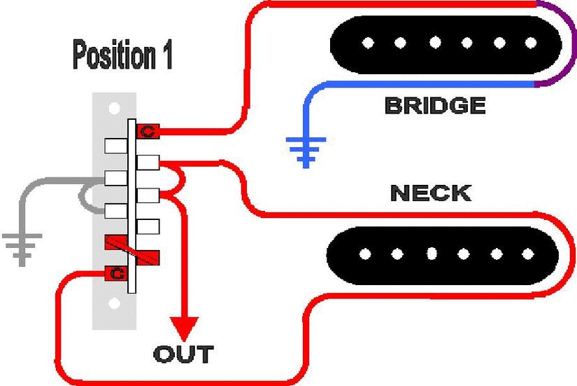

So this evening I taught myself how to animate the switch position diagram. It's not so hard after all.

Dekka
Posts: 175
Re: Wiring help.
Post by Dekka » Tue Jan 28, 2014 5:41 pm
This one shows how the MAGIC MUSIC SMOKE travels through the Series selection to produce uber-tone at the other end. :D
