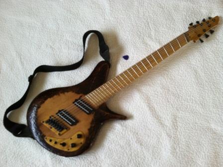

I was commissioned to do an article on "how to build a guitar" by Australian Wood Review, some years ago. The design scope of it was somewhat negotiable so I opted to make and write about something a little different to those you find in the most common building books.
I made the project a 7 string Multiscale (fanned fret) Solid Body guitar. It ran over three consecutive editions of their publication, though I can't recall which edition numbers they were! :roll: Anyway, you could always look up back issues or check your library if interested in the 'how to'.
Otherwise, I thought you might be interested in these old threads - the first being a simple jig I came up with to cut fanned frets; the second being the resulting guitar.
viewtopic.php?f=24&t=2094
viewtopic.php?f=25&t=2394
Multiscale instruments are more fiddly/time consuming to slot the fretboards for, given you can't use regular jigs; unless of course you have access to a CNC. There are also other considerations such as the lack of bridge options available and to a lesser extent, the pickups - all this relating to electric builds here; not such an issue on acoustics, just very careful designing. The bridge base on mine I custom designed as an extension of the 'fanning', then had machined from brass and black chrome plated. The pickups likewise were custom designed, then machined and hand wound.
Many musicians find them comfortable to play with only a short adjustment period to the change. The fanning does somewhat follow your hands natural tendency to curve up and down the neck. However, this depends on the amount/extremity of the scale variation and is, of course, a personal preference after all.
Pete's notes above on how to draw up the fanned frets are helpful. There was an online fret position plotter that included options for multiscale instruments, but I can't recall which one it was. If I find it again, I'll post a link. Only other advice would be to not go too extreme on your variation in scale length and choose your 'straight' fret wisely - where you place this will dictate the type of angle you'll get at the nut and bridge.

Graham Long
Posts: 140
Re: Fan Frets
Post by Graham Long » Sat Feb 01, 2014 6:57 am
Hi Jeremy,
Thanks for the reply, Great Stuff, Just what i've been looking for.
Your cutting jig looks great, very professional and the seven string guitar - wow just stunning.
I have started drawing up the fret arrangement and will follow your advice on the scale length variation and positioning of the straight fret.

Hmm, I'm in the process of building a 5-string fretless for a friend with a 34"-35" multi-scale, perpendicular fret at the 12th. That's not a whole lot of difference - not much angle in any playing position - and hoped that it wouldn't be a problem for fingering. I talked with Harry Fleishman, who has built a few fretless multi-scale basses with varying differences in scales, and he said that folks can adapt.
In terms of general playability of multi-scale guitars, I built a 7-string electric, with a 25.5"-27" scale splay, perpendicular fret at the 7th, low A on the 7th string. If anything, in the first minutes of playing it, it wasn't the frets that threw me off, but that 7th string!
